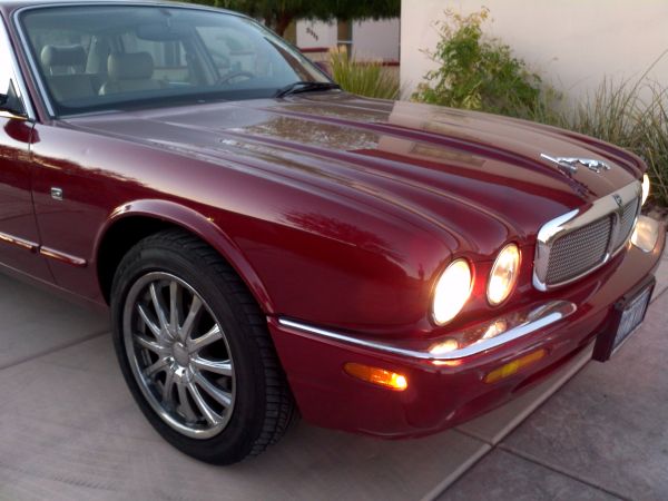

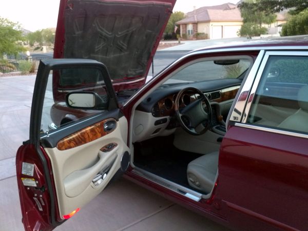

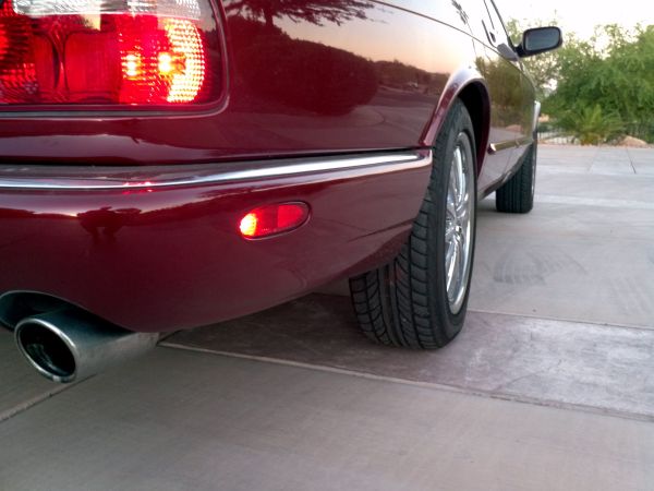

Here are some pics of the XJR.
Sorry I couldn't find a pic of the dent but you can barely see it in this pic. It's right on bottom of passenger door, it's the small whitish spot right before the front tire in the pic.

Also, the front grille is chrome and is bothering me. Didn't all the XJRs come with color matched grille? Is this a sign of body damage to the front?

People upgrade the grilles all the time. I recently bought the same car, 2001 model, and same color (love the color!) and discovered after I bought it about the knocking on start up.

I am considering updating my grille to mesh OR going with a Vanden Plas fluted grille (lots of chrome).

The wheels and chrome grill are add-ons. I'd look for oem original wheels for cheap money, doesn't matter what condition as long as they're round and true, you can get them powder coated for $30 per wheel. The grill can be painted body colour, don't recall the paint code but the colour is carnival red.
