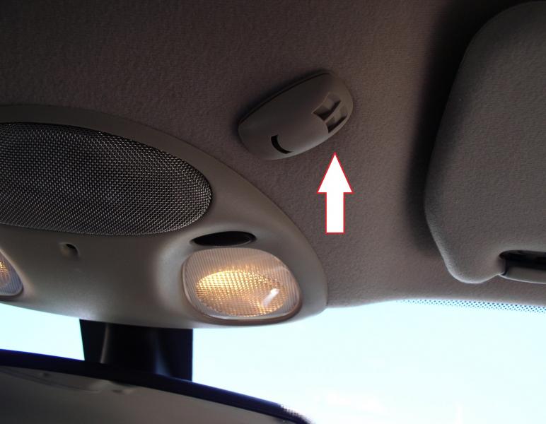

This is the OE Jaguar Microphone in my XK8 but a very similar Microphone was fitted to my XJ8L:
Confusingly, I have seen X308's with Microphones fitted which don't have the telephone system installed.

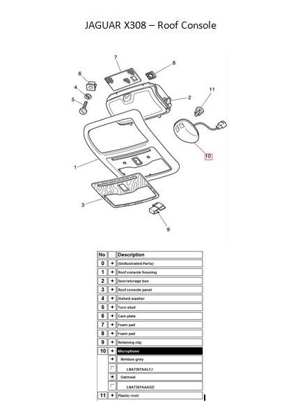

Here's the part numbers (item 10):
