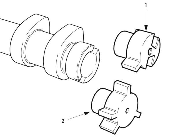

Also just in regards to Option B (camshaft swap); this post mentions differences in the VVT systems that makes me think it's not as simple as just swapping the camshaft or CPS trigger from part '2' to part '1' (pictured below).
The solenoid used on the VVT enters from a different point on the AJ26. It came in on the front of the cylinder head. The AJ27 moved it to the cam cover. A blanking plug was installed for AJ27s, but I don't know if you can field install one in an AJ26. The VVT units and carriers are upgraded in the AJ27
However if anyone believes this option may be possible I'd be interesting in knowing, as it would be a lot less effort than swapping the heads!

thanks for your reply sparkenzap and yes, it is a 3.2 but I was under the impression the only one without VVT was the supercharged 4L. If the cam on the 3.2 is indeed fixed it would be a good thing, as that's one less element of complexity in the whole situation.
I'll await feedback on the idea of just swapping out the end part of the camshaft so it's compatible with the AJ26 CPS/ECU. I'm sure there are things I'm not thinking of but I still need to chase the simplest option!

I would just use your AJ26 cams on the AJ27 heads.
Don't forget to plug the oil feed on the AJ27 head for the VVT unit!

So, that makes this entire thread subject to re-thinking. I would say you have to deal with the camshaft pulse cam, both in tooth count and orientation, and you need to refit the original flex plate with its different tooth count, then re-use the AJ26 intake system. I am not sure which intake parts bolt up, but I do know, at least on the 4.0, that the injectors and induction are different.
