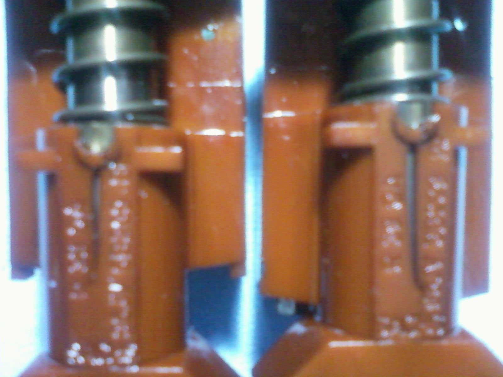

Check up completed scan gave out the following codes PO305 and PO355 which was #5 ignition coil and coil circuit now replaced with part # LNE 1510AB. i also elected at this time to check the tensioners both showed cracks, and are now replaced part # C2A 1511 and C2A 1512 Back on the road out the door $1177 US including tax parts about $565 for parts. Now for a set of tires. That's all for now folks.
80,000 miles the engine internals spotless
you can see the cracks 80,000 miles
