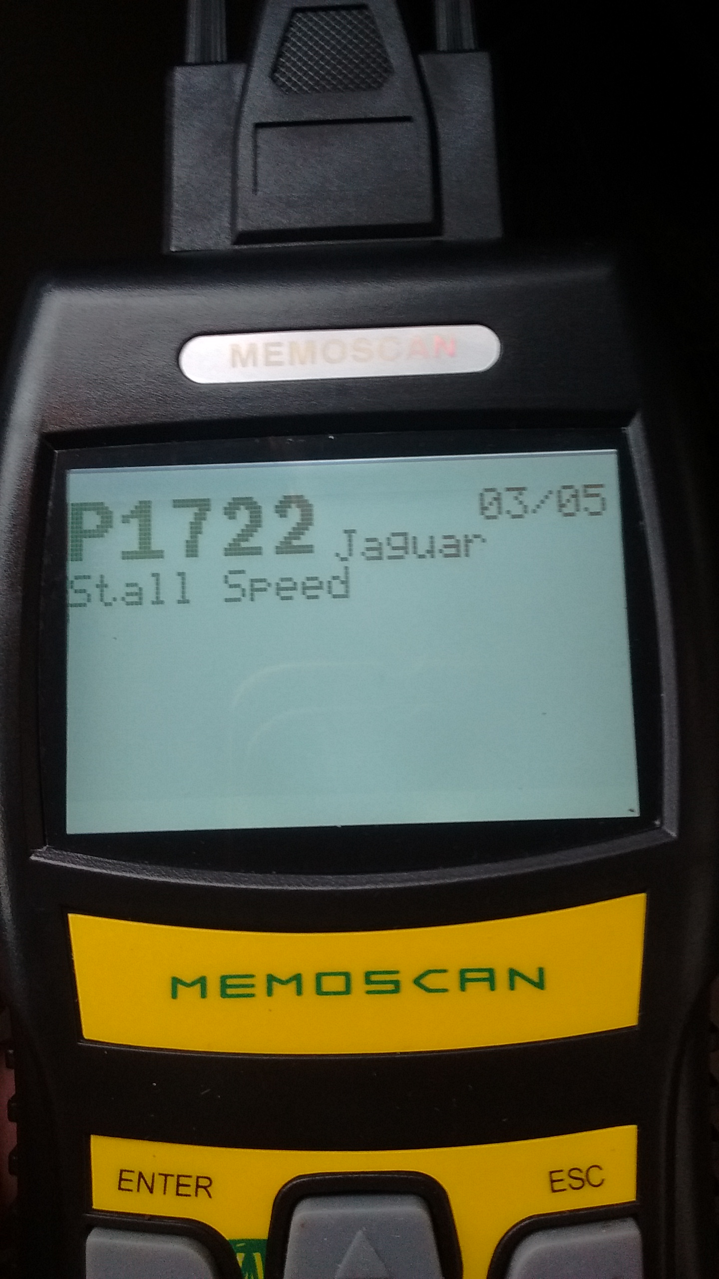

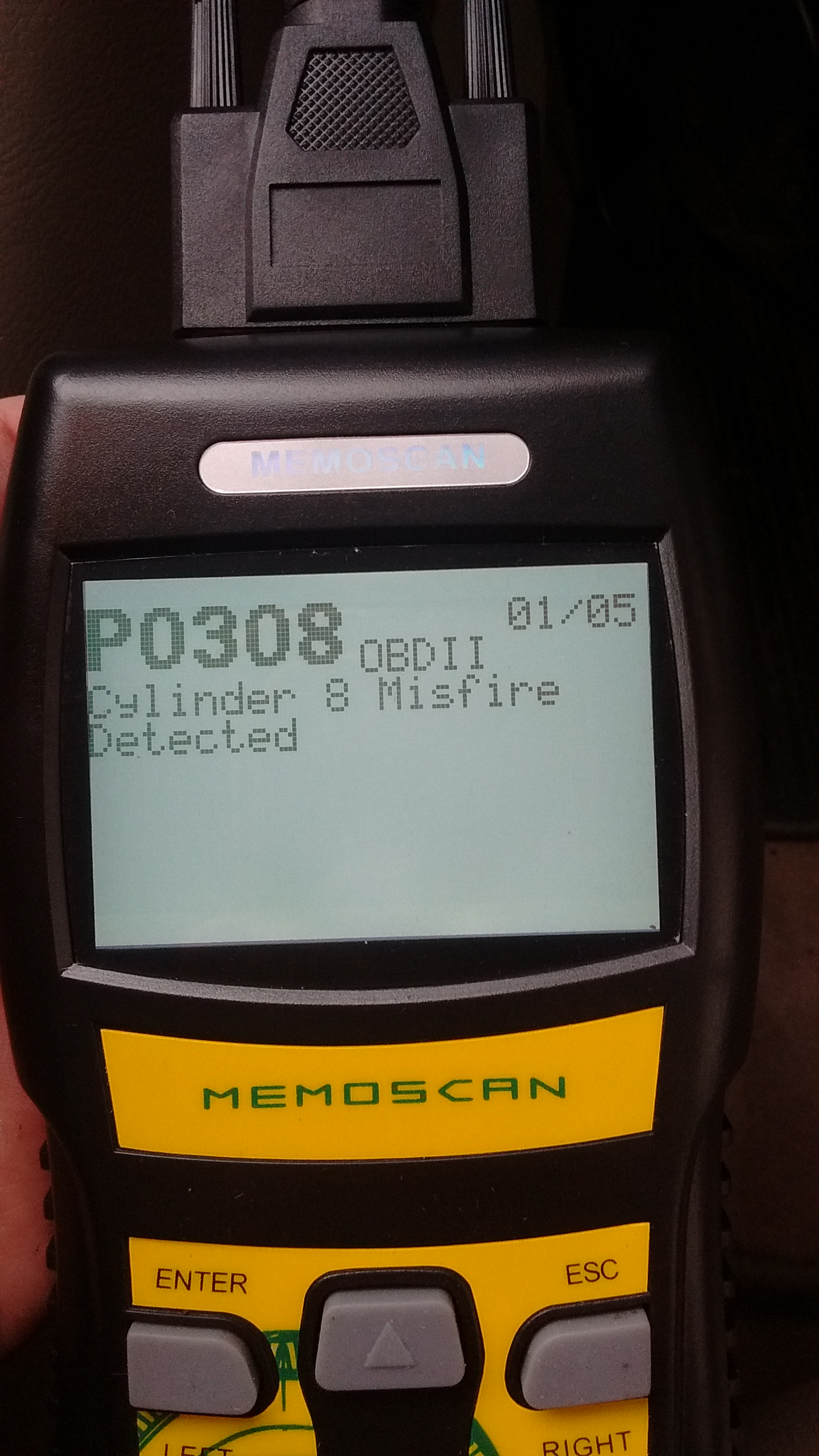

Hi Sean pipes are correct way round going to header tank...fuel pump replaced a couple of years ago ... Codes are attached and tiny bubbles are being produced in the header tank I notice.... So what do you think???

Hi Sean I have coded attached and pipes are correct going into header tank I notice little bubbles in the header tank and fuel pump replaced 2 year ago... what do you think?? Thanks for the advice gratefully received

Sure looks like head gasket. Note to mechanic: adding gasket seal can plug the heater core because it's low flow. There is a test kit to check exhaust gas in the coolant, surprised your mechanic isn't aware. Maybe you need a new mechanic.
