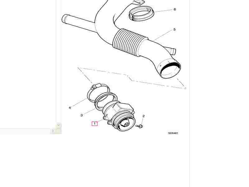

Old Jun 11, 2013 | 10:55 PM
  #38
sparkenzap's Avatar
Joined: Nov 2007
Posts: 4,502
Likes: 1,068
From: atlanta ga
Look at Item 1 in the picture. Specifically, you are cleaning a little wire down in the plastic piece that protrudes into the center of the airflow, behind the hole with the X shape there in the center of the airflow venturi. Use a can of MAF spray available from the auto parts, read the instructions and DO NOT FORCE THE CLEANER TUBE INTO THE HOLE. The sense element is very fragile. JUst spray plenty of cleaner in there, from both directions. I do not recall exactly how the X-308 MAF element looks, but what you are cleaning are two thin lire looking things thet cross the airflow. You may or may not actually see them looking into that hole. Don't let the cleaner tube touch those elements, just wash the crud off with the spray
Old Jun 12, 2013 | 08:12 AM
  #39
xjay8's Avatar
Joined: Mar 2011
Posts: 1,175
Likes: 258
From: Tasmania, Australia
I might also add to Ross's comments ;o]
While you have the MAF in your hot hairy mit....have a look down inside the induction side...to right of centre what looks like a little plastic tit (steady boys)...this is the mean air temp. sensor and should also be cleaned by spraying.
When finished just give it a good shake and let it air dry....NEVER use compressed air on a MAF that's a sure of buggering it.
My car has covered 200,000klm and still on the original ;o]
Make sure on re installation that you replace the worm drive clamps in the right place....up against the plastic stoppings and make sure the trunking is well pushed onto the MAF seal before tightening up the clamp.
Quite often erratic running is atributable to a 'rogue' air leak at this point 'upstream' of the MAF which upsets the paramerters.
Also check for any cracks or fractures in the 'ainti resonance' attached at the rear of the air trunking.
Also check condition and integrity of 'full load breather' where it both attaches tot he trunking and 'A' bank cam cover.
All these places have the potential to create 'rogue air' leaks.
Old Jun 12, 2013 | 03:41 PM
  #40
Curtiss's Avatar
Posts: 71
From: Sarasota
Default MAF cleaning
thank you for your help with this. I removed the entire body from the filter to the intake port. The MAF is very simplistic on this car. It was actually attached and seemed part of the top of the filter housing. There were two little wires which were part of what looked like a tear drop and that's it. I sprayed the wires directly several times and they did not appear to have any gunk on them. I made sure everything was seated back tightly and properly and I found no cracks anywhere. I did find a small hole at the bottom of the filter housing that looks like it might be a drainage port. It was definitely meant to be there but perhaps there should be a plug? It's very small. Like the size of a small panel nail. I started the car up and the engine light stayed on and upon acceleration it did the same hesitation. I have not driven it yet but If anything changes after I do, I'll let you know.
