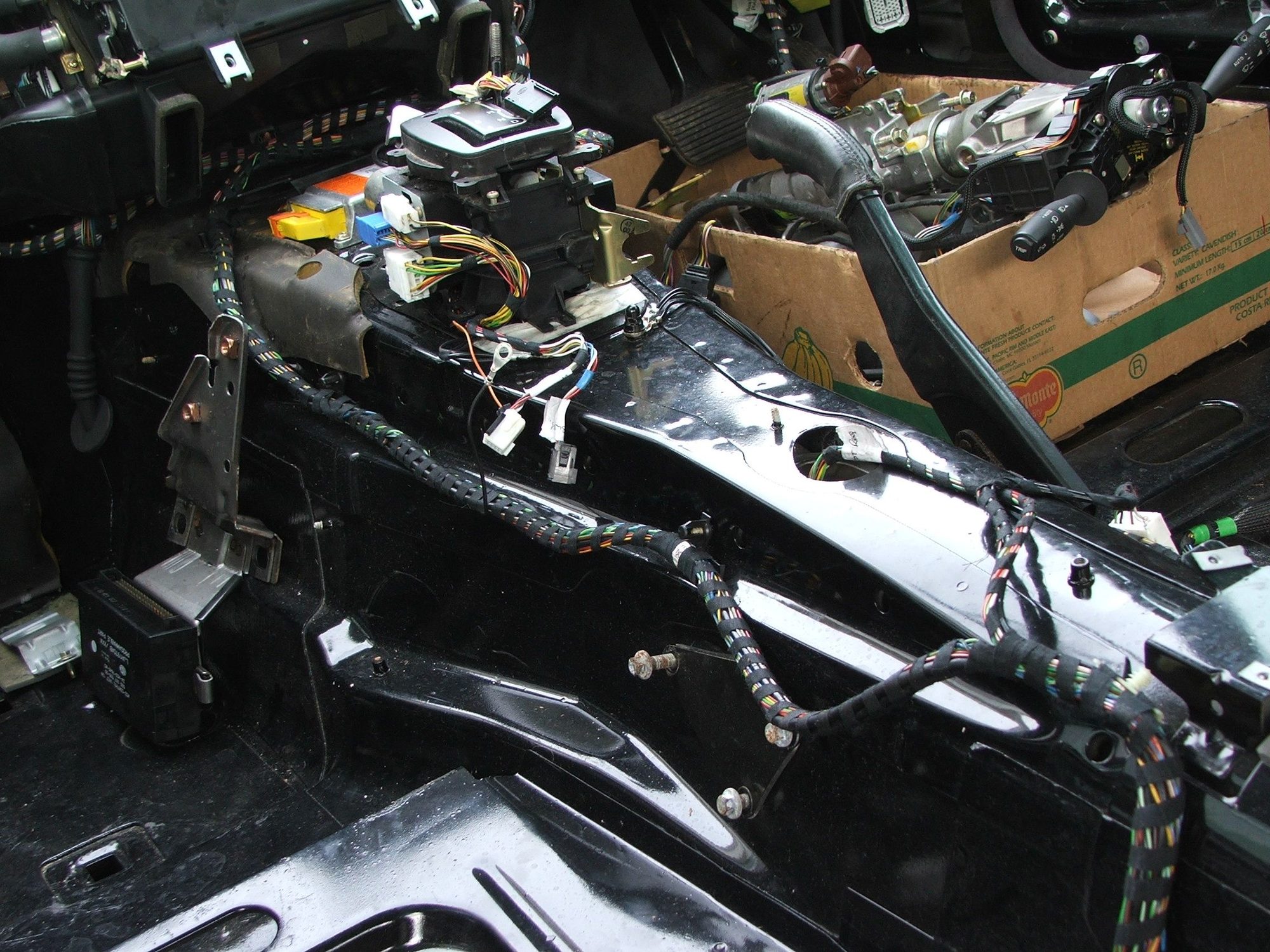

From the new shell work I did it looks ambidextrous. 100% possible.
RHD handbrake wouldn't work without custom bending in a BF vice. Not sure what the LHD lever shape is but can be reused.
Plate that covers the hole left and be swapped.
Underfloor lever will fit by turning the assembly 180, or upside down, if it's even an issue?

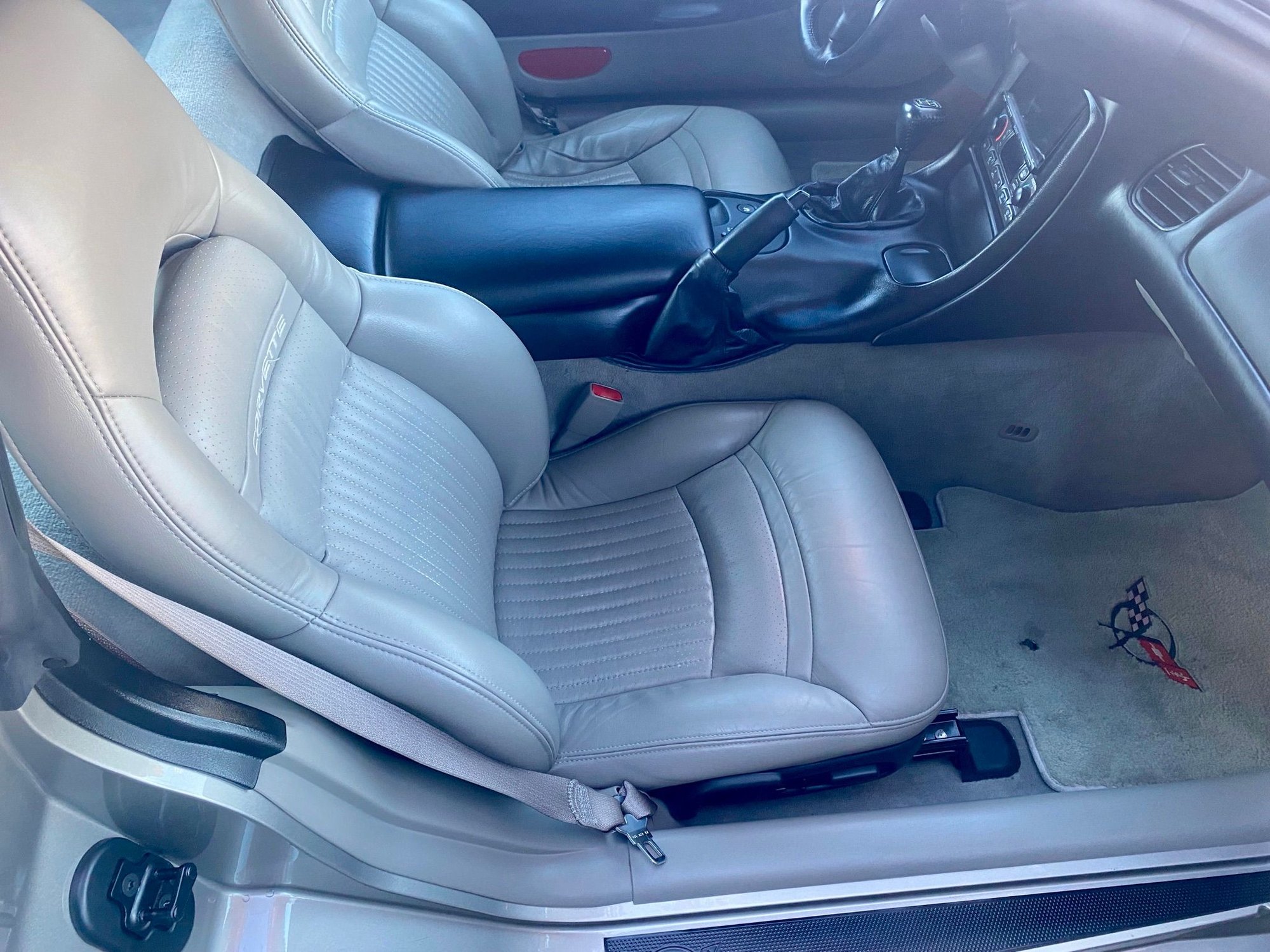

If I sit in the passenger seat of my LHD car, I can easily reach over the center console and engage/release the hand brake with my left hand. There is no “bind.” I would like to put the brake lever from a RHD car on the passenger side of my LHD car so it is not gouging my leg. (I have long legs, so with the seat all the way back, and my right foot on the accelerator pedal, the current hand brake lever pokes onto my leg.) My 2001 Corvette is set up this way and it works great.
