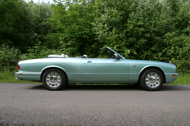

From what I've heard, yes. It'll have to be reprogrammed with IDS/WDS software, main agent or good dependent Jag specialist. I was told its a box you fill in with required top speed, within the program. Someone with IDS knowledge will hopefully chip in.
Are you making a Corsica rep then?
http://www.davidmarksgarages.net/dai...20part%205.htm
Attached Thumbnails Speed limiter/reduce top speed-102.jpg   Speed limiter/reduce top speed-daimler-corsica.jpg

Corsica was my first thought, but that was only a 6 pot wasn't it? This does sound very interesting though. S.

very similar chassis Stu.

Yeah I know, I've seen (and sat in) the Corsica in real life. It is a pretty thing, but I prefer the V8 over the 6, so a V8 Corsica would be on my Lotto win bucket list I think!
Or how about a V12, that'd be very cool.
I posted Dave Marks page on the resto because he uses a very neat trick stiffening the chassis with a mildly modified XK8 cross brace. Hope that helps.

Corsica rep after a fashion. 4 doors and the LWB version, rather than a shortened SWB and 2 door. (think Lincoln Continental with the suicide rear doors) Briefly considered using one of the last of the Daimler double sixes, but decided that people might disklike us for butchering one of those rather than an early X308. That, and 25 mpg rather than 15!
