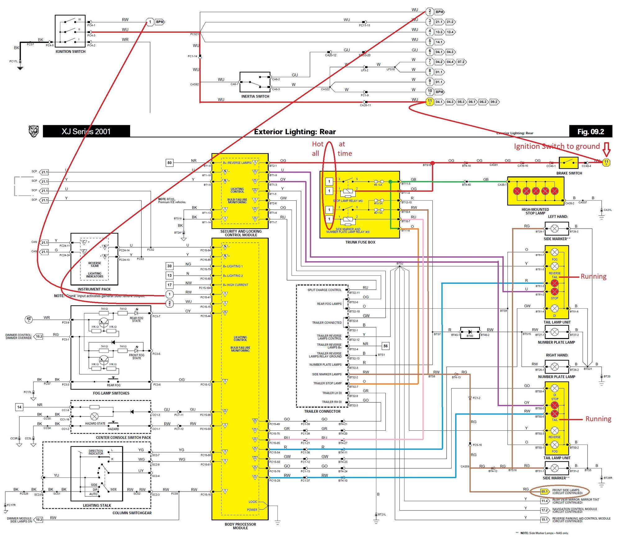

Looking at the wiring diagram, it could be #7 fuse in the LH healboard. 15 amp. Shows it as being the solenoids fuse for the gearshift interlock. The gearshift and brake lamp circuit goes through the BPM so it’s possible that module could be going bad. There’s more fuses for the module you could check.
Hope all is well down there.

The brake switch is 2 switches in one package , one dedicated to the stop lights
If both switches are not working it can be mechanical adjustment or the switch lever broken
You can test this switch at other points of the car like the ABS connector
The brake switch gets a ground path through the ignition switch to the pin 5 ( Black / Pink color wire ) of the IG switch connector
This pin 5 can get corroded from fluids and the car frame ground can get disturbed behind the dash
Easier and cost to check then digging the brake switch out , IG connector ( 5 wires ) located as you remove small curved panel under the steering column , to pull the car side of the connector out to you lift straight up on the car side of the connector

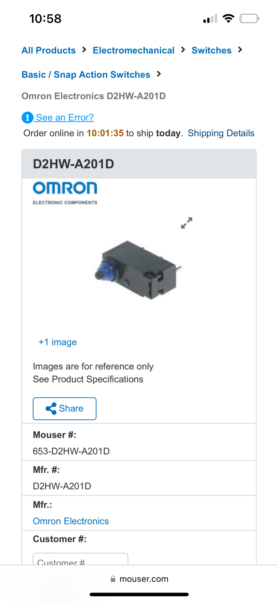

Just replace this part and see if it's fixed
D2HW-A201D
D2HW-A201D
Having some trouble finding this part. Only thing I’ve came across is this.
