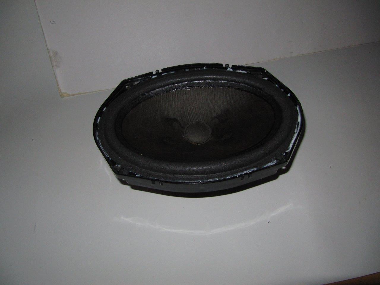

-Finish off by wiping the back off the speaker clean with rubbing alcohol (2nd photo)

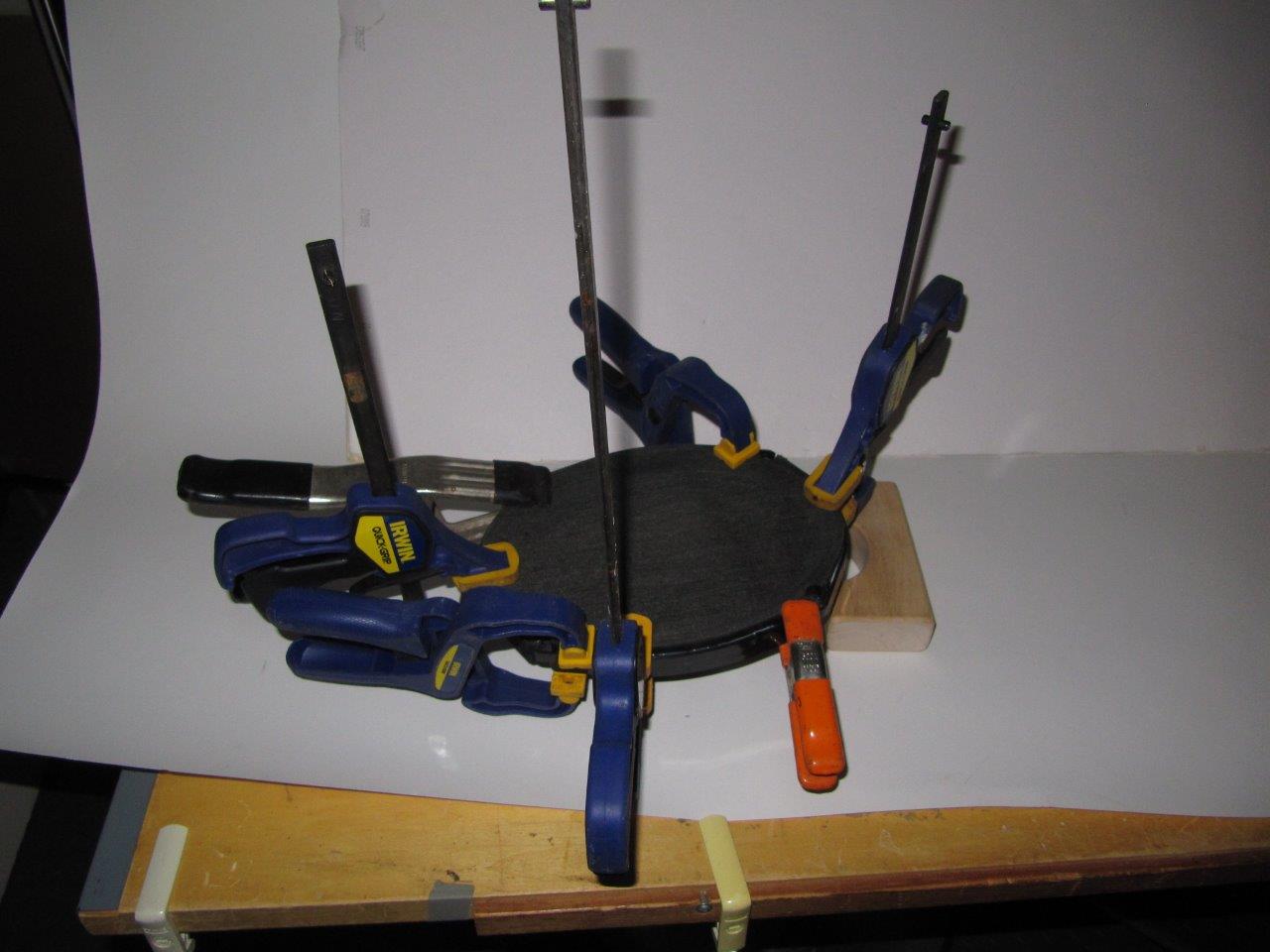

-I quickly removed the top cover and cleaned off the excess glue 3x so the cover would not adhere to the foam and then clamped the top cover on all around until the glue was fully dry (3rd photo)

-After 2 hours I unclamped and removed the top to check the new foam. (4th photo) All seemed good so I put a small amount of black silicone on the side of the top cover where it meets the speaker basket to prevent vibration and then tested the speaker back in the car. Clean bass - distortion gone
