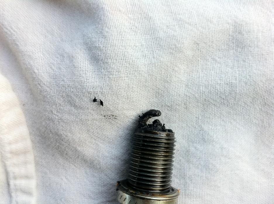

Pulled the #7 spark plug. I don't know a lot about plugs and I've never done much "mechanic-ing" but this plug sure looks bad. Will attempt to attach picture.
Well, the good news is it looks like this could be the problem... the bad news is it looks like you have oil blow by in that cylinder....
Finished the driver's side bank then I went off and did other stuff without starting it up.
there was some kind of loud tapping/clanking sound - I shut it right down.
1. the picture you posted is definitely oil fouling
2. what "other stuff"? did you have any part of the internals open?
3. aside from #2, if it sounded like a loose bicycle chain dragging against the guard, it is a cam chain/tensioner problem. just search on "tensioner" on this site.
do not start it up again until you figure it out, or at least rule out #3
#3 is your most likely culprit unless you put something back wrong in the earlier work.
In addition, from your opening post: "Suddenly running very rough at pretty much all rpms." is symptomatic of #3 in addition to the clanking.
What happens is the exhaust cam sprocket chain skips a tooth -> bad cam timing -> rough running. That advances to parts clanging around.
Ruling out #3 requires removal of the valve covers for visual inspection. Of course you must have searched out the pictures to know what it should all look like for this to do you any good. Should take 1.5-2.0 hours working slowly.

That is a nasty looking plug -- and most likely would cause a misfire. The question is why ?
Looks to be oil? Whenever I have encountered a fouled plug that I can definitely trace to a failing/ failed coil they look wet but not oiled like yours. More of a carbon wet ....... obviously not a technical term
Is this engine one with Nikasil linings?
A failing coil can be a pain to diagnose -- because they appear to work most of the time -- but the plugs normally don't look all that much different and replacing the coil normally solves the problem. Although replacing the plugs may be advised.
You have something else going on -- oil coming from the top down through the common valve cover seals leaking into the plug channel is not going to get to the inside of the cylinder.
How rough was then engine running? Does it have its original tensioners?
I would hate to think that the rough running stressed dying tensioners causing your start up noise. I can't see how what you did would cause your noise.
If you had put the plugs in wrong -- it would not have started and run correctly. Say -- for some reason one of the plugs did not seat correctly and you had combustion gasses coming out.
I would look very closely prior to starting it up again -- Good Luck
