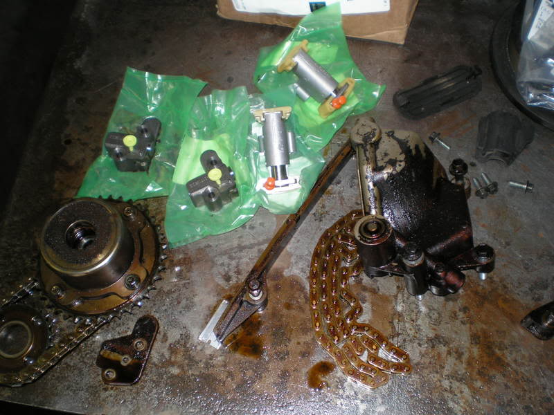

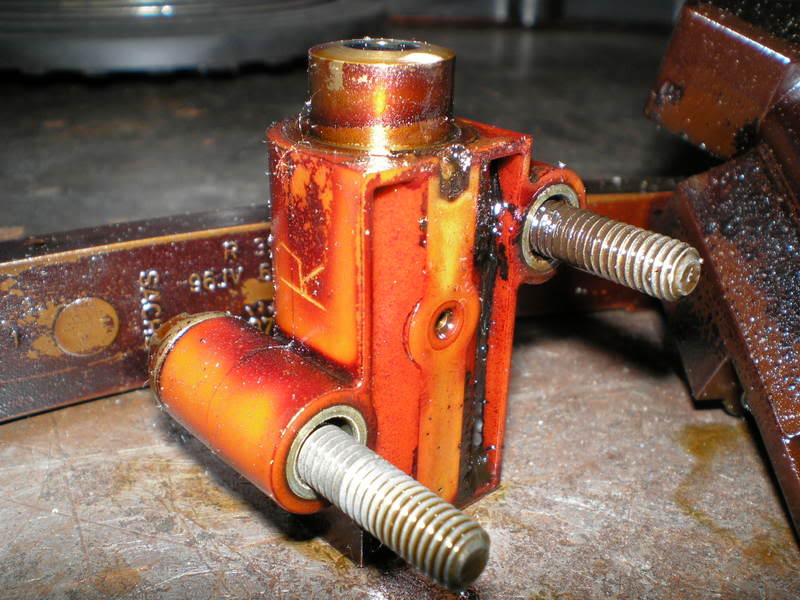

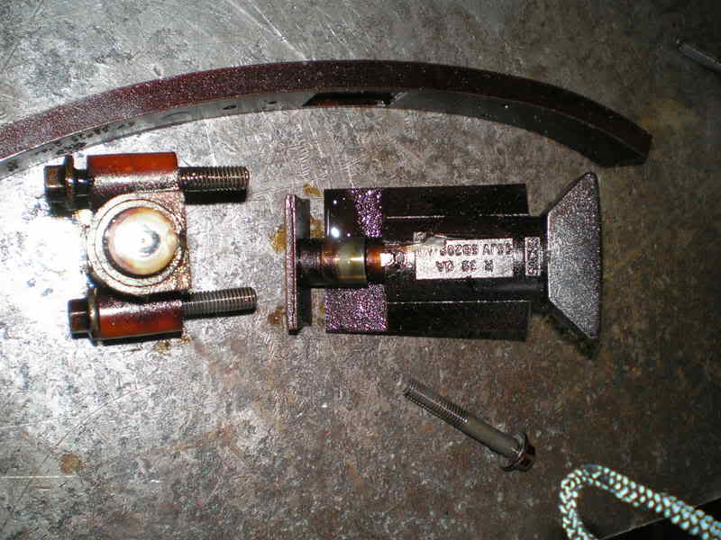

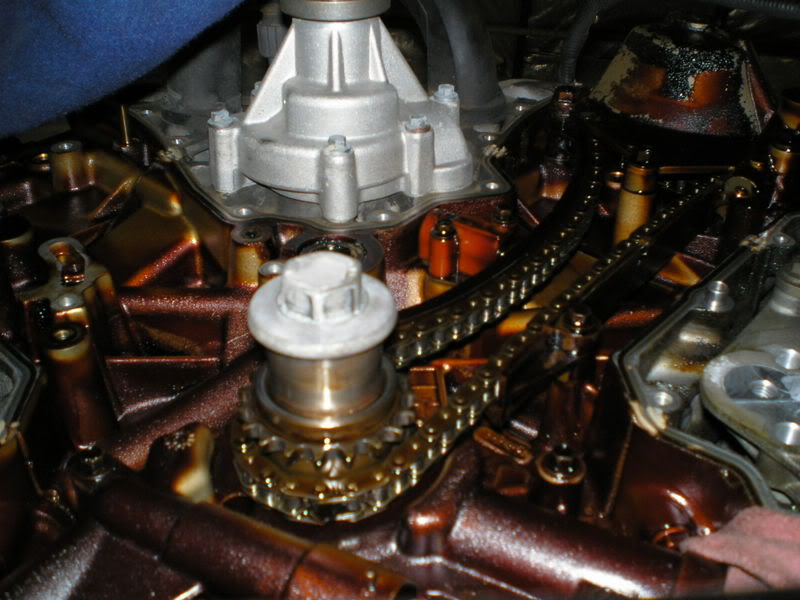

Job is almost complete, got to see my broke down engine today. I got soooooo lucky I swear, myleft Primary was very busted up, gone orange as usual, big crack and plastic end fallen off, chain was rubbing metal! All completely sludged up, I am thankful of this site or I would have never known. Check out that crack!
EDIT* Couple variouspics of the left side, primary/secondary tensioners, a guide (might be a blade can't remember, and is that a crack/notch or supposed to be there by the mounting hole?)and a shot from under the car on the rack, auto focus having a hard time it was dark under there.

Yo it's cool. My mechanic here outside STL, MO did did both sets in 6.2hrs total. Turns out, as busted up as my primary tensioners were..I just needed new tensioner's, guides and blades. and all is perfectly silent. It obviously got hot a couple times and cooked as you can see from the sludge on everything, probably from when I had my water pump go out when I first got it. (getting that cleaned out).
Not pictured, but the right primary was also shot and badly cracked as well.

Nice shot of cooked/cracked tensioner's..
