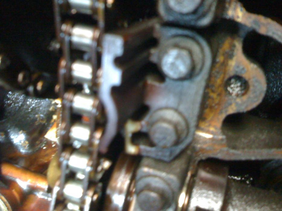

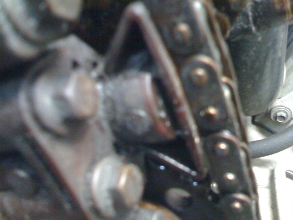

Default Tensioners 99 XJ8 UPDATE!
We're 6 months down the road now with this one. I've been pleased with the car. About a month ago I was returning home and noticed the sound of the ticking under the hood had changed greatly. I've never heard "the death rattle" before but I take no chances. The engine light had been coming on at times the the previous 2 days. I had it out of the garage for a wash, went to crank it to put it up and it didn't want to crank. Finally did but was idling rough. This was cause for concern.So I finally decided to jump in and check out the condition of the tensioners. Pulled off the cover on the passenger side and here is what I find, It appears to be in great shape to me. I have not removed the driver side yet pending your thoughts and comments.....So what are your thoughts based on experience?..Thanks

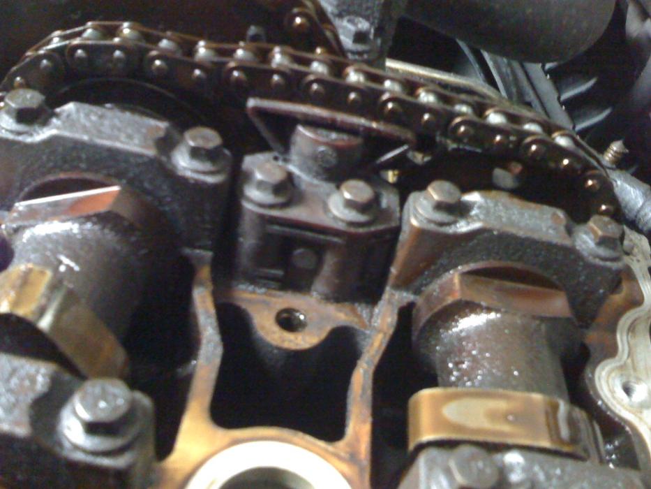

Advanced the motor round till the cam flats were visible, here are a couple of shots of that. Does the variable timing allow for this much variance or has this motor jumped timing?

That is about how I remember my right hand flats looking after the clamp tool was removed. The valve springs pushing on the cam lobes causes them to move out of alignment. The left side was not as pronounced.

I am far from a Jag Tech, but the cam flats look close to one tooth apart to me. If you are getting valve noise and rough idle, those are definite symptoms. I found the right side chains did slack off when the lock down bars were removed as mentioned by test point when I changed mine, but don't recall it being that much. Sorry I do not have a picture to compare with yours... and it has been a while. That aside, the tensioners in your photo do appear to be intact, so you may want to check the other side.
They also look to be plastic, so you would want to change them out for sure if they are. If the car is making a lot of noise and running very rough at idle, I would definitely check the other side, since this side does not look like it has failed (yet). It may also be possible that the chains have stretched to point of making noise. I got a stethoscope and listened to each side on mine, and could definitely hear the offending bank with that. Mine skipped a tooth, so I put in new secondary tensioners. I still ended up with noise on one side and had to change the chains, as one had stretched and would not be quiet. I was told the new metal tensioners do not extend out as far as the original ones, so that may have been a contributing factor.
Just as an observation, there seems to be a lot of debris or crud on the engine in your photos. Maybe a flush would be something to put on the list of future chores. I attach a shot of my 98 XJR chains for reference. The secondary tensioner is in the upper right corner. You may notice the difference in engine debris too.

I second the one tooth apart!!!
That explains the rough idling and the amber light coming on.

Thanks for all of your replies. I felt that it looked way off to me also but this is really my 1st foray into the "outer internals" of this engine. And yes, the motor looks quite dirty. I don't know much of the history of the car. I bought it as it had been sitting-up for several months and according to the owner at that time...a new engine was needed. I've always had my reservations about using a motor flush on a high mile (168k in this case) engine for fear of starting leaks. currently this engine has NO leaks,....guess all of the grime has prevented that! So, all of that said, I guess I will move onto the other side and replace all chains, guides and tensioners...Thanks again guys!

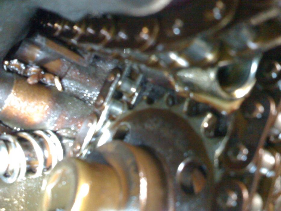

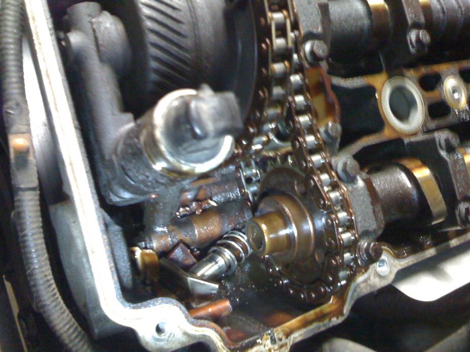

Well,....I decided to get on with it....pulled the cover off the left side and here is what I found...................I'm thinking something is outta sorts here!

A day late . . . and all that rot. At 168K miles you sure got your money's worth out of that bit of plastic.
Sorry 'bout that. Maybe if it is running but only rough you escaped bending a valve.

My first reaction to these pictures was..."Holy ****."
I think you may have been very lucky, unless the cam flats on the left side are out of sync to a larger degree than the right side. As I understand it, one tooth and you survive collisions, two and you are in trouble.
Check that the sprockets on the left side did not sustain damage, as the secondary chain had to have been slopping around considerably. Hopefully not long enough to be a problem
If I were you I would unbolt the oil pan. It is just a shallow pan with about two dozen bolts. Once off, you can unbolt the oil pick-up and clean out the screen. I would bet you will find some debris lying in the pan and some tucked up inside the lip of the oil pick-up. You may be able to do so without needing a new seal. Based on your photos, I envision some sludge hanging around the drain plug area of the pan as well. There is a torque sequence pattern in the JTIS manual.

I can't believe it - That engine is still running?
WHOW...
I guess you know now what to do...

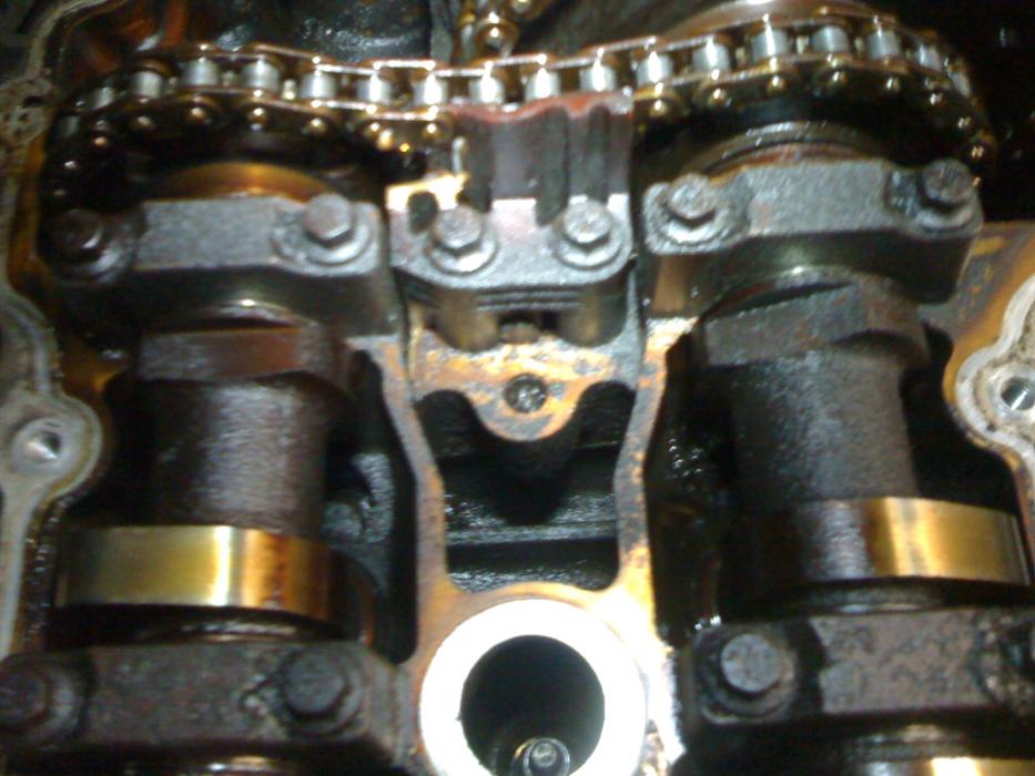

Thanks for all of your responses...here is a quick look at the cam position LHS

That couldn't be more than one tooth! It lives!
