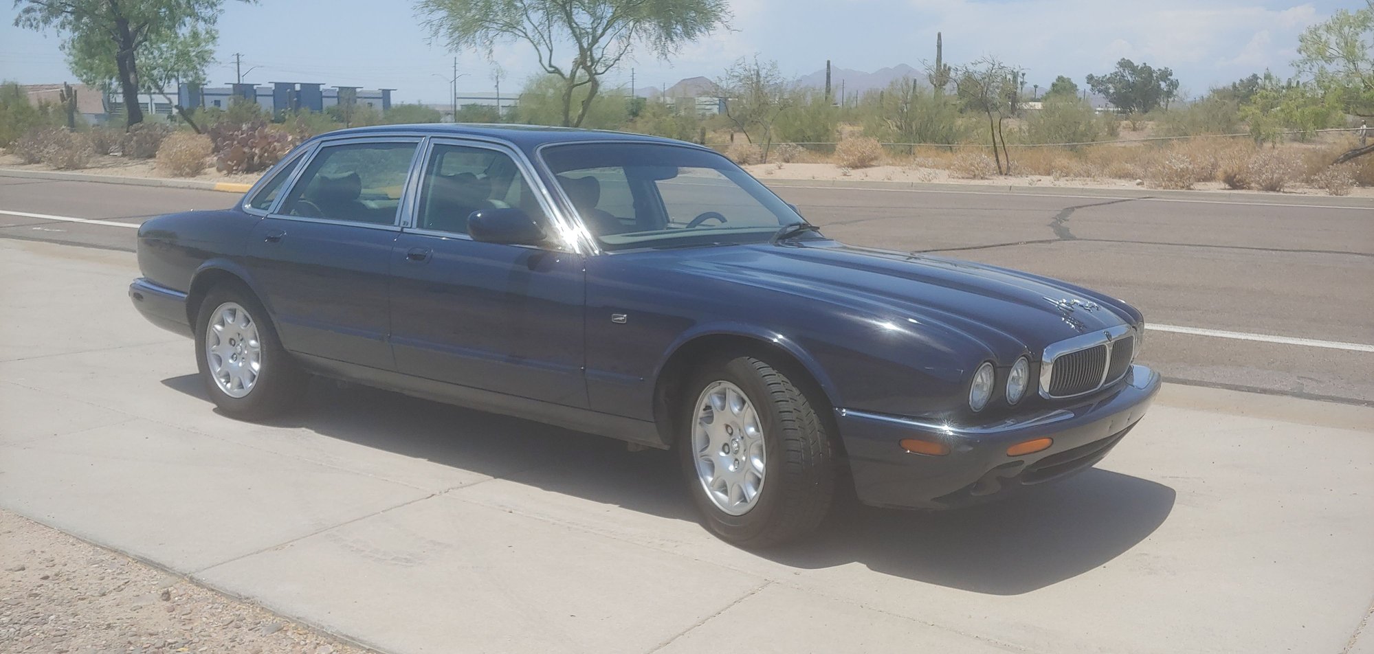

You mention non-pretty stock wheels..........not sure what those wheels are, do you have pictures?
In Texas. Can be very dry here, has coastal cities, this one seems to have been a central-Texas car. Awesome advice thank you. They're the base model stock wheels. They look sort of boring and more on the side of class and "base-ish" lol I am comparing them to the R-spec wheels which in my eyes are some of the prettiest ever produced.

Totally agree with above recommendations. Keep in mind that the '01 is mid-run of basically unchanged 308 models. Notably, is the issue of tensioners. So, as with the 01 base 308 I bought this summer, if all checks out, and you are willing to pop $$, it is a car well worth the love and respect it commands.
One minor, nuggie thing I discovered is a common failure of trunk issues, i.e. locking/unlocking. A surprisingly easy remedy I found on mine was an easy repair to the wire harness as it snakes thru the pass side hinge. It has a "pinch point" at the bottom of the hinge, breaking wire(s). I found 5 of the 8 pinched or totally severed. You can choose what way to reconnect, but also an alternative route to avoid the factory harness route.
