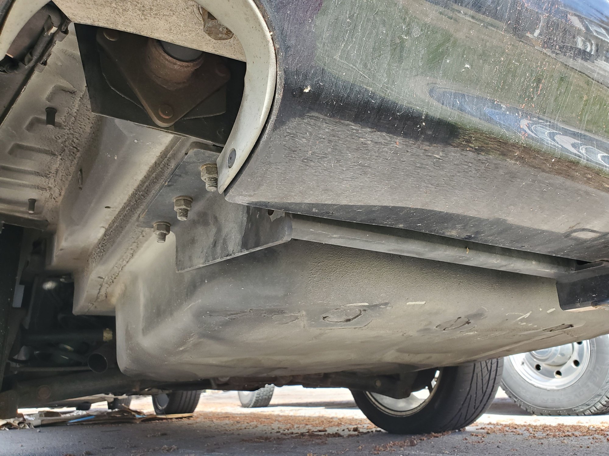

Curt makes a normal hitch for these, bolts through the body
https://www.curtmfg.com/part/11818
I had in on my xjr for use with bike racks, but it works for towing as well
You can kind of see the mounting points on this side, the manual in the link gives more details though
I've just checked the handbook, that's how it shows to attach the towbar (except it only shows two bolts per side).
Along with
Max recommended braked trailer load 1,500kg / 3,307lb
Max braked trailer load 1,900kg / 4,188lb
Max recommended unbraked trailer load 750kg / 1,653lb
Trailer nose weight 76kg / 167lb

Dang! There's not a lot of ground clearance under there to begin with, and some scary geometry. I'd avoid steep driveway entrances and speed bumps with a hitch on an X308; more so with the extra overhang of a hitch-mounted bike rack unless it's on some kind of gooseneck to raise it up. I've nearly scraped those on a Volvo XC70 on such inclines.
