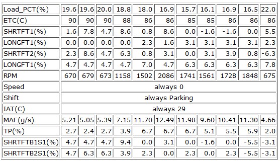

Data on warm engine with rev-up on parking without moving the car:
Load_PCT(%) 19.6 19.6 20.0 18.8 18.0 16.9 15.7 16.1 16.9 16.5 22.0
ETC(C)
90 90 90 88 86 86 85 85 86 86 86
SHRTFT1(%) 1.6 7.8 4.7 8.6 0.8 8.6 0.0 -1.6 -1.6 0.0 5.5
LONGFT1(%) 0.0 0.0 0.0 0.0 2.3 1.6 3.1 3.1 3.1 3.1 2.3
SHRTFT2(%)
2.3 8.6 4.7 6.3 0.8 3.1 0.0 3.1 3.9 0.8 -6.3
LONGFT2(%) 4.7 4.7 4.7 4.7 7.0 4.7 6.3 6.3 6.3 6.3 7.8
RPM
670 679 673 1158 1502 2086 1741 1561 1728 1848 675
Speed always 0
Shift always Parking
IAT(C)
always 29
MAF(g/s) 5.21 5.05 5.39 7.15 11.70 12.49 11.98 9.60 10.41 11.30 4.66
TP(%) 2.7 2.4 2.7 3.9 6.7 6.7 6.7 5.1 5.5 5.9 2.0
SHRTFTB1S1(%) 4.7 4.7 4.7 9.4 0.0 3.1 0.0 -1.6 0.0 -5.5 -3.1
SHRTFTB2S1(%)
4.7 6.3 6.3 3.9 2.3 0.0 2.3 0.0 2.3 -5.5 -3.1

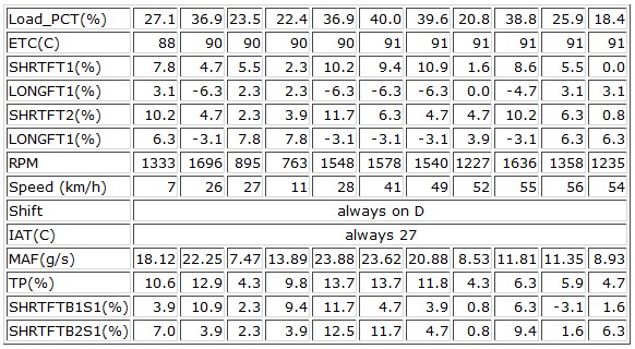

Data on warm engine while driving:
Load_PCT(%) 27.1 36.9 23.522.4 36.9 40.0 39.620.8 38.8 25.9 18.4
ETC(C) 88 90 90 90 90 91 91 91 91 91 91
SHRTFT1(%)
7.8 4.7 5.5 2.3 10.2 9.4 10.9 1.6 8.6 5.5 0.0
LONGFT1(%) 3.1-6.32.32.3-6.3-6.3-6.30.0-4.73.13.1
SHRTFT2(%) 10.24.72.33.911.76.34.74.710.26.30.8
LONGFT2(%) 6.3-3.17.87.8-3.1-3.1-3.13.9-3.16.36.3
RPM 1333 1696 895 763 1548 1578 1540 1227 1636 1358 1235
Speed (km/h)
726271128414952555654
Shift always on D
IAT(C) always 27
MAF(g/s) 18.1222.257.4713.8923.8823.6220.888.5311.8111.358.93
TP(%) 10.612.94.39.813.713.711.84.36.35.94.7
SHRTFTB1S1(%) 3.910.92.39.411.74.73.90.86.3-3.11.6
SHRTFTB2S1(%) 7.03.92.33.912.511.74.70.89.41.66.3

Here is what I got today on warm engine while the car was on parking and after that - driving around. The car is running only on petrol, no LPG at all. The engine was working as it should - no shakes, no smells, just perfect! Tomorrow morning I will post similar data but on cold start.
Does anyone see something wrong with this data?!?!
P.S> I just noticed a little mistake from the diagnostic software... the second LONGFT1(%) is actually LONGFT2(%)
Attached Thumbnails Unstable engine on cold start + low mileage-table1qc.jpg   Unstable engine on cold start + low mileage-table2v.jpg

Best measurements are always once you have let the stft/ltft values stabilize.
So do an idle measurement, wait until the figures are stabilized and then take a measurement.
Next also one for driving, i.e. 50mph, drive steady, wait until the figures have stabilized somewhat, and then do a measurement

Thank you for the advice avos - will do the measurement again. Which values from the table below should I record on my scanner?

FINALLY - I FOUND IT It's the MAF sensor...
Here is what happened. Last Sunday (I tried to post a reply from my iPhone but something was wrong as it appears that my reply is not here) was again a very cold morning so I decided to run a new reading with my OBDII scanner. So I entered my jag, connected the OBD and started the engine while watching the data on the tool. I set the tool to show all available data from sensors to be sure that I'll capture if there's something wrong... and it was! The engine ran just as I expected it to run - first the rpm's increased up to 1100-1200 then in just a 1-3 seconds it dropped to 800 and then the car started shaking... then I tried to step on acceleration pedal - each time I was accelerating, the rpm's were actually dropping down... even when I stepped up to 30% of the way of the pedal the car almost stalled at 200 rpm's. So here is what I saw on the scanner tool:
As the sensors are too many to appear in one screen it's separated on few pages. The first page was for temperatures... Everything seemed ok at first look - coolant temp was 0, air intake temp was also 0 and the outside thermometer on the A/C dash was showing -3C degree... so it had to be normal.
Second page... fuel trims... to be precise: SHRTFT1, LONGFT1, SHRTFT2, LONGFT2, SHRTFTB1S1 and SHRTFTB2S1... Here is the place to mention that I don't have even a single idea what does short and long fuel trim mean. But I was confident that there's something wrong with it as all 6 sensors were showing constant 0 except the LONGFT2 which was stable at 6.1% at idle, then in a few seconds it dropped to 4.5% at idle. When I was stepping on acceleration the value was dropping down to -3.2% while just for a second a value of 2.1% appeared for SHRTFT2. All other sensors: SHRTFT1, LONGFT1, SHRTFTB1S1, SHRTFTB2S1 was stable on zero both on idle and while trying to accelerate.
What does this mean?!?!
Third page was throttle position, MAF, RPM's and others... Here I was confident that I'll see if there is any problem with my throttle. At idle the position was stable at about 3.4% and the MAF was showing 4.8g/s... when I was stepping on acceleration the TPS increased up to 33-35% and the MAF increased up to 40-50g/s. So apparently it was responding to my foot No problems as much as I understand.
Than the payoff came! I scrolled back to page one, just to recheck data and then I saw it... it was the IAT(C) - air intake temperature... it was already at 28C degree and it was increasing with one Celsius every 3-4 seconds... As you may except the temperature outside the car didn't changed for the last minute while I was testing... there was 40cm snow all around and over the car! So here it is... The MAF is returning wrong data about the temperature of the air that's entering the engine which is messing up the mixture of air and fuel. And again - as much as I know how the MAF works it's function is based on two temp sensors inside of it and a microscopic heater between them. Meaning that - wrong temperature will be equal to a wrong volume of air entering the engine!
Maybe the problem is present only at cold weather as the difference is too big... and when the engine is hot it's taking data not only from the MAF to calculate the mixture.
I've ordered a new MAF already... I'm expecting it to arrive soon. Meanwhile I want to recheck the strange values about the fuel trims and to learn more about what do they mean
