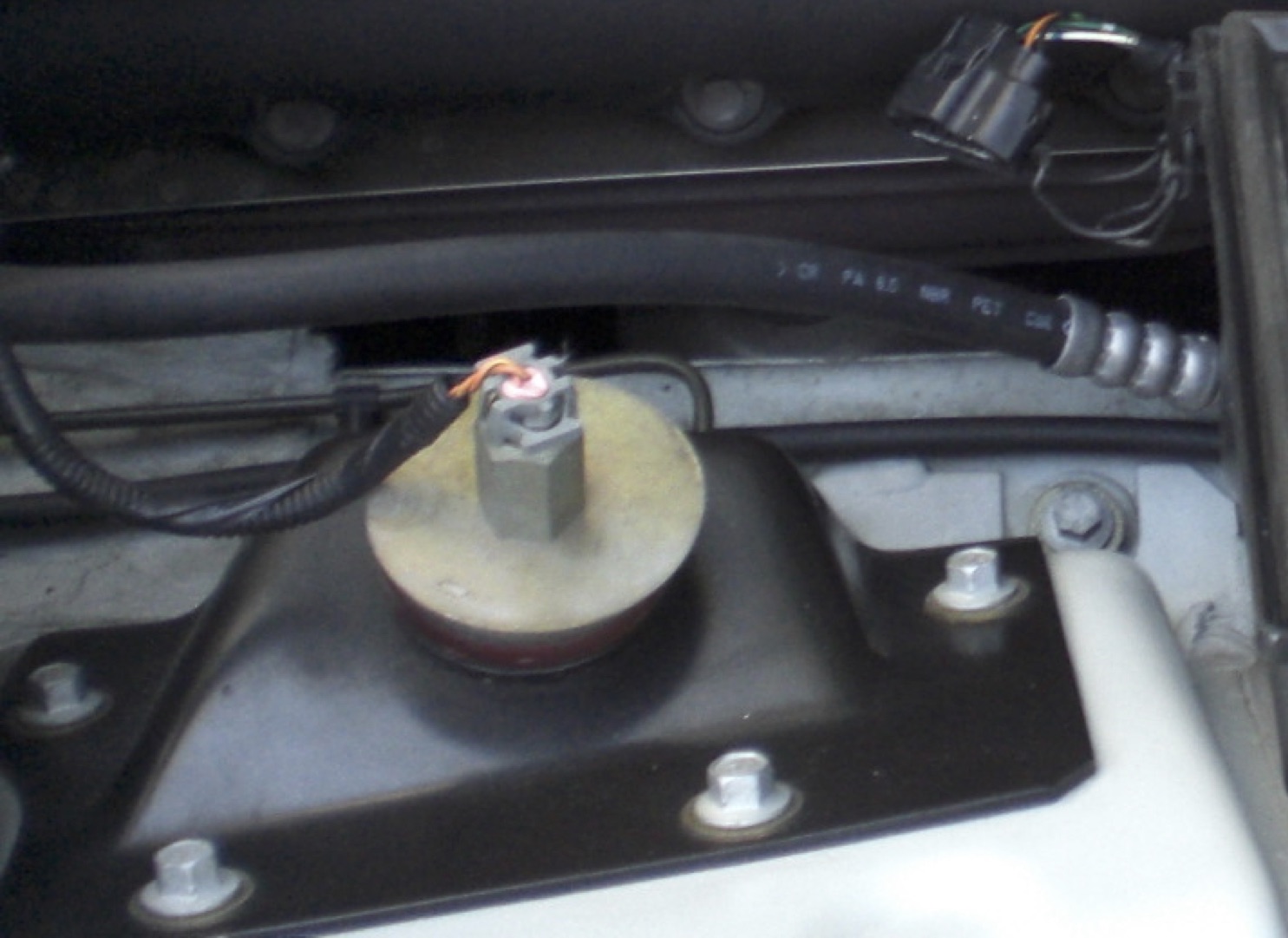

Can you post a pic of the CATS suspension mount and explain the difference?
This is the first time this question has come up in X308 front shock bushing threads.
Vector

Here you go, please see attached photo. The black plastic dome cover was removed. I think the diameter of the shaft is larger that the non-adapting shock. BTW, that adaptive shock runs about $350 new.
That's true, I hadn't thought of the diameter possibly being different. I do have to add it to my to-do list, so I'll have to make sure I'm looking closer.
The mounting plate "looks" the same.
But without having both of them in front of me, it is difficult to tell if the Rock Auto parts could be made to work, but if all we are talking about is the diameter of the shock shaft, I am thinking it is doable.
Probably worth a try since I would guess the CATS mount is dealer only and probably in the $300+ range?
Vector

I can confirm the CATS shock is bigger in diameter. I have a VDP and a XJR with CATS. While pressing one of the mounts for the XJR I was distracted by a friend and crushed the inner metal tube .
I needed the car for a trip, so like any good Jag owner, I have a second one for parts and I swiped the plate off it. It didn't fit. The CATS shock shaft is larger in diameter.
I ended up sourcing a used non-CATS one and drilled out the inner metal tube to fit. The tricky part is there is an internal stop. Ideally, one would use a lath to mill a copy. I used a drill, thus my stop has an angle to it. In the end it worked out.
CATS top plates appear to be made out of unobtainium, but it is possible to machine one of them to fit. It is also possible to use a new plate just to source the bushings. Press them out of the new plate and using the hardware from the old CATS plate, carefully press the CATS hardware into the non-CATS plate. TLDR, the only difference between CATS and not CATS is the inner diameter of the metal tube - everything else is the same.
