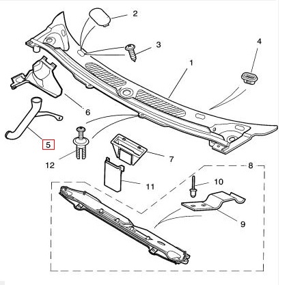

Nothing too helpful in JTIS but the diagram from JEPC makes the layout clearer:

Is that the XK cover? Looks a bit different but it gives an idea. Which section was that under, I tried to dig through JEPC but didn't have good luck navigating to it.

Didn't have time to test my solution but I *may* have figured out the cause. The drain actually funnels towards the center towards the wiper motor assembly. From there it just seems to drain out of that all over the top of the transmission or something. All very strange... However, there is a "non-return valve" that's just a flap of rubber at the bottom, and that seems to have gunked up and stuck shut. Guess it's non-return so that the hvac isn't sucking in engine fumes through there.
There are also drain hoses at the edges of the cowling/cover, removing the false bulkhead covers provides access to them. The passenger side one seemed clear, but again I didn't get a chance to pump water through it.
part 4 is the non-return valve in the washer motor cover/assembly
