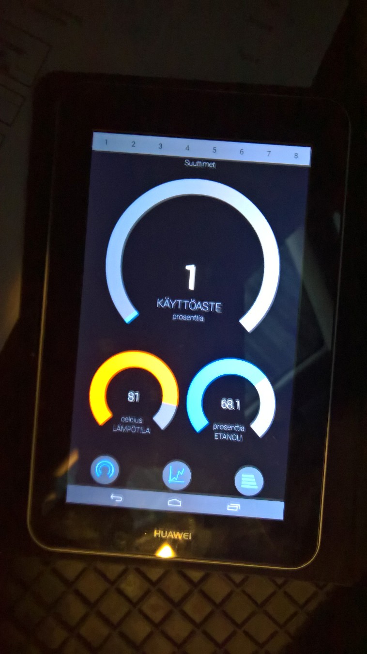

I run E85 - as you can see eth% is 68%. at the moment. This is still winter blend. Summer one gives over 80%. The car is flexfuel, so boxes change fueling based on measured ethanol content.
