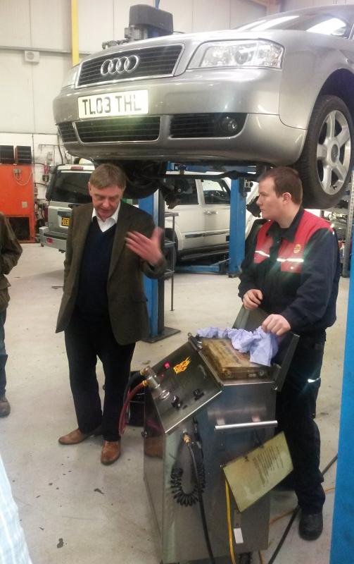

At our visit to mackies yesterday, John Mackie the MD discussed this issue / procedure at some length.Originally Posted by osyris

I can't remember all of it unfortunately as there were a milion other things going on, but they have a special machine ( I believe he said it was the only one in the country iirc ? )......you can see it hooked up in the pic.
I believe John said something along the lines of What Doug has quoted, mentioned around 10 seconds iirc, clearly 5 secs is erring on the side of caution and no bad thing.

Quote:
Is that a homebuilt fluid exchange machine?! how much $$
whats the process
No, that was at my shop with a machine from BG produdcts. You should expect to pay approx 200-250US using synthetic trans fluid.Originally Posted by osyris
