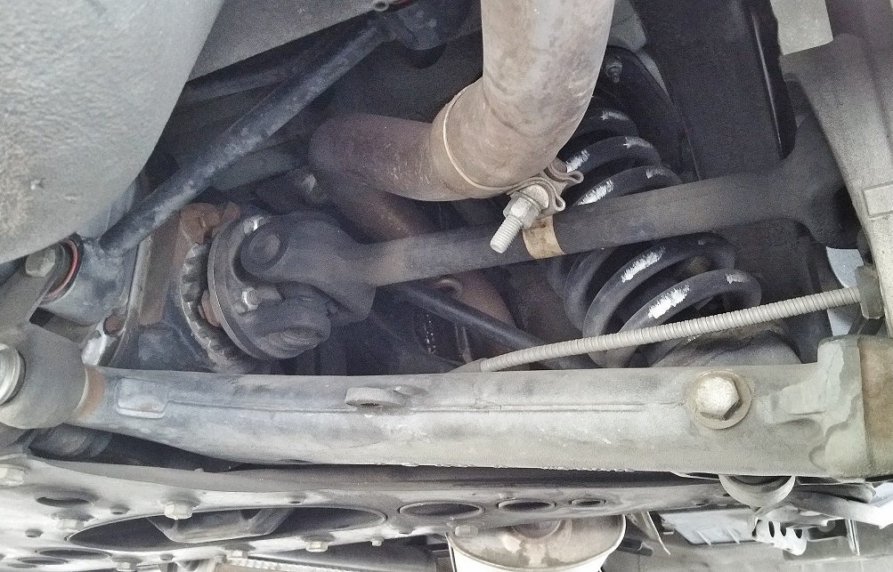

It looks like the sway bar and links have been removed by someone.
The first pic is from the ad, the second is from my 2001 XJR when I changed my links and bushings.

It probably never had a rear anti roll bar, since there's no mounting plate for the roll bar bushings (see attached pictures).
There are two versions of the wishbone tie assembly and I doubt that the preowner changed it to the "no anti roll bar"-version when removing the anti roll bar. So it's more likely that it didn't ever had an anti roll bar.
Even though I don't know of any XJR, which had no anti roll bar...I thought they'd been fitted as standard for every supercharged and XJ Sport version.
Maybe the car got a whole new rear suspension or differential mounting at some point?
Regards, Alexander
Totally agree, no one would remove the wishbone assembly - this car, or this rear end never had one. Maybe the wrong rear assembly came down the line and into the car it went

Thanks for the quick replies, I concur and noticed the wishbone mounting tabs and lack of the correct central mounting plate, so it had me scratching my head too.
I can't imagine anyone removing the anti sway bar, and even if so also changing out the differential mounting plate, so it's an odd one. An interesting mystery.

It did not come off the assembly line like that.
Lack of a rear sway bar may not make a lot of difference, but the XJR suspension was engineered to have it.

Do you guys see the difference on the rear of what Vector posted? If you don't have the sway bar, you have the truss carrier like I have on my VDP. It literally is a truss like on a commercial building. This mounts to the body on the wide parts of it and down to the differential where it is attached. Thus replacing the old style sway bar.
I used yellow on the second pic to see it easier.

I noticed the same although I don't see how the truss bar arrangement can replace and/or perform the same function as a rear anti-roll bar. Am I missing something?

Every version of the 308 uses the same truss. It has noting to do with the anti-roll bar. The CATS electronic shocks have a soft and a hard setting and all 4 shocks adjust together. They do not provide any anti-roll control.
