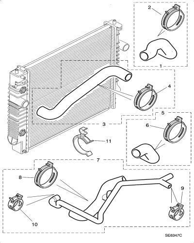

First what i've done was replace oil, filters, cooling hoses (they were inflated like a ballon so they can blow up very soon).

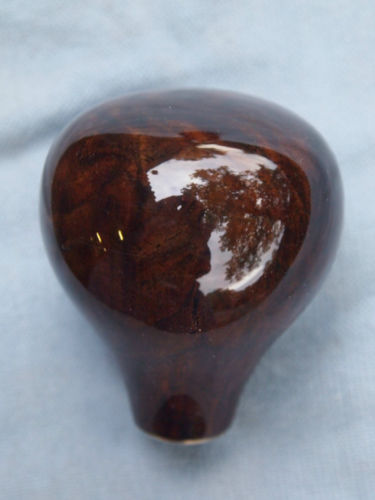

Then i want to restore the interior wood. It takes me a lot time to find where i can do this and i find one guy outside Russia. So i come to the paint shop to take out all parts what needs restoration.
I have ordered a new wodden gear knob
And after a few weeks a get all the parts back. Looks very nice now.

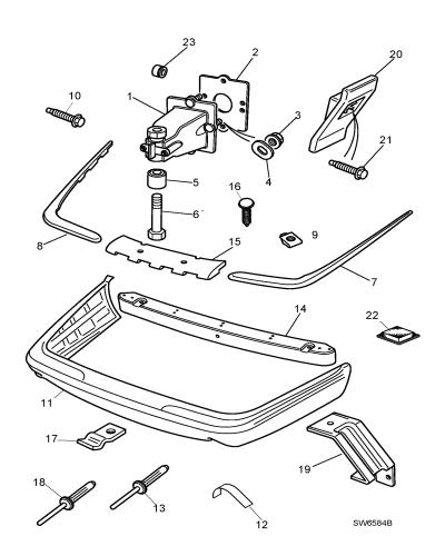

Then i said guys in the paint shop that i do not like how rear bumber seats on the place.
They take off the bumber and find that right mounting was cracked.
So i bought a new one.
And then a saw some cracks on the rear bumber.
It was caused by bad repair in the past.
I was trying to find a new rear bumber but have no luck. Just find one place where seller says he's got one in very good condition. When i come to see it was not better than mine allready repaired. So talked to my guys from paintshop and they say they repair it the best they can.
But i find one peace what was missing on my bumber (15 on the list).
The seller with the bumber didn't want to sell me it separate and i can't find it new anywhere so i offer him 4 times more that it costs new and he sell me it.
Then i found a new high mounted stop light holder. So now it is everything good.

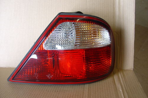

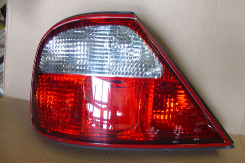

A new rear tail lights.

But the gearbox knob looks not so good. Everything is so different so i'm looking for a new gera knob maple eye.

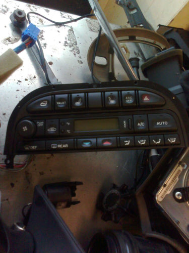

And bought a new climate control because mine has some lamps broken and some other small problems.
