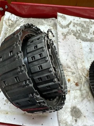

Well, for a little over ten year update, the A-drum finally grenaded.
Maybe the Sonnax valve body bought me 10 years and nearly 40,000 miles, I dunno. I figure it had probably been compromised/weakened before the Sonnax install. When I search for where to get the upgraded A-drum, there's a few sources that come up, mostly on E-bay but I don't know which one is really the upgraded version or they say its for BMW/Audi. And searching here on the forum, all the source links that came up in my search were posted years ago and are dead now; seems no one has purchased one recently and posted about it. Anybody bought an A-drum in the distant past care to update their vendor source link or tell me exactly what I'm supposed to be looking for? There's one company on ebay selling them for $75 each, says made by Kuhle, but with a seller name of "ulucky", makes me wonder if they forgot the letter "n".

Slowly, slowly, slowly doing this job so figured overdue to post an update. Took the valve body apart to inspect it only to find that the main pressure valve bore was badly worn, far worse even as I remember than the original was ten years ago. But also, there's a really bad gouge in the bore, obviously from the tooling that was used to ream it out. Apparently I got a reman'd unit that was rebuilt with poor quality control (sorry to anyone else who purchased from Sunbelt after me, hopefully mine was just a one-off). Since it was reamed out for the Sonnax valve, I can't just go back with a Transgo kit. So this time I ordered a brand new ZF lower front section and a brand new ZF main valve from California Transmission Supply. Prices really were not bad, a little over $200 for both, actually drop-shipped direct from ZF and faster than I expected too, not that I'm going to be able to put it back together right away.
And just to update, I did take a chance and order the A-drum from Ulucky on ebay. It came quick, well packaged, triple-boxed. I actually love the print design on the Kuhle company cardboard boxes and am saving them - a work of art, no Christmas wrap needed for a gearhead's xmas or b-day gift. The A-drum appeared to be high quality just like the boxes it came in. Piston fit perfect, clutches and steels, snap ring, etc. It's already reassembled and installed in the housing along with the rest of the drums (I went ahead and rebuilt ALL of the drums with genuine ZF kit even tho there wasn't any shrapnel in the pan from the grenade).
Assuming this transmission actually works after I'm done, I'll post later about all the ZF special tools that I made out of not-so-special do-dads from the hardware store.
