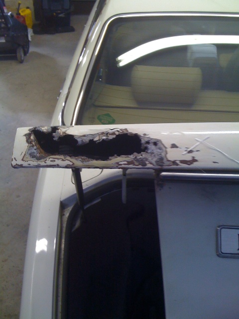

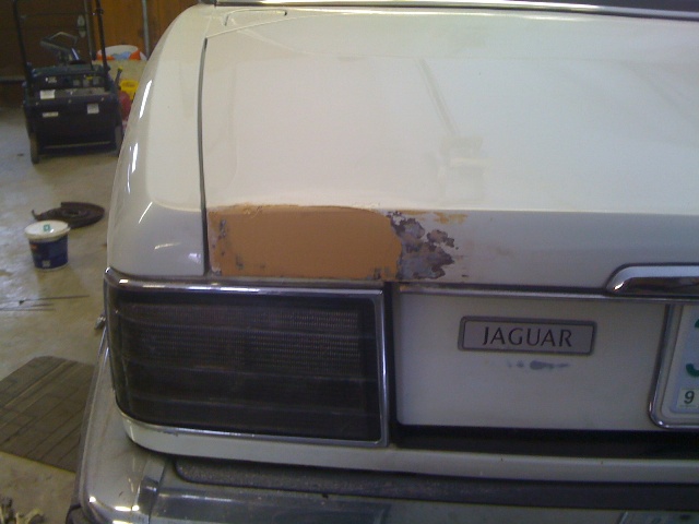

Default Pandoras Box
Yes, you were correct, fuel pressure led to the fuel pump. So prior to that I changed the fuel regulator and a new fuel filter. THEN I put in a new fuel pump. Bingo. Explosive start within 3 tenths of a sec, each and every time.
So it goes since I got it. New pads and rotors and hardware for the front. 2 new entire wheel hubs to replace the bad ones in the rear and front. And check out what was beneath the little bubble!
Attached Thumbnails 90 Sovereign into the family.-rust1.jpg   90 Sovereign into the family.-rust.jpg   90 Sovereign into the family.-rust5.jpg
