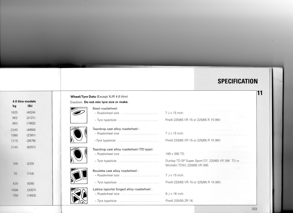

Checkout the post from luvmyjag on the XJ6 forum, dated 09 15 2009. This will give you some ideas. But Pirelli are the only manufacturer still supplying 225/65/VR 15
