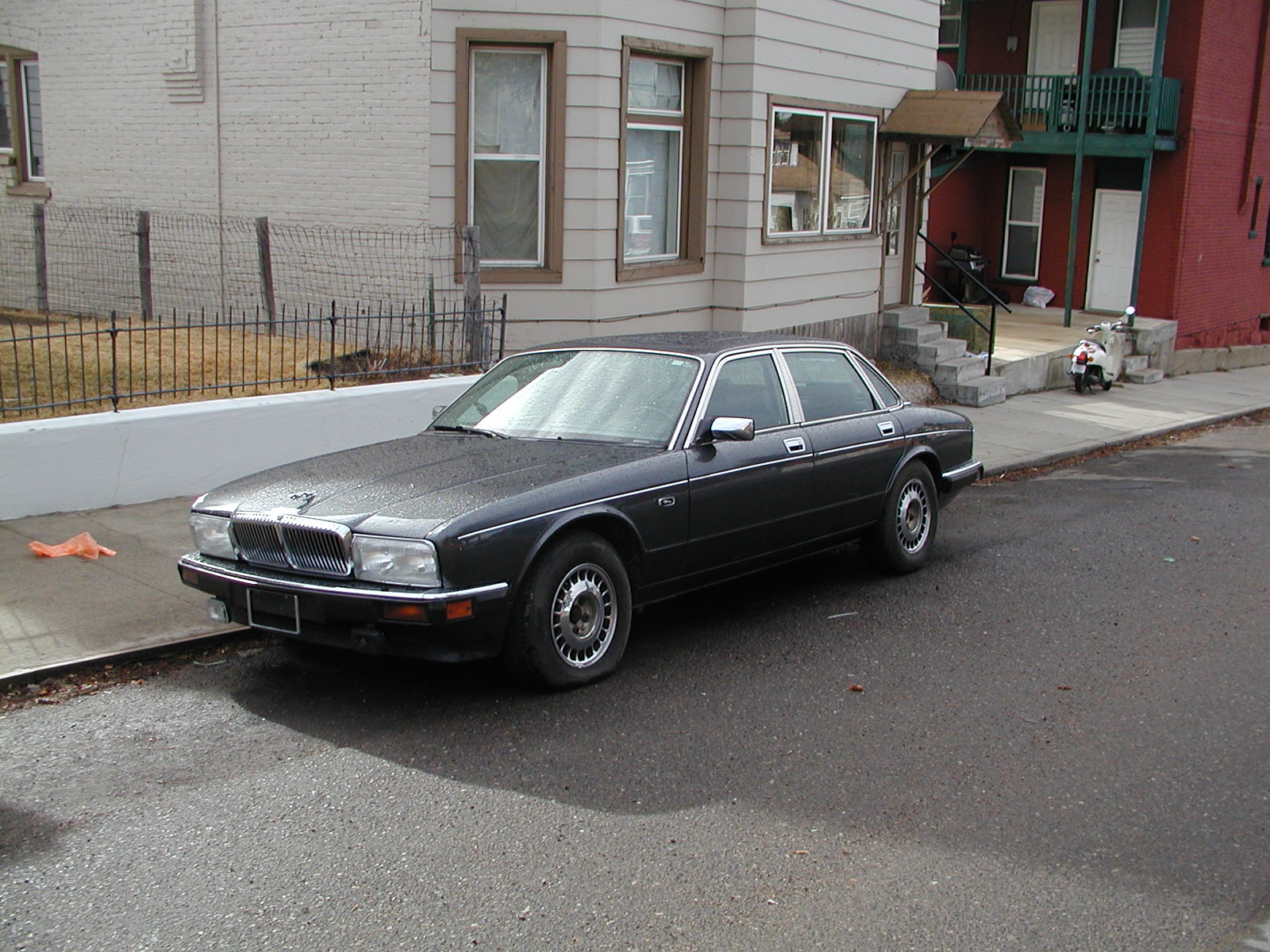

Another piece of info that might be helpful. If I let the vehicle sit for an hour or two after trying to start it and try to start it again the vehicle will fire and sputter for a second. (could I be leaking enough fuel through the injectors to cause this?)
