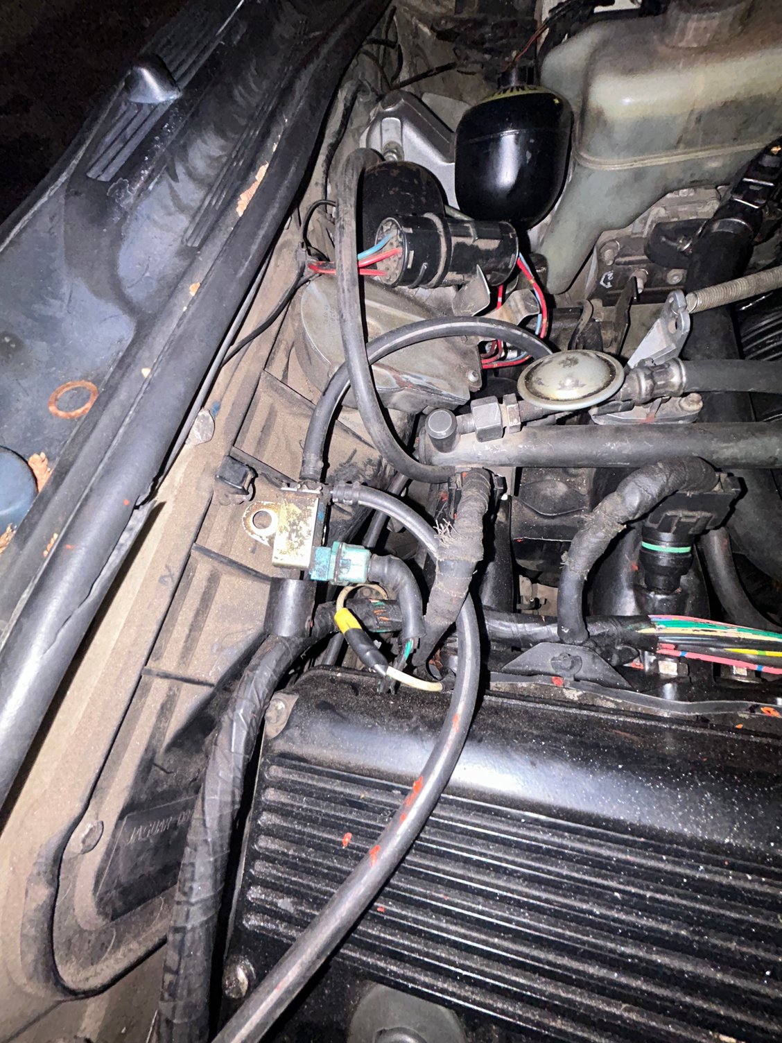

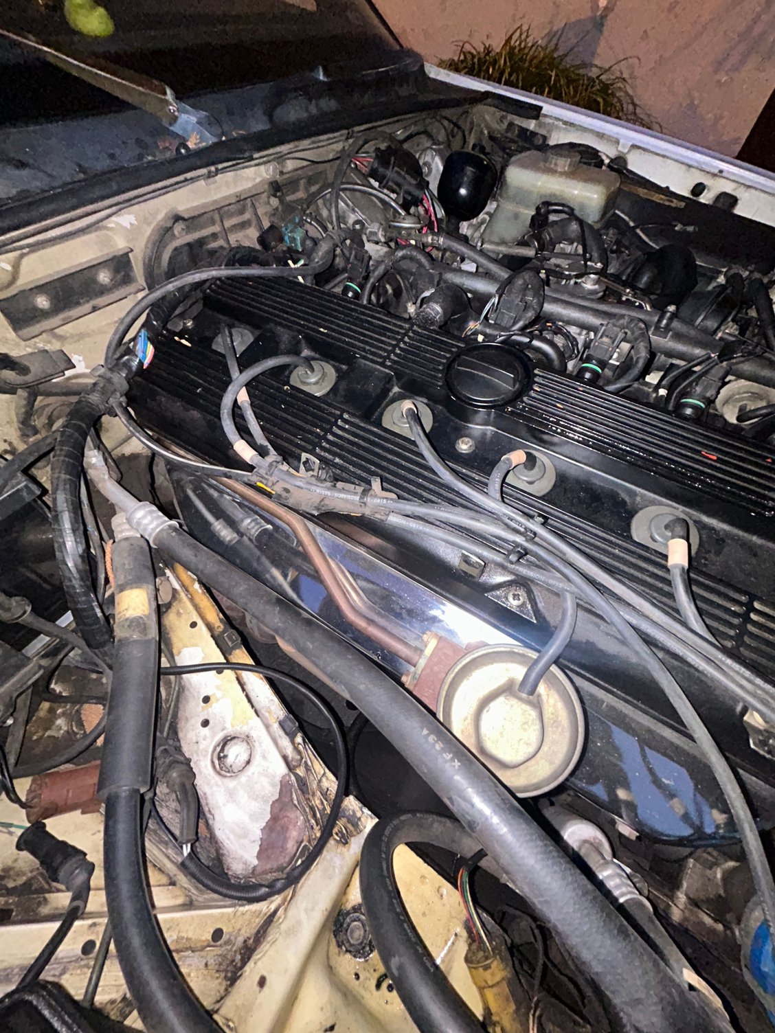

Constant. I uploaded some photos if that helps. Egr “seems” ok.

There are a lot of things it could be and fuel may be one of them. If its making a lot of noise try using a chunk of heater hose as a stethoscope to try to pinpoint the origin. That would go a long way to narrowing your search. You can also try using the old carb-cleaner-test. With the car running CAREFULLY spray the cleaner over intake and vacuum lines the to see what will affect the running either good or bad. Or If the car has been sitting you may just need some fresh gas and a clean out of the intake parts. Good luck!

I am a bit suspicious about the very clean cam cover. Has somebody been washing down the engine?
Those plug lead grommets are not waterproof. They do have a breather hole
Check to see if you have any water down the plug holes.
I ran across this in an XJ40, and it was flooded in a couple of the plug valleys but still ran roughly. The owner had washed it.
Jaguar have a technical service bulletin about not washing these engine bays primarily based on possibly creating electrical problems but also affecting other parts.
