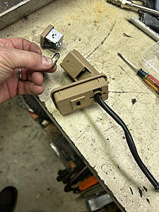

I dug one out from my parts abyss, here are my findings- help fixing back seats reading lights-photo898.jpg

It sent too soon, sorry. The bulb in mine is Definitely used up but it's easy to get at- the wire lead is only about 6" long so maybe if the headliner was redone, they neglected to plug it back in? Go with the bulb thing first.

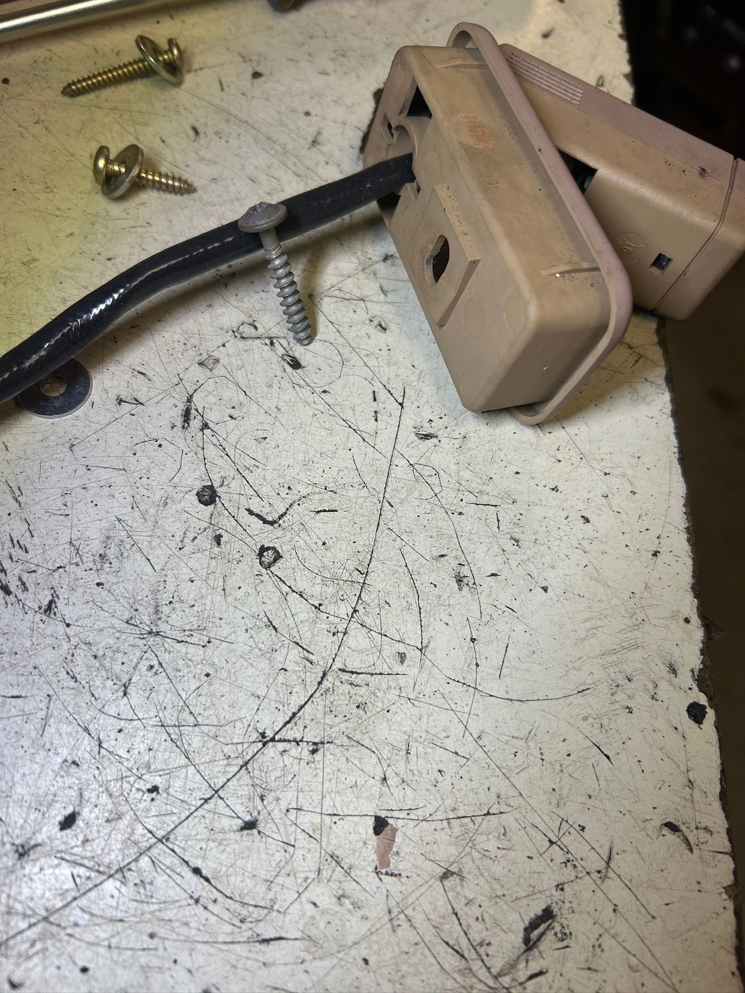

Hello again. I have gotten back around to these lights on my deep dive into the interior. I did the unthinkable and (gasp!) Looked at the grommetty things that the lights mount to. I concluded that they are deep "captive nuts" and that it just takes a longer slightly wider screw than I had imagined. Why they are deep like this is a mystery to me, but I'm sure there was some reason at the time. It also explains why I dont remember how I removed them.
the phosphored screws are what I had intended to use, but the grayish one is the one that worked. It may be 1-1/2
the phosphored screws are what I had intended to use, but the grayish one is the one that worked. It may be 1-1/2" long.
