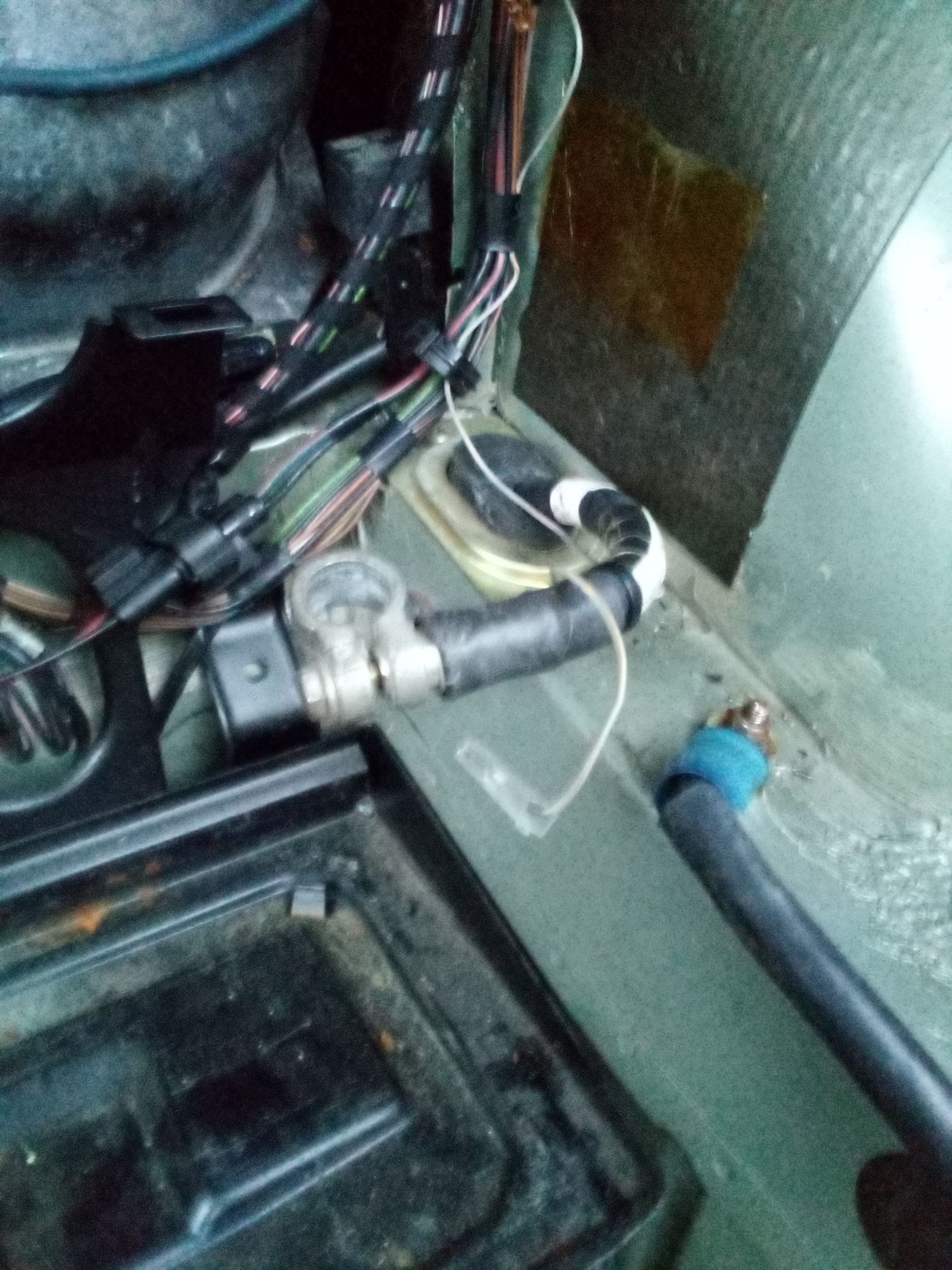

theres a fuseable link connected to my battery but nothing to connect it to what does this mean
this is my positive battery cable

Hi Jmains 123
Maybe its me!
But that looks like the Battery Set up on an 6 cylinder XJS 4.0L rather than a V12
Please could you confirm that your Car is a V12 and not a Straight Six 4.0L

Hi Jmains123
It looks like you've got the 6 Litre V12 and not the 5.3 V12 in which case I'm not familiar with the Electrical System on these
So hopefully someone else will be able to help
