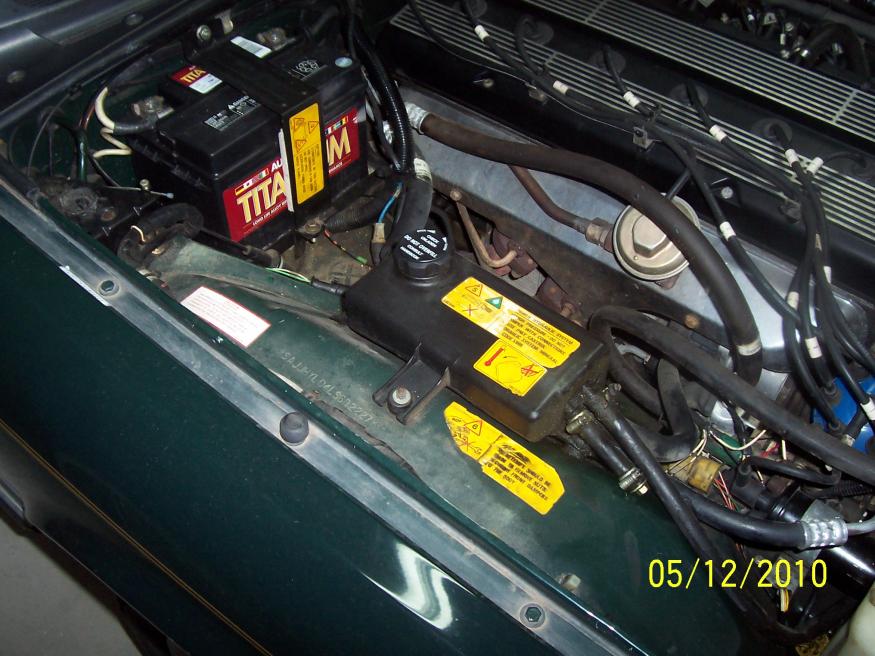

I've attached some pictures of the reservoir. It is for the power steering and rear ride leveling system. All the manual states is to use Jaguar HSMO. As I said, the fluid in my Jaguar is a golden color and the fluid that the dealer sold me is green in color.
Attached Thumbnails Tempting, but...-rt_side_of_engine_bay.jpg   Tempting, but...-closeup_phs_reservoir.jpg
Old May 13, 2010 | 02:19 AM
  #38
You got me checking into this for my 92. I had not really thought about it before now.
Well we have the same tank.
Looks like my 92 has had the wrong fluid in there ever since I have owned it, 7 years and 60k later. My dilema now is, do I drop and flush the PS system, which is working fine, or do I stick with it and wait until I need to?
The Castrol 5966 fluid has been discussed quite a lot through the forum, if you do a quick search you will see various threads.
Also had a look off site, this might interest you. Mineral Oil.
Apparently the correct stuff is green, so you have been supplied correctly. My 92 is wrong.
