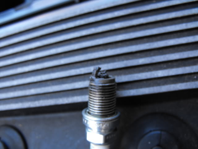

My second problem is MUCH more severe. As I was driving the other day I heard a pop and my oil pressure started to act all weird and my idle was not consistent at all, so I got it back home and drove extremely gingerly. I did a compression check and as I pulled the spark plug out of number two I noticed I had huge problems. The wire end of the spark plug was gone, only the part that was left was the part that goes straight up, the curved part was gone. All of the cylinders had good compression but number 2, as in 0 compression. I took my flashlight and noticed there is a hole in the top of the piston. My heart sank and my stomach has been upset ever since. What options do I have?

WOW, this the first time I've heard of an AJ6/16 failure. Wonder what in world cause a hole in the piston?

I have no idea what caused it but this is what the spark plug looks like in #2. Sorry for the delayed response for some reason it took my subscription off....

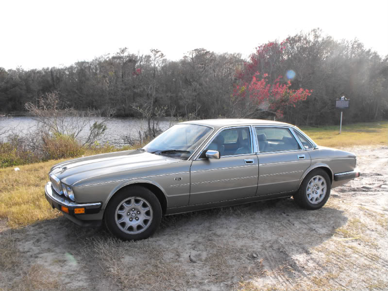

The car is in pretty good shape otherwise. If I was to just sell it as it is is, what would I be able to get out of it any ideas? Here it is really dirty, sorry, and it would not come with these rims.

Truth is these cars are not worth much even when they are running.
Yours looks pretty nice though, and it would be a shame to just dump it, IMHO. Get a good used engine, or another XJ40 with a good engine, and swap it in.
