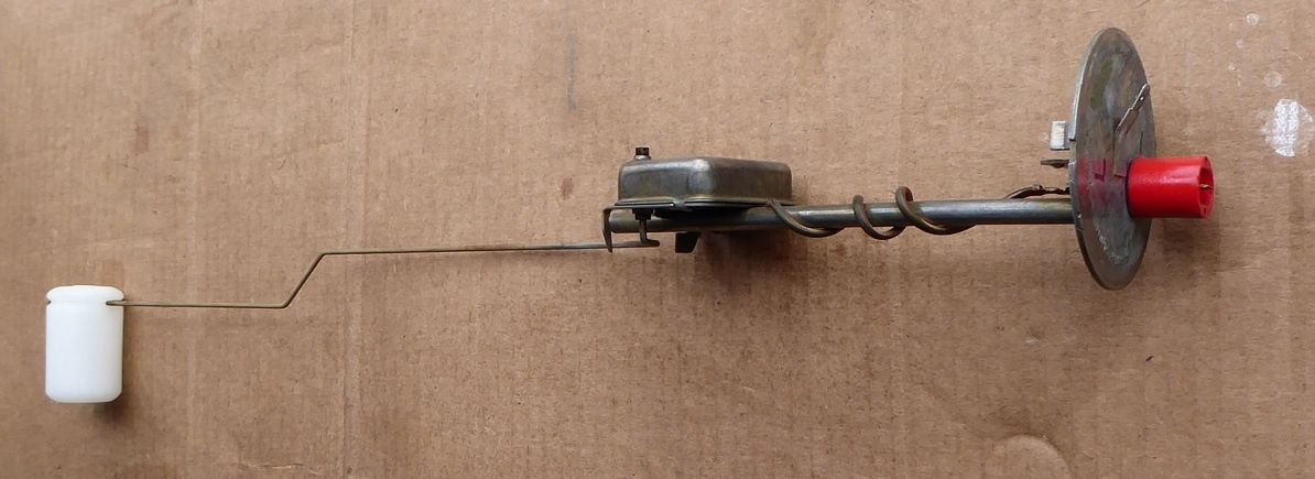

When I replaced my floats I managed to install them both backwards the first time so I feel your pain ! They jammed inside the tank. I THINK you can remove the senders with a couple gallons left without spilling out, I did by mistake, but be careful !
Here are some pictures of my original senders and the Jeep CJ6 floats that were a perfect fit ! Cleaned them by soaking in "cleaning vinegar" ( higher % than cooking ).
Red socket is left, white is right. 18 ohms full - 250 empty.
They both mount the same way = round insulated wire connector ( red or white ) to bottom, float arms at top and on both on left side ( facing front on car ). The arms / float mounting are the only difference, they are bent opposite directions.
Also shown, tool I made from PVC fitting + pipe section slotted with dremel to fit mounting rings.
Top ( red ) is uncleaned left, bottom ( white ) cleaned, both with bad floats. Custom tool for lock rings to left.
Left side cleaned with new float. Top up - as mounted in tank.
Floats for CJ6, perfect match !

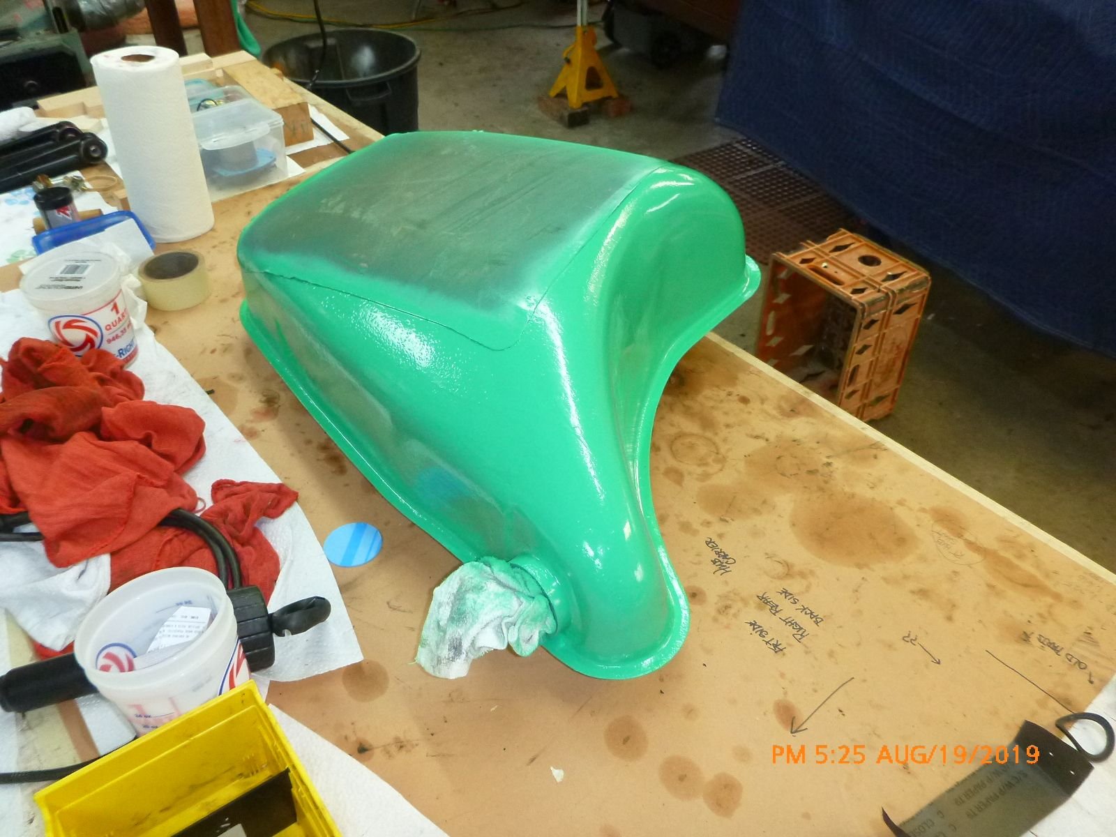

I'm with Jose on this one. I don't know if you've had the tanks out, so I sent a some-what helpful pic of one of my tanks when it was out. Sender is mounted about in a straight line from the roll of paper towels to the back of the tank (this is the high-tech description). Float would drop more to reach the bottom than rise to reach the top. I'm sure you have found out that the senders are "handed".
Dave
