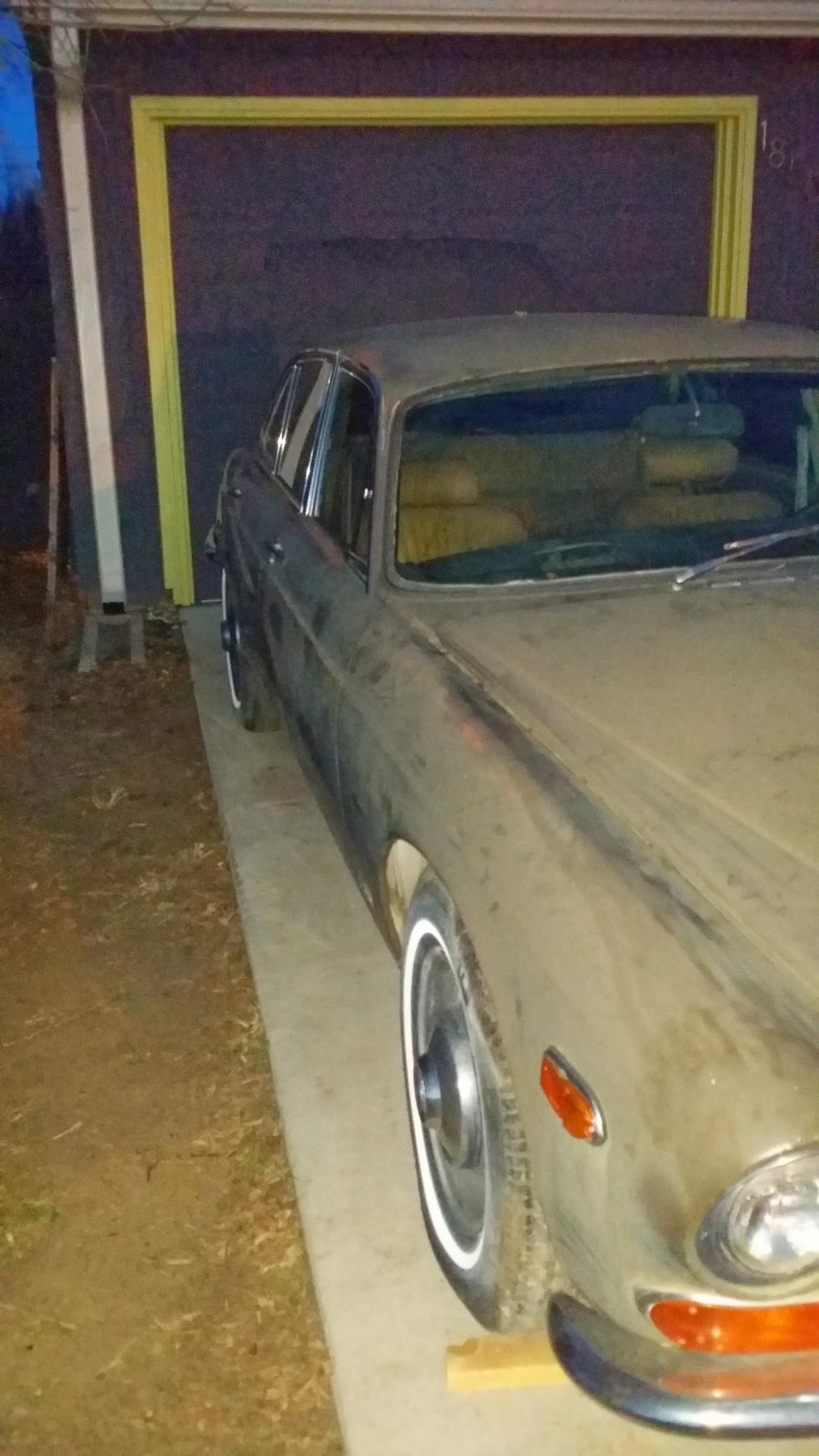

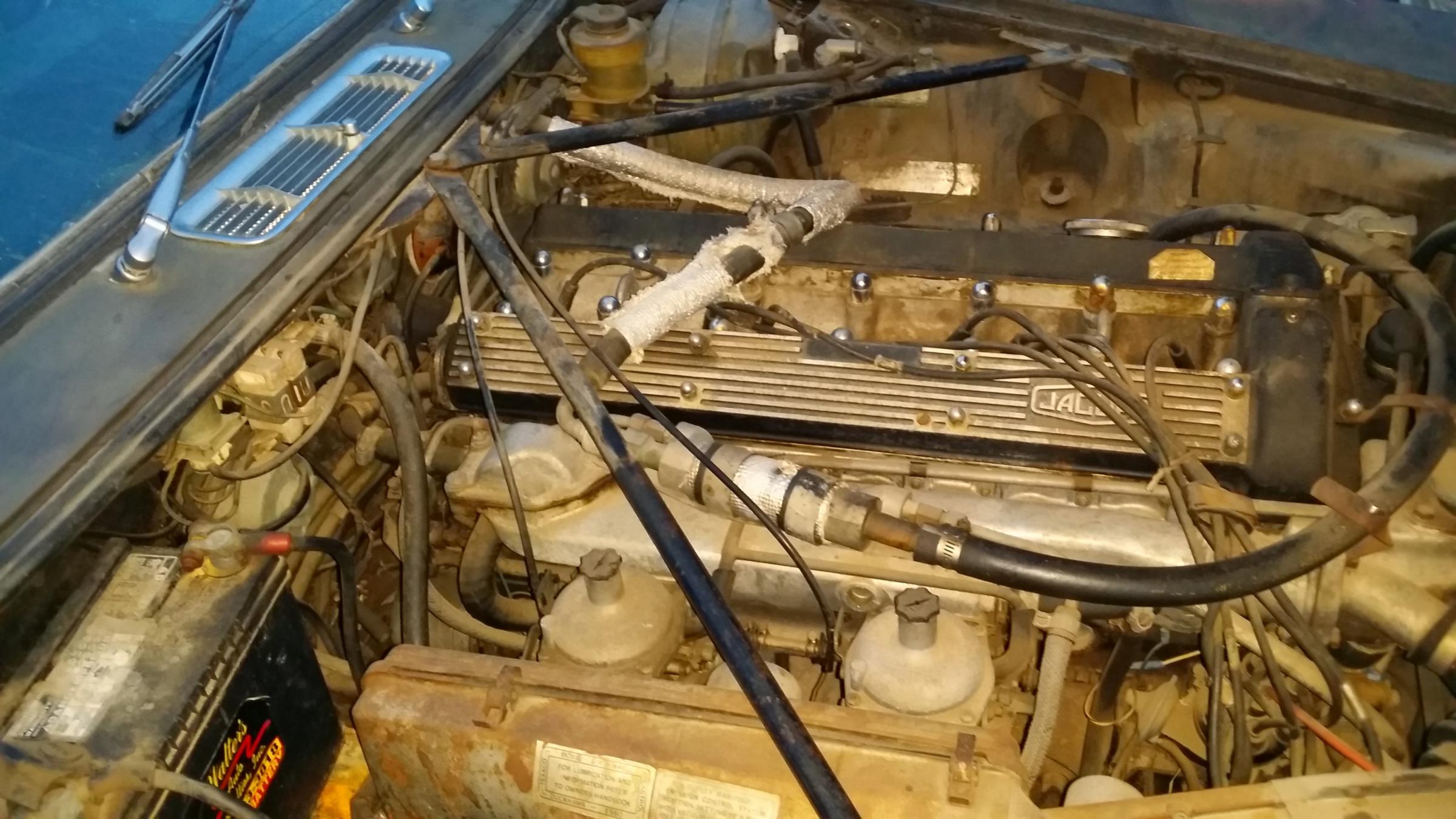

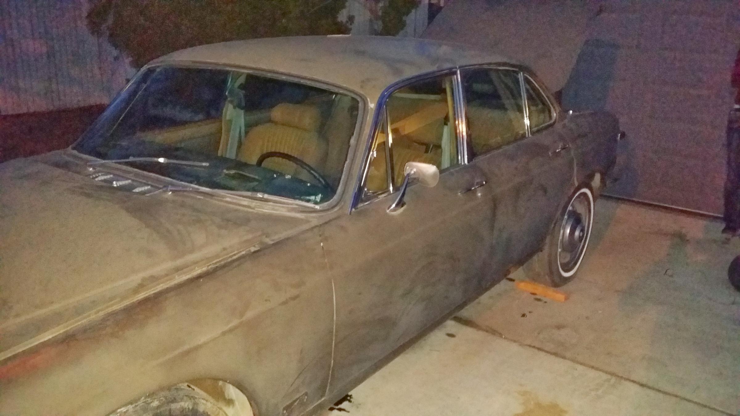

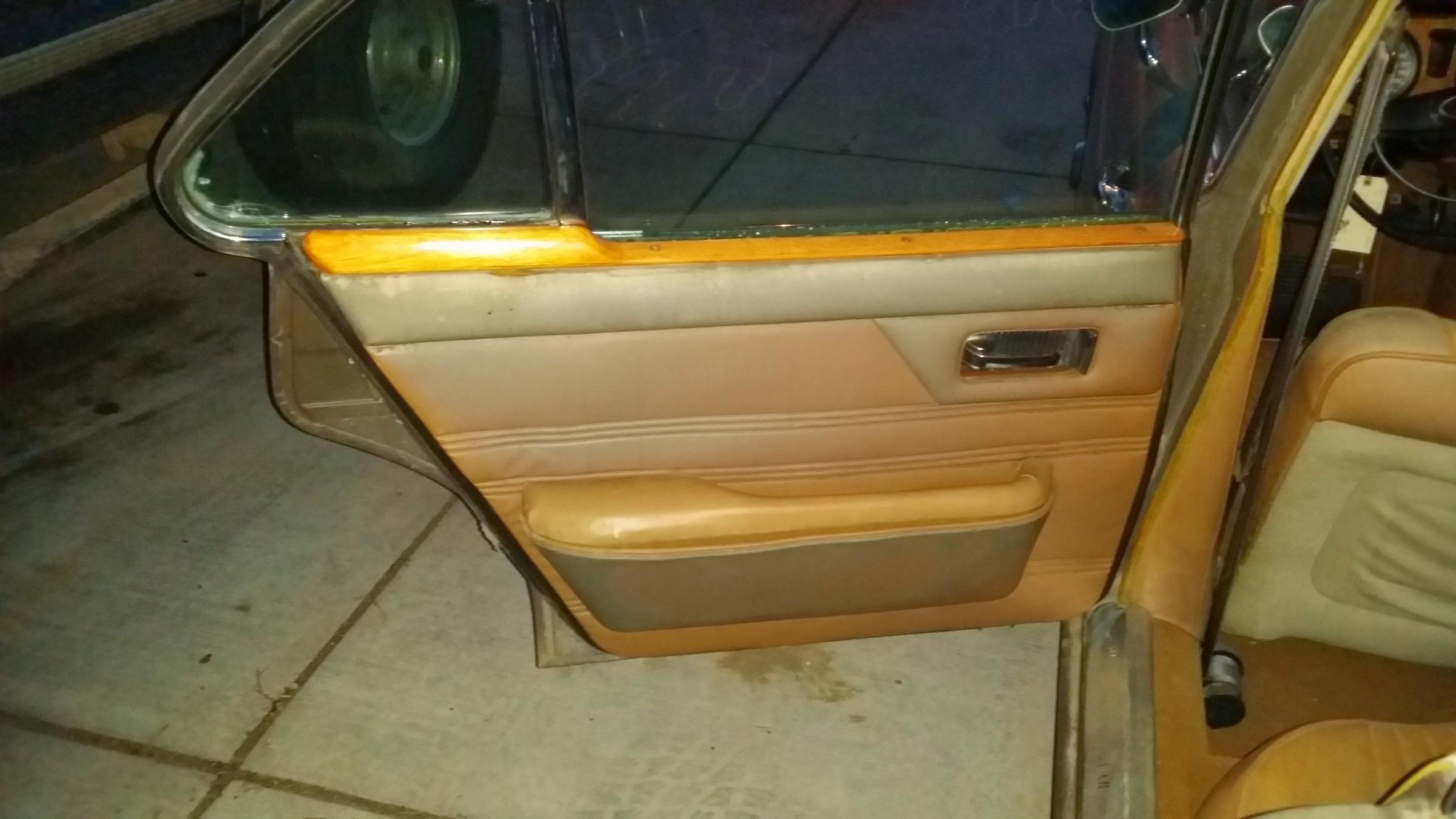

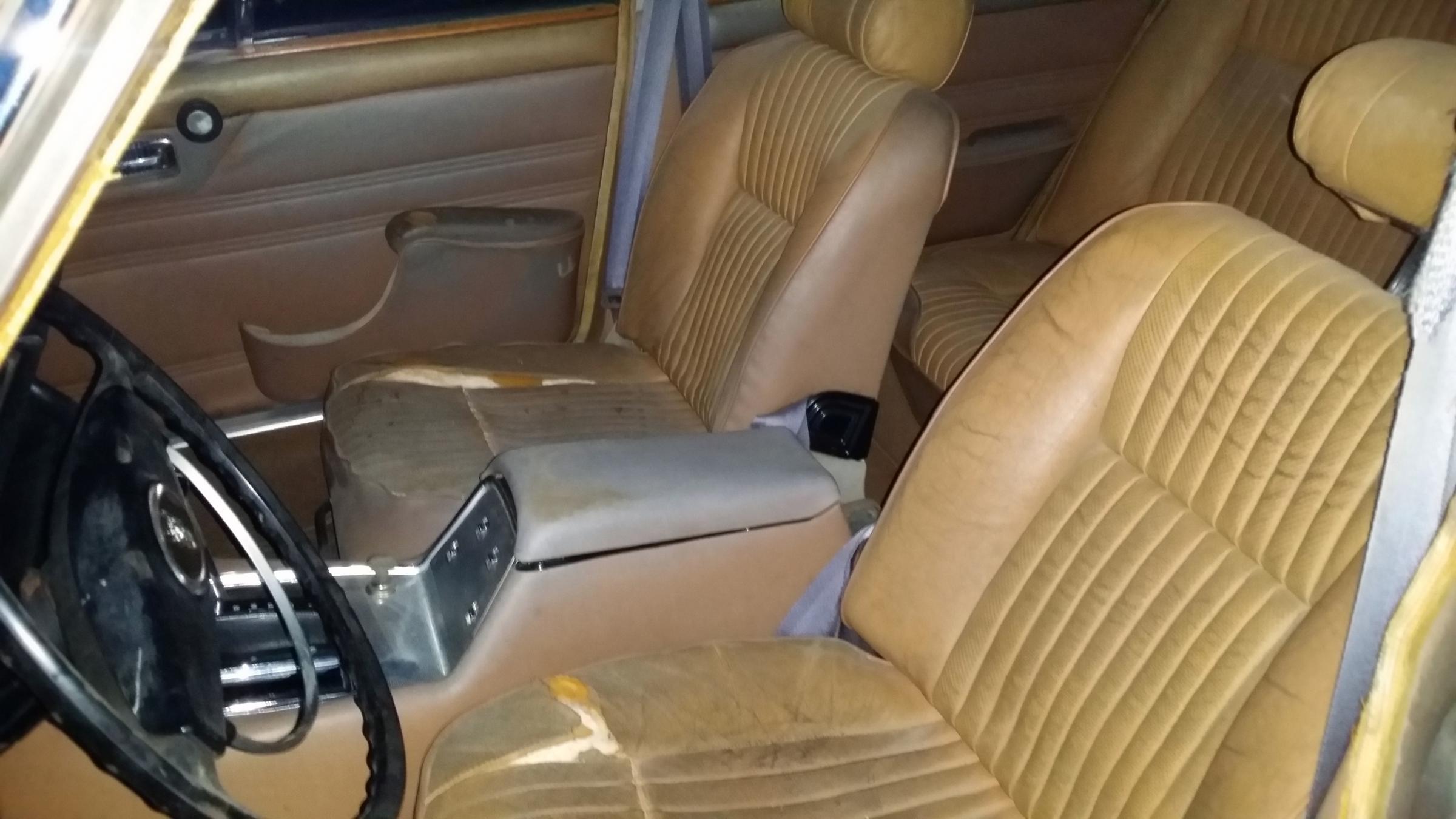

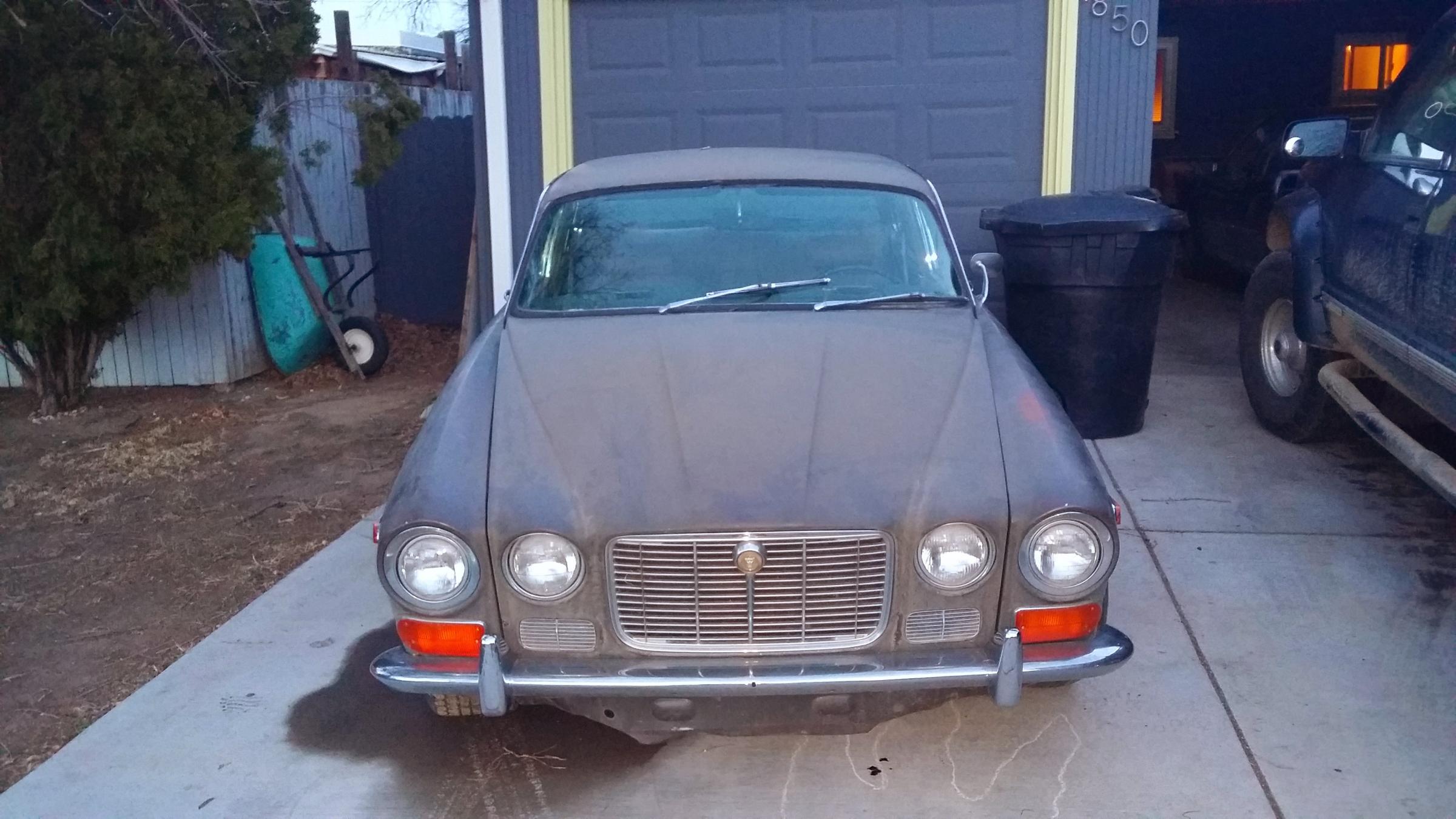

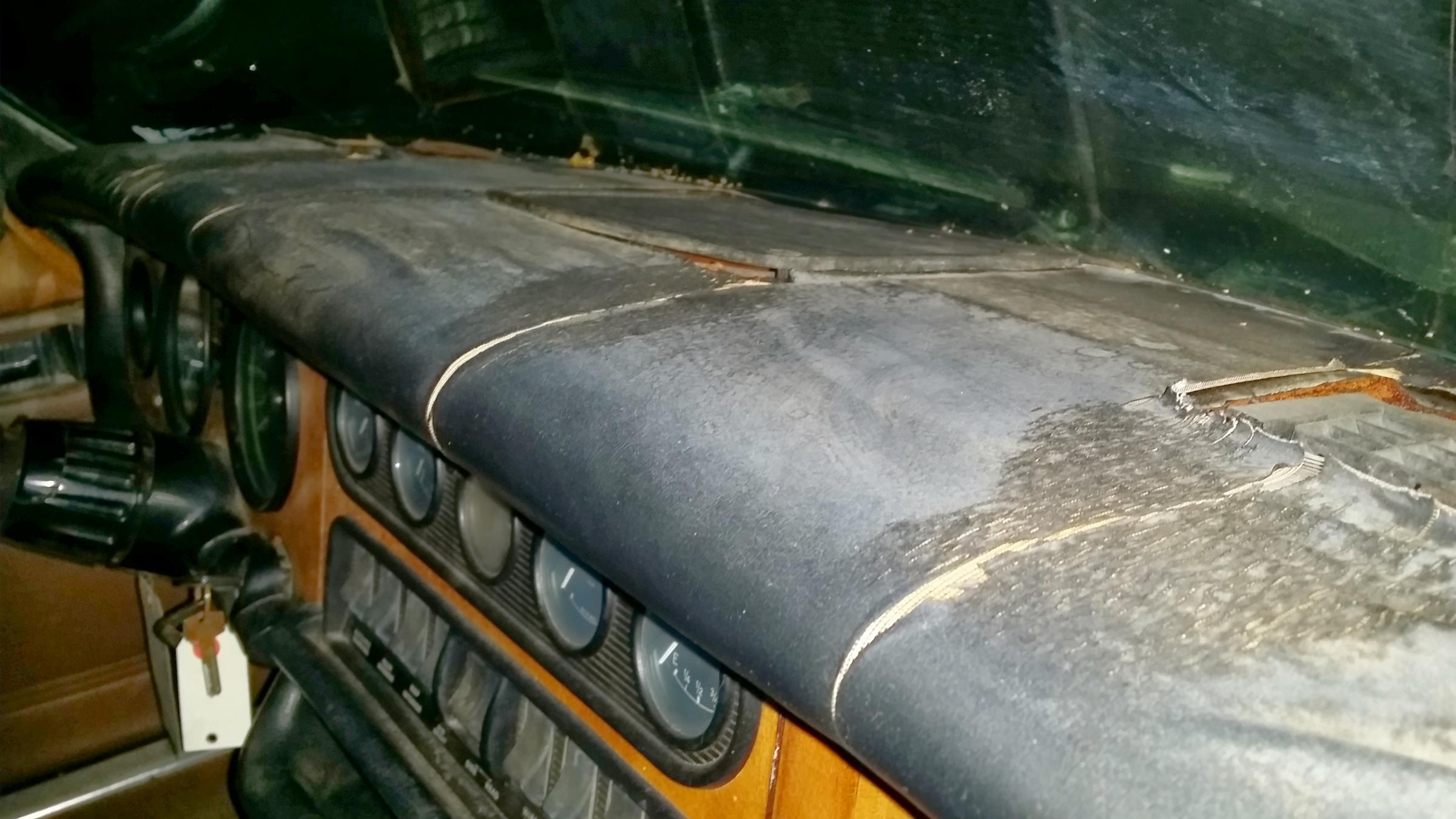

At the suggestion of Jose and the fact that I'll be seeking input on a fairly regular basis, I've decided to launch a build thread for my 1971 XJ6. The goal is to build a bit of a sleeper. I have no concrete plans on what this will transform into yet, but I am not a fan of doing a chevy conversion. Nothing against those that go the SBC route, but I've been hot rodding for long enough and the SBC in everything gets kind of tired and old to me.
I don't want to repeat too much of what I've already said, but here is the brief synopsis:
I just picked up a 1971 XJ6 that hasn't been on the road in many years. The body seems to be pretty solid with only minor rust issues (some in the rocker panel, some bubbling in the rear wheel well), but is overall straight and doesn't appear to have ever needed repair.

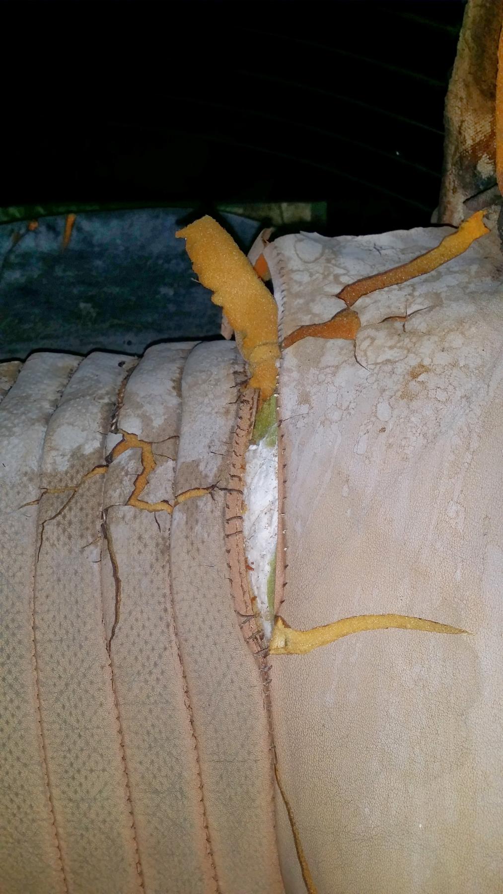

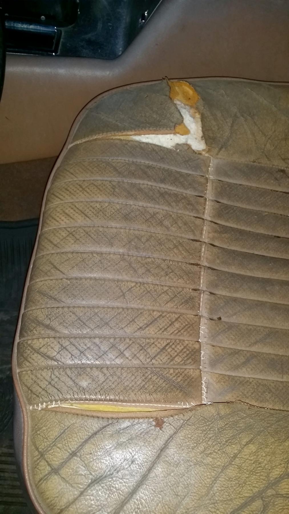

The interior is a different story with the front seats being good for pattern making and that's about it. Most of the rubber seals around the windows are dry and cracked.
Fuel tanks will likely need to be replaced and I'll be spending some time going through the electrical system.
Here is what I've learned as of 3/19:
1. Engine freely turns over, builds oil pressure while starter turns
2. Very little works at the moment in the electrical system
3. Gas tanks are SHOT and need replacement (either keep the dual tanks or fuel cell)
4. Interior will be quite the project

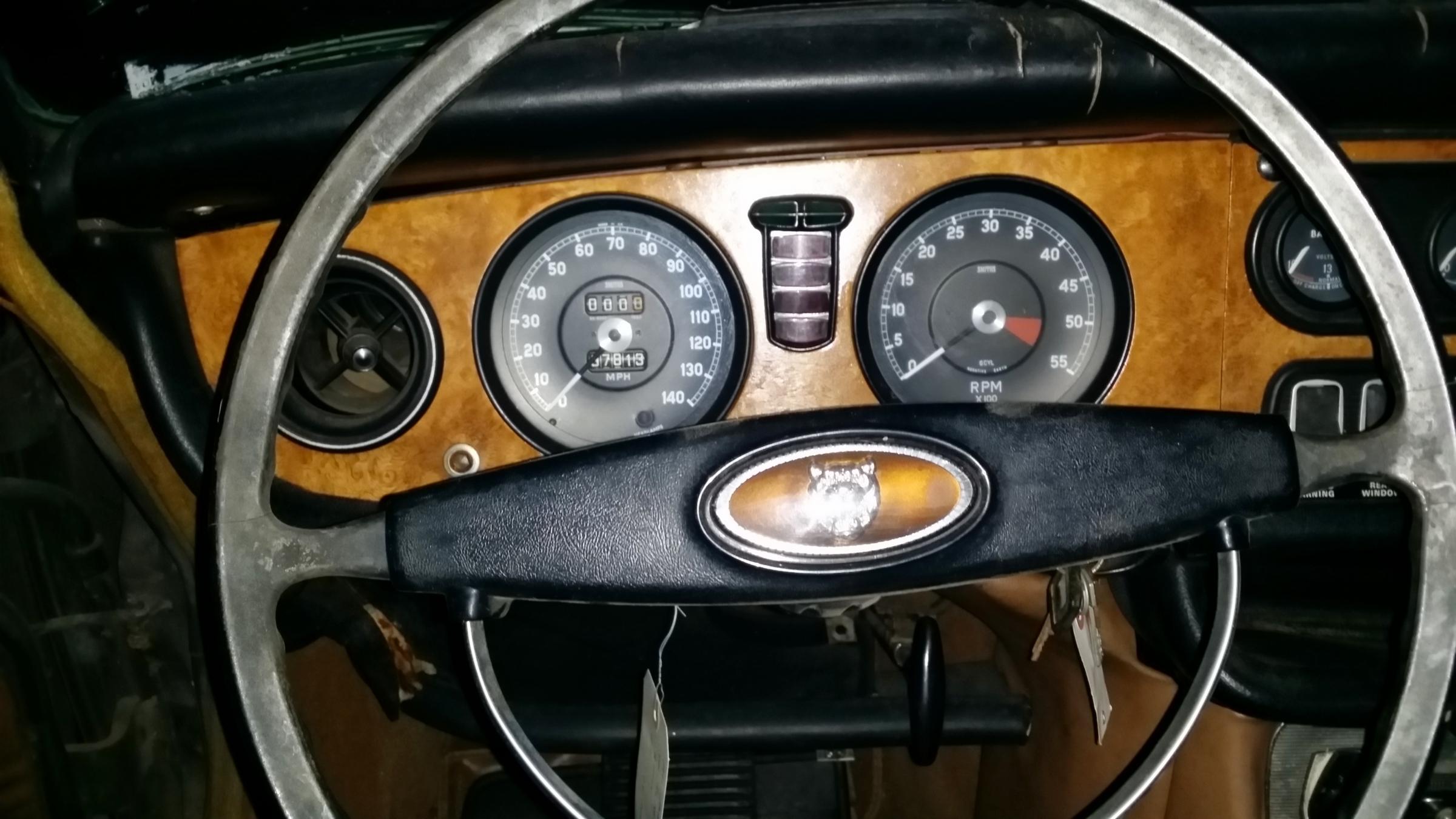

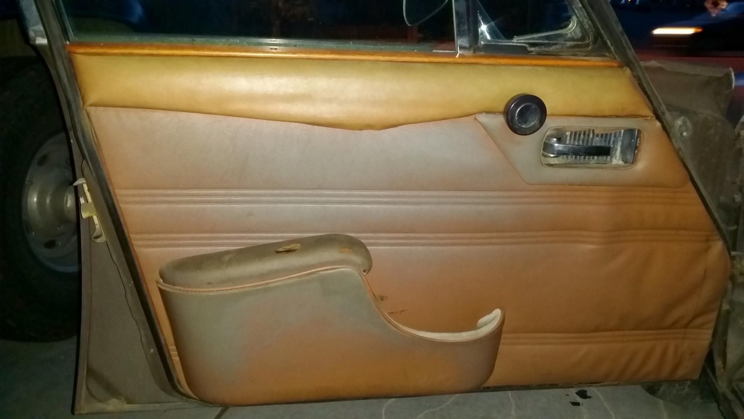

Some before pics:
Attached Thumbnails 1971 XJ6 Build-20140317_191820.jpg   1971 XJ6 Build-20140317_193420.jpg   1971 XJ6 Build-20140317_193430.jpg   1971 XJ6 Build-20140317_193355.jpg   1971 XJ6 Build-20140317_191618.jpg
1971 XJ6 Build-20140317_191631.jpg   1971 XJ6 Build-20140317_193010.jpg   1971 XJ6 Build-20140317_193022.jpg   1971 XJ6 Build-20140317_193030.jpg   1971 XJ6 Build-20140317_193103.jpg
1971 XJ6 Build-20140317_193110.jpg   1971 XJ6 Build-20140317_193118.jpg   1971 XJ6 Build-20140317_193138.jpg   1971 XJ6 Build-20140317_193145.jpg   1971 XJ6 Build-20140317_193151.jpg
1971 XJ6 Build-20140317_193200.jpg   1971 XJ6 Build-20140317_193231.jpg   1971 XJ6 Build-20140317_193247.jpg   1971 XJ6 Build-20140317_193238.jpg   1971 XJ6 Build-20140317_193324.jpg

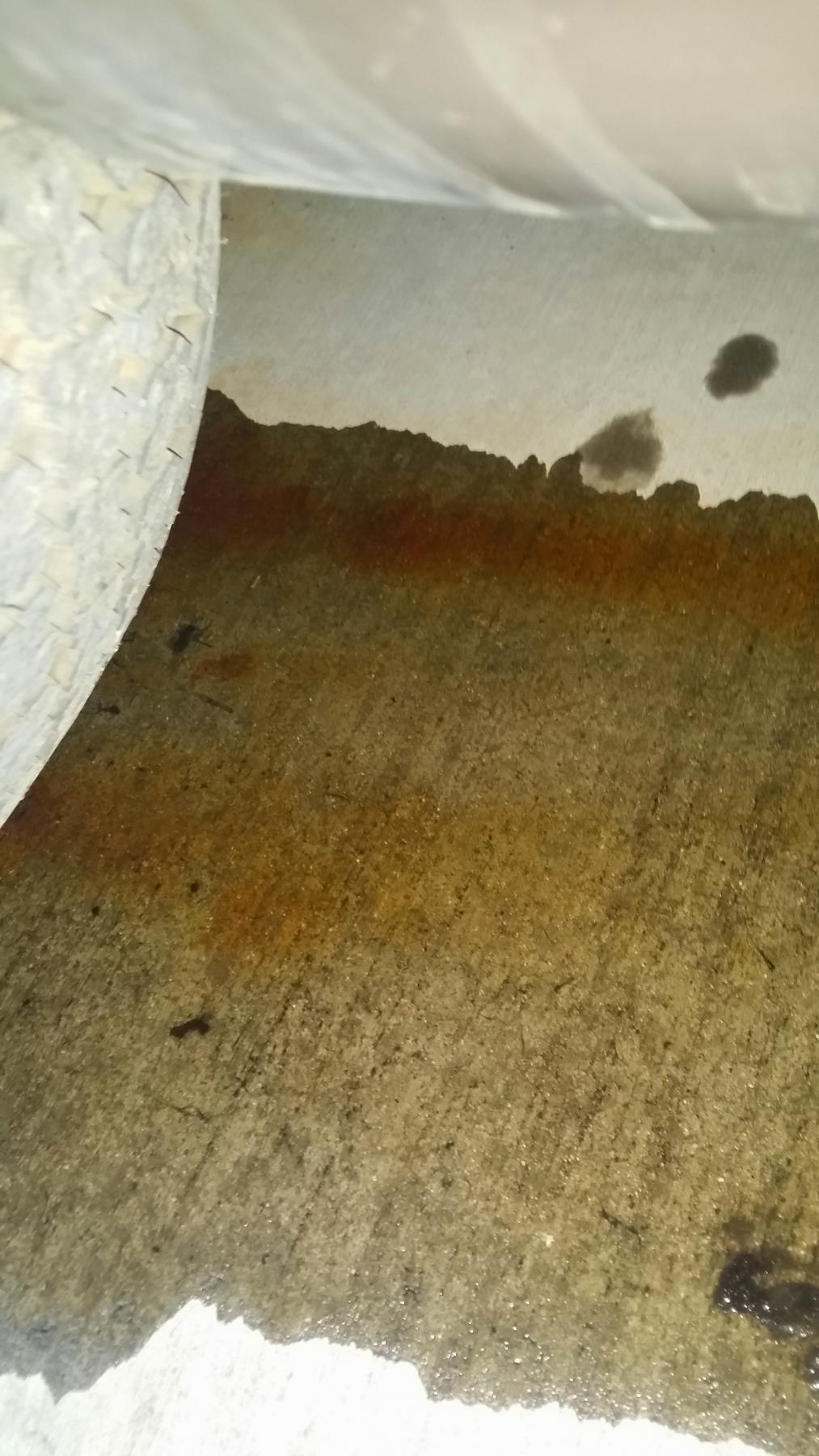

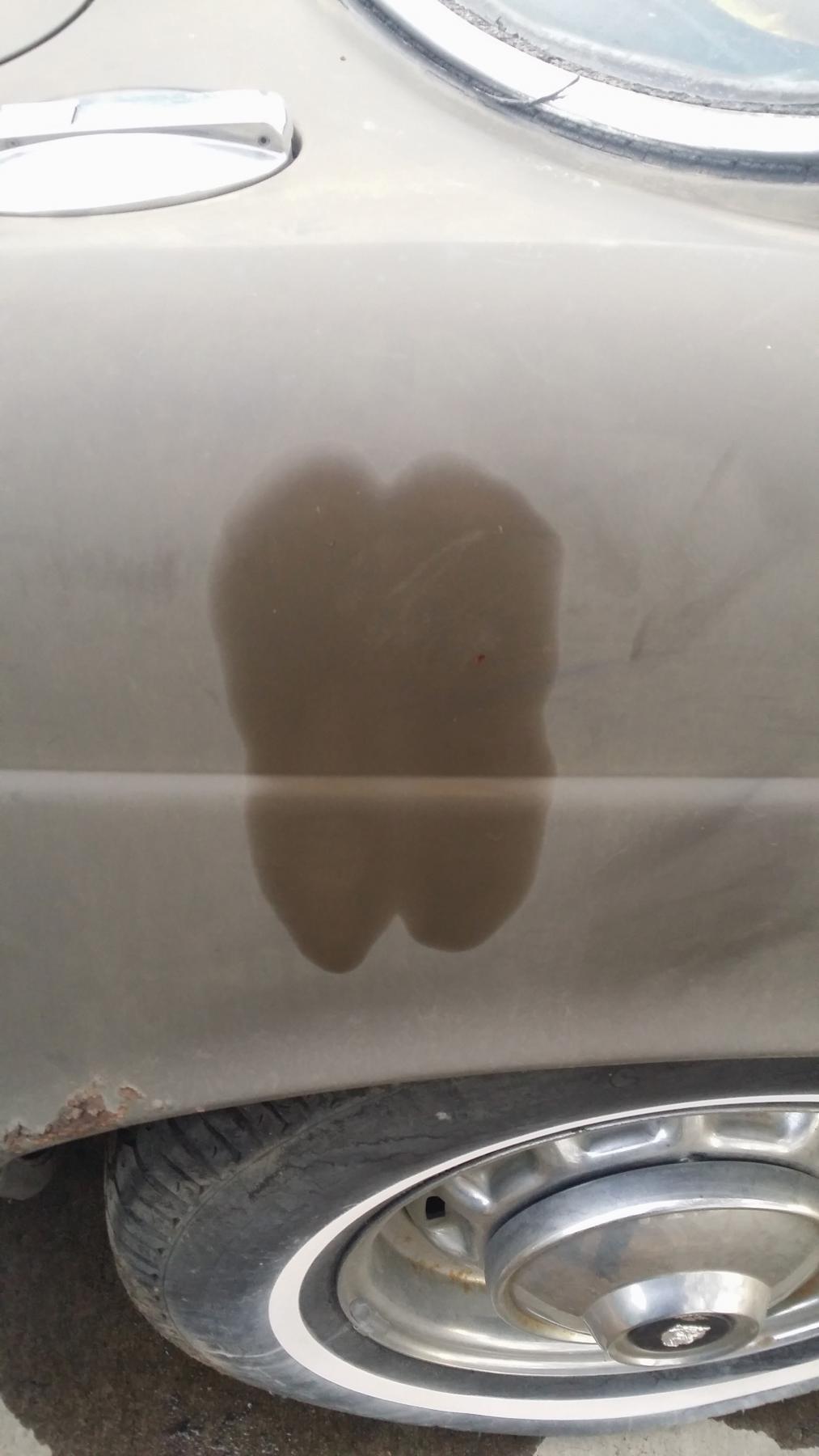

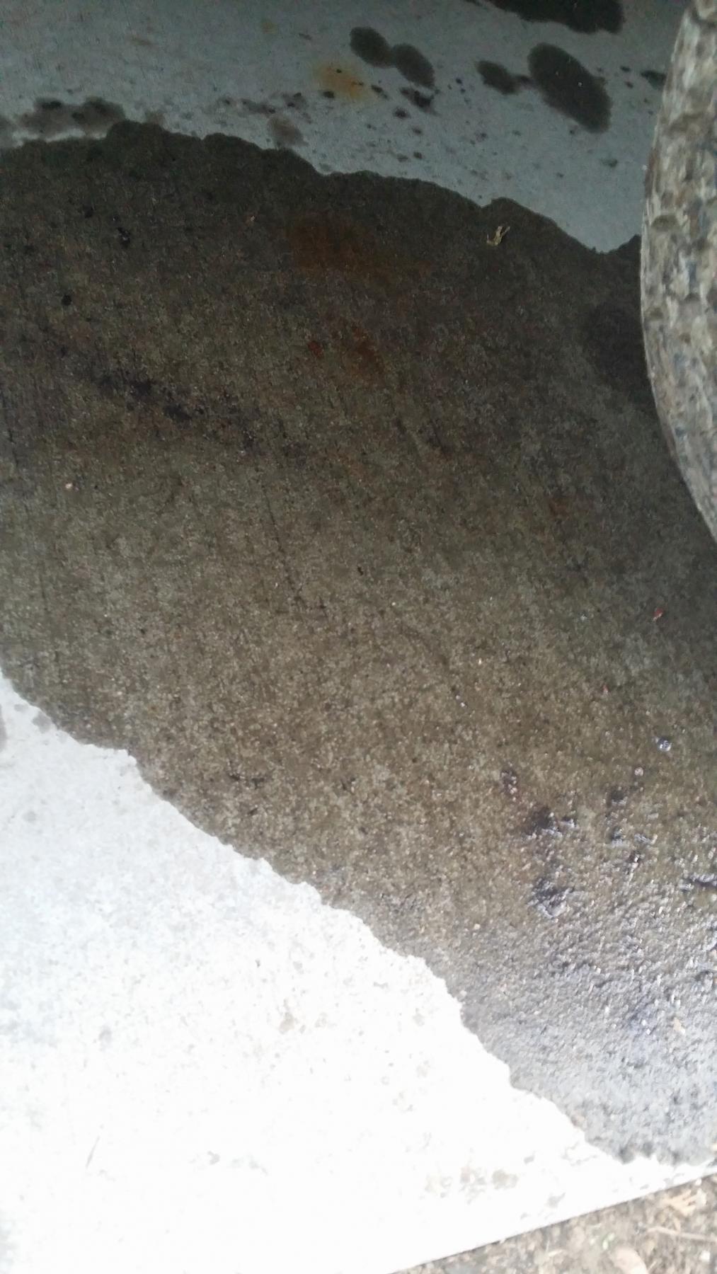

Despite my intention to modify, my very first priority is to get the vehicle up and running under its own power. I've been studying up on the shop manual that came with the vehicle (circa 1972!). After being encouraged by the fact that the motor turned freely and looked to be in better shape than I was expecting, I rrdered up parts to start refurbishing the brakes, ignition, fuel system and some electrical bits.

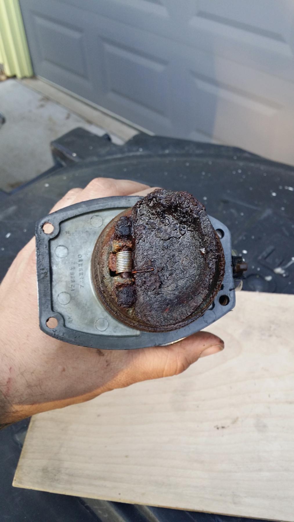

Sadly this may have been premature as I was greeted by this when I got home:
Attached Thumbnails 1971 XJ6 Build-20140319_171411.jpg   1971 XJ6 Build-20140319_181840.jpg   1971 XJ6 Build-20140319_181845.jpg   1971 XJ6 Build-20140319_181856.jpg   1971 XJ6 Build-20140319_181906.jpg
1971 XJ6 Build-20140319_181912.jpg   1971 XJ6 Build-20140319_182127.jpg   1971 XJ6 Build-20140319_182134.jpg

Yeah, I'd say those fuel tanks are toast alright...I just started to refurbish my seriesII - I will check in on your build and see how it's going and cheer you on when you come home to things like that. I have some parts that you may need/want for the interior. A nice dash pad for sure. I'd have to check my pile o goodies for other stuff.

keep the two tanks, you might get them restored or get two new ones.
other than the Dash Cap, the dash itself looks good.

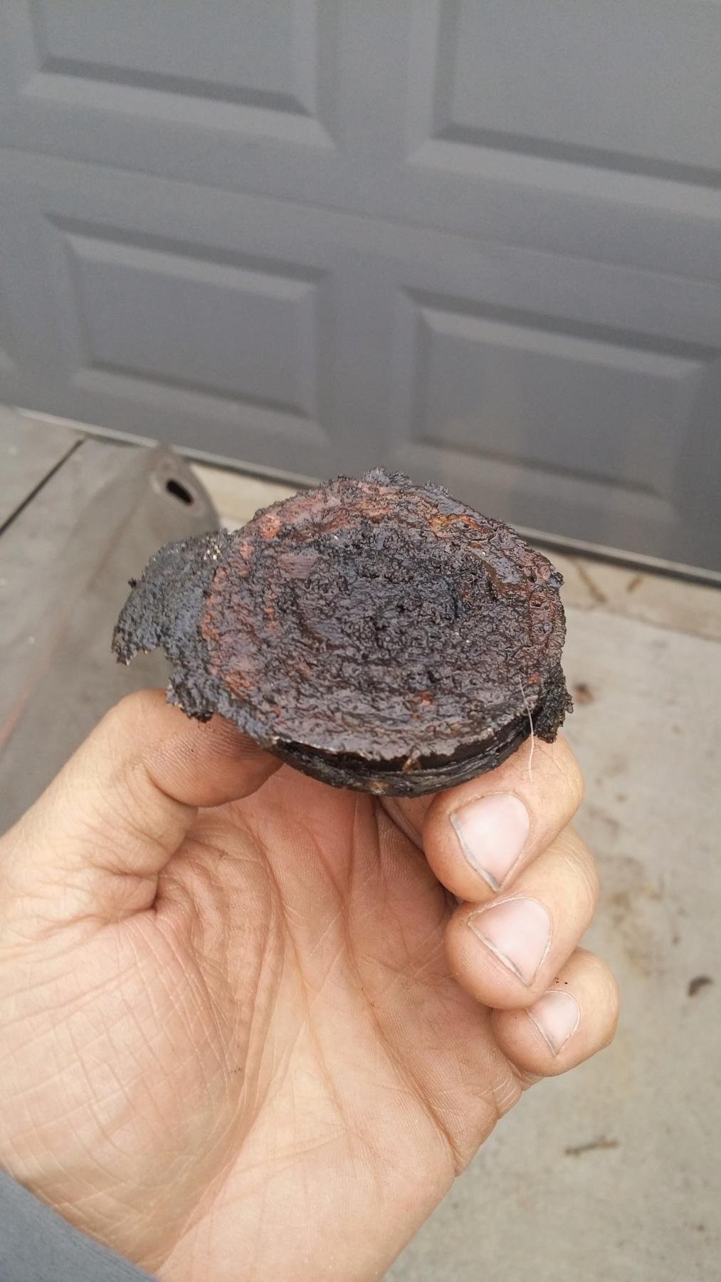

The tanks I'm pretty sure are toast. The right tank drain plug didn't take much effort to remove as it took what little was left of the tank with one twist. The left side might be repairable, but I'm not too confident. I'll pull the tanks on Sunday (next chance I have to really work on it). In the meantime I have brake parts, ignition, and some lighting on its way. Should keep me busy.

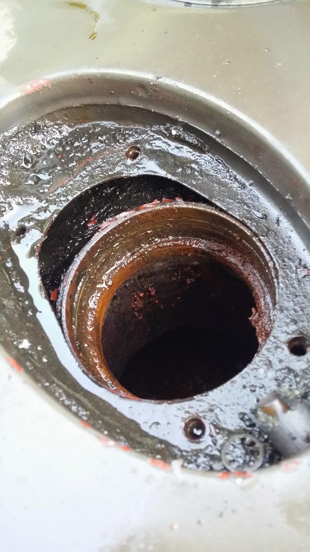

SUCCESS!!!

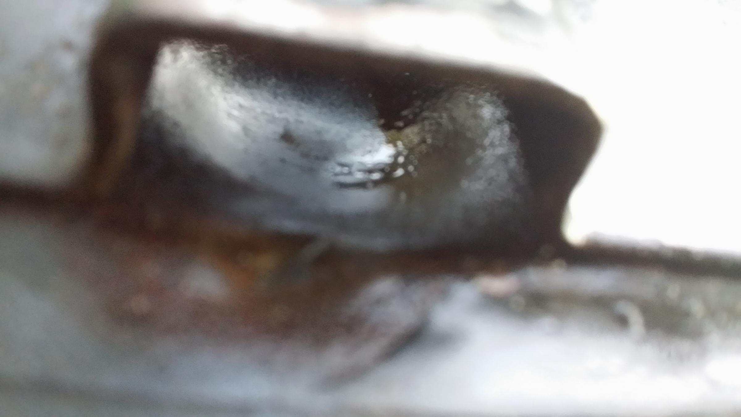

Took some WD-40 and blasted the ever living snot out of both filler necks. The RH filler neck came off fairly easy and with no tools needed (thankfully). The LH side however took a lot more effort and got a few parting shots in (time to bust out the body hammers while the tank is out....) but eventually succumbed. If there was a rubber o-ring between the tank and the filler neck, it had long since disappeared which probably explained the stubbornness of this project
I dropped the LH tank since it was the most promising and well, now I'm not too sure. It did spring a leak in perhaps the worse place possible (underneath the mounting bracket for back bolt). I did drain the rest of the nasty rust colored liquid out of it and what is left sounds like sand rolling around in the bottom (likely massive chunks of rust). If I can repair this tank, then it might make the cost of replacing the RH tank an easier to manage, but given the leak and amount of rust, I may just have to call it a loss too.
As usual, pics attached!
