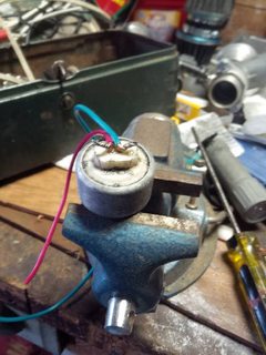

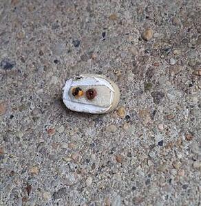

Didn't really want to start a new thread.
My speedometer was intermittent and jumped around like crazy so I drove her up on ramps and took a look at the transducer. One touch of the wire and it came loose. Of course the wire broke flush with the transducer leaving nothing to solder a repair to. Not wanting to spend for a new transducer, I carefully cut right through the plastic and took off a big enough piece to expose two wires I could strip and splice to. Now which wire goes to which lead? I decided to gamble and wired it up. No luck! back under the car to reverse the wires. This is why I don't gamble! Now it's working fine and only cost me a couple hours labor.
