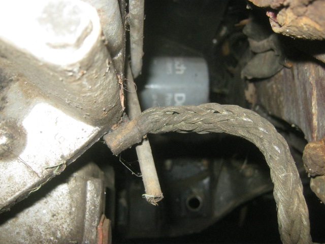

1987 xj6, where does the ac drain exit the vehicle, mine just drains on the floor, passenger side and I want to see if it is clogged

I guarantee your drain is clogged...
Look under the car, on the RHS, front side of the transmission, near the engine ground strap....
David
