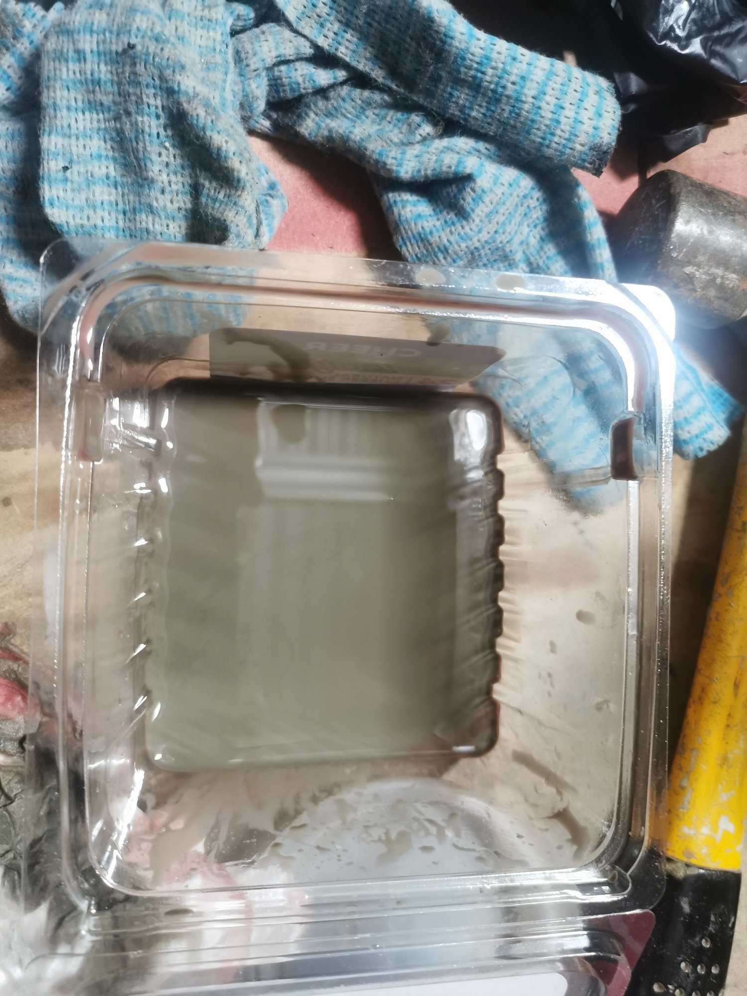

I checked the oil and coolant this evening. I saw some discolouring on the dipstick and when I checked the coolant it needed around 3 litres, way more then prevously. I extracted some oil from the dipstick (about 200ml) and the example of the oil extracted is in the picture. I assume coolant is getting into oil somewhere, thinking buggered head gasket?

I did check the oil yesturday and it was a bit fuller than normal (showing very full, was half way previous check). I thought the oil colour was not right, it was darker a couple of weeks ago.
This evening I will open the drain plug as you suggest Dave and check for coolant , and refill the coolant properly with Jose method (& change oil) and see what happens.

If your oil was "a bit fuller than normal" and "the color isn't right, was darker a couple weeks ago," that's a sure indication you have coolant in the oil. (Oil gets Darker with age and miles, not lighter.)
If you confirm this is the case by draining as mentioned, adding a Cooling System Sealant isn't going to fix it. Might seem to slow down progress for a while, but if one considers how this stuff works, by clogging up small water passages and thus maybe your leak for a time, then eventually you'll have clogged (at least partially) radiator and heater core, not to mention any small coolant passages in the head leading to eventual overheating. (I can tell you how I know this and what it cost me to fix it right.)

You are losing coolant into the crankcase, that's a problem. "Sealants" added to the cooling system won't solve any kind of problem, they will just make the inevitable repair job nastier and probably more extensive.
Have your new mechanic pressure check the cylinders and look for bubbles in radiator filler neck. I would say that your roughness after startup is very likely from coolant getting into the cylinder(s) over night. Pull the spark plugs before you start the engine in the morning and look at them (let it set for a couple of days if you can), crank the engine with the plugs out and see if you see any kind of liquid/coolant (green?) coming out of any of the plug holes. This would be a severe case, but adding 3qts of coolant and seeing the oil level rise from half way between full/add to "very full" (over full I assume) indicates quite a leak. Best to just bite the bullet and fix it.
