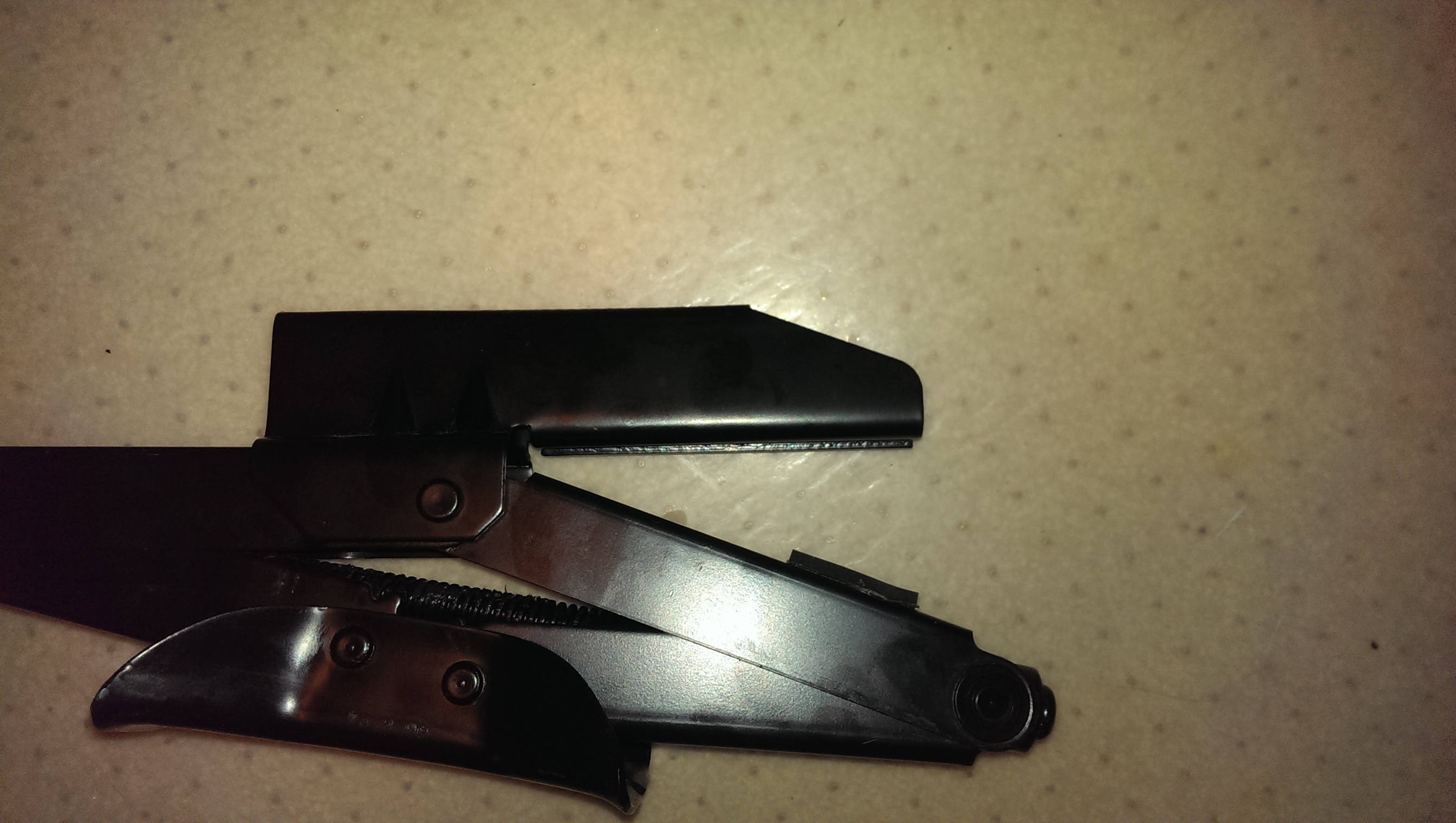

I now have the late model compact spare tire tool kit... the lug wrench fits the tear drop lug nuts of my wheels perfectly!
But, the jack is designed to work with the newer "square hole" type of lifting points. It does lift the car with the jack under the pins just sitting under the pins... but s to be "trapped" on the pin.
The photos show the jack from the side and the end of the lifting portion.
Found out that just sliding the slanted portion onto the pin all the way to the rear locks it sufficiently to hold the car solid. I jacked
up the RR wheel on concrete floor with no problem... it is easier to use a proper sized socket to do the turning of the end screw than
use the Jaguar tool included... just added a socket and handle to the tool kit as there is enough room and already has spare holes.
Attached Thumbnails Adapting a late model jack to early XJ pins-imag1846.jpg   Adapting a late model jack to early XJ pins-imag1845.jpg
