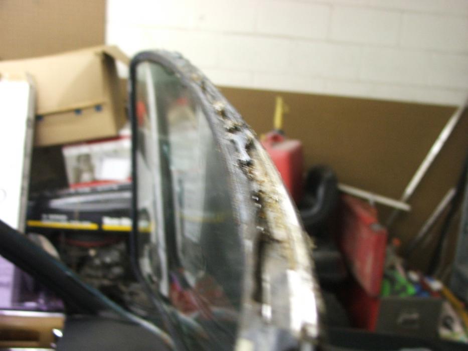

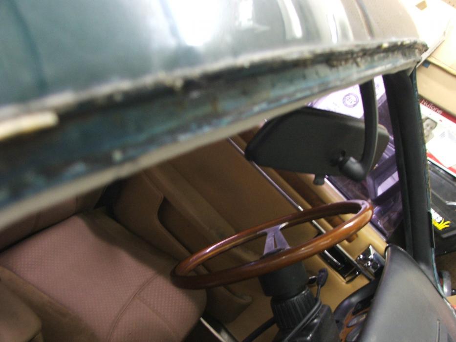

Fraser, here ya go, pics, i am assuming the rubber you are talking about is the one i am holding, still looks brand new, dont think the silicone, or whatever it is they used to quasiglue the glass in with even touched it!! all the rubber was new back when i had the glass out a few years ago.. i see some surface rust in the aperture where it all came out, but nothing bad, i have however stared to fiddle with the back glass and see some pretty bad rust..( same people did both pieces of glass!

Yes that rubber piece looks correct to me, (as I remember, as it is a long time ago!!). Your aperture looks in very good condition, in fact it is in amazing condition; there is normally a hole at each lower corner where water accumulates.
As far as I remember, the main chrome pieces should be left in place whilst the screen is removed, only one of the top corner pieces should be removed so that a hole can be made through the seal layer to insert the chicken-wire cutter to remove the screen. Only sides and top are released, the screen is then tilted forward, and the lower seal can then be separated. Once the screen is off, the main chromes can be carefully removed for re-use.
The gap needs to be prepared and also, (I think), some sort of pre-fixing solution has to be painted onto the aperture and maybe also the screen itself, but I may be wrong on this.
These screens are acknowledged to be difficult to put in, and screen firms and fitters tend to be reluctant to do them. The Series 3 Workshop Manual has advice on removal and refitting. Maybe a forum member who is a screen fitter, or who knows somebody who is can contribute on this post and tell us why they are so difficult.
