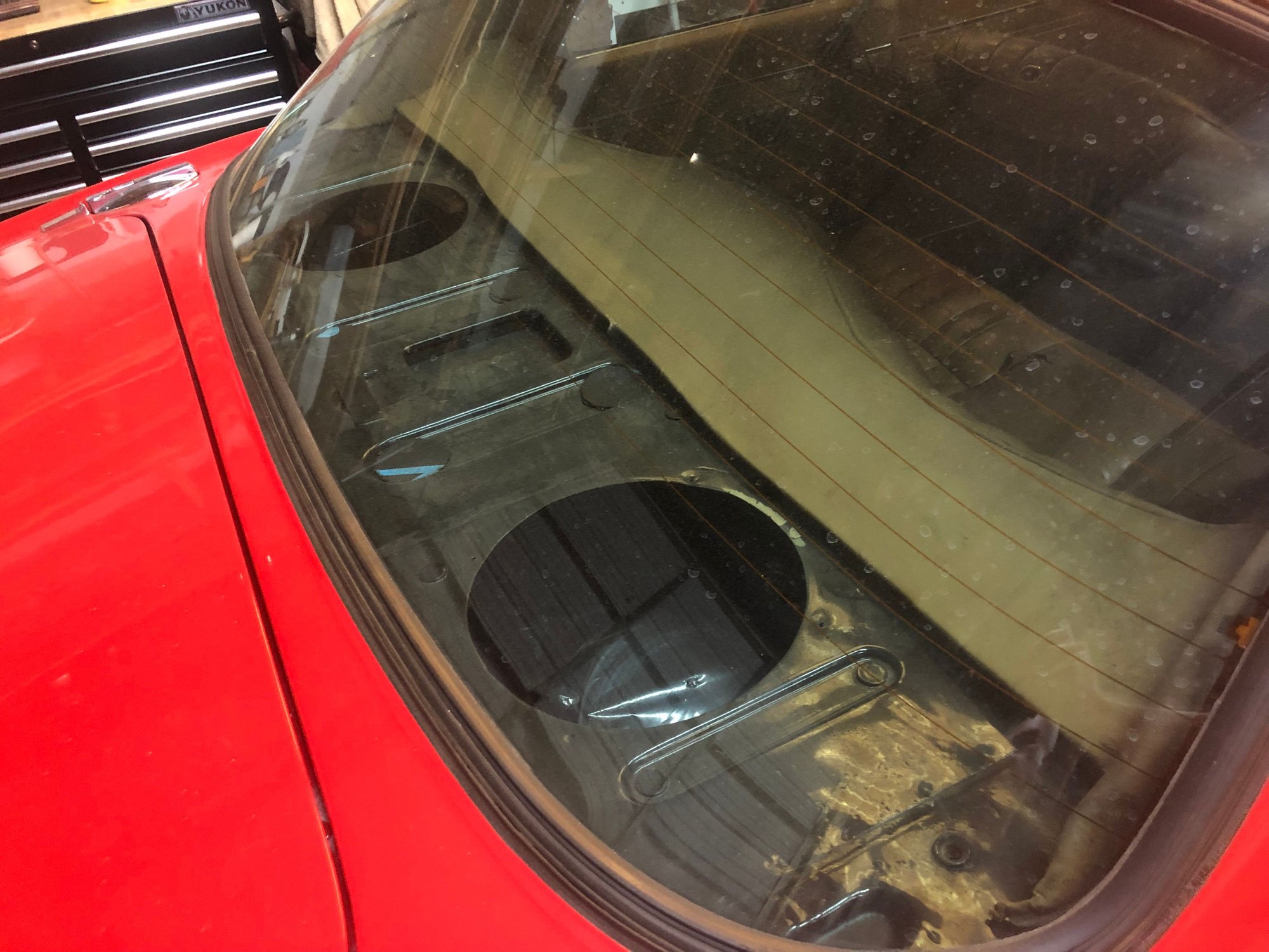

5-1/4" door speakers will fit with a little persuasion, the rear deck has perfect circular stampings for 10" woofers, free for the taking. I used a small pneumatic sawsall $20 HF nowdays, to zip a circle out from underneath (safety glasses!!). High qts, high efficiency, low fs woofer is great back there, no need for a damn intrusive sub box.

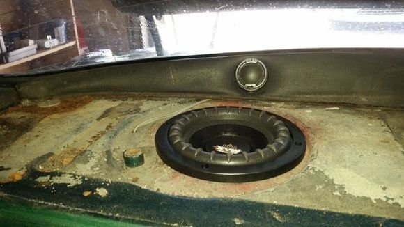

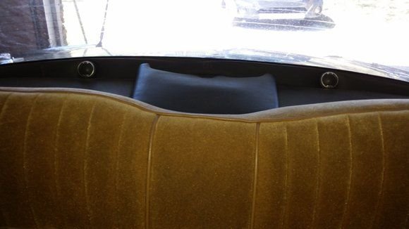

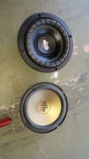

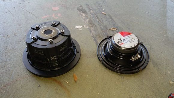

Okay I found some of my pictures, you can see the areas have a circular indent perfect for speaker placement, I went with 6 inch,
This was what I did originally
Had to go back in and replace them with something a bit more able
Installed
Installed
Used a crossover. And placed tweeters on rail
View In rear view mirror

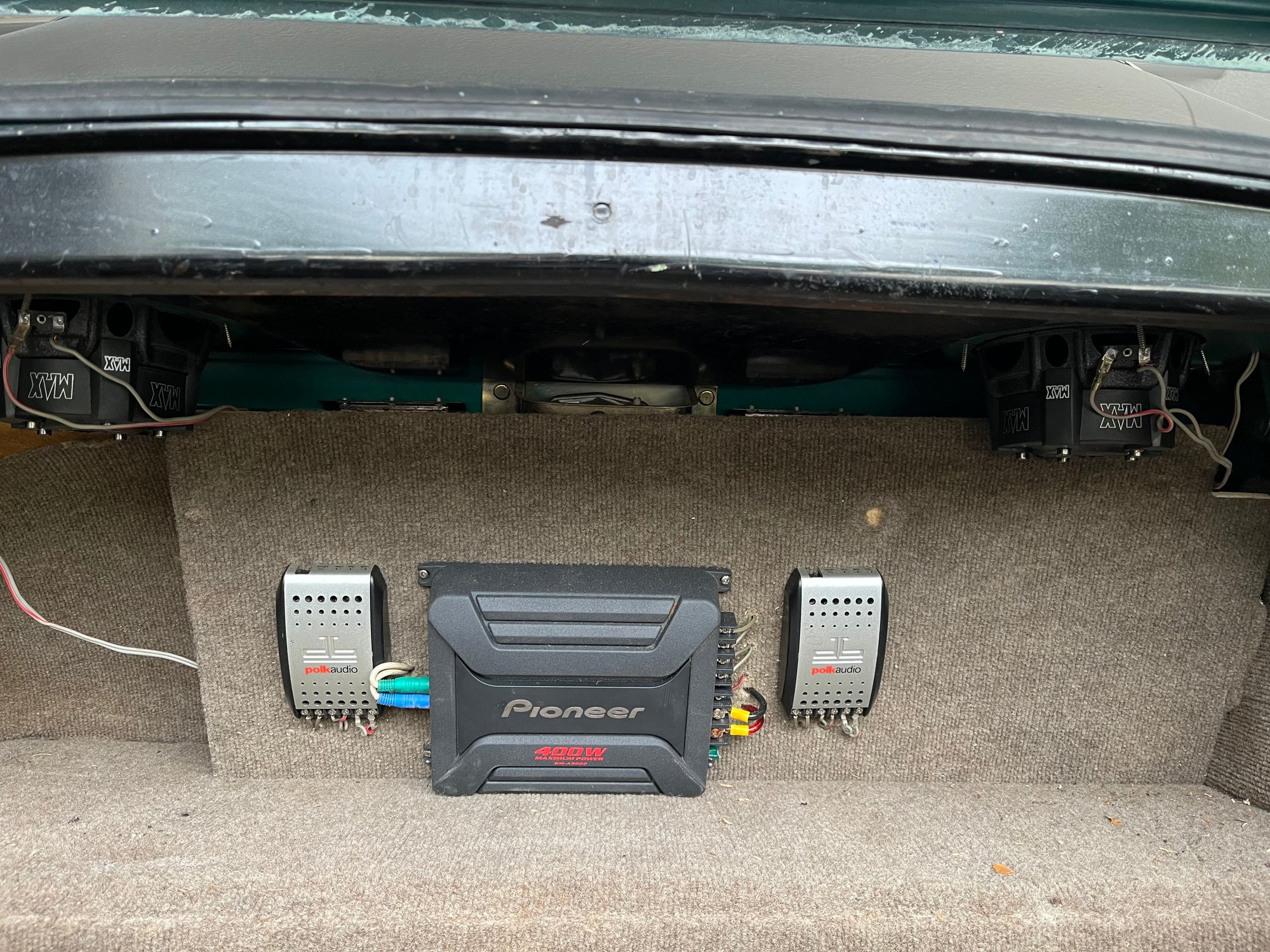

And here’s the view inside the trunk

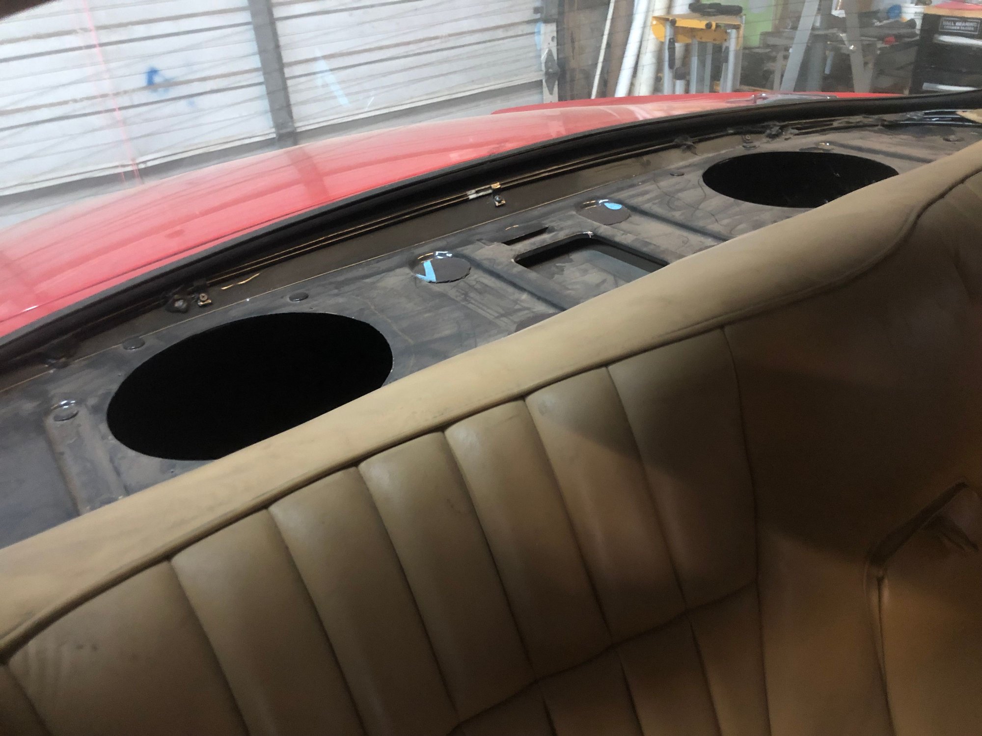

Pics of my rear shelf with 10” cutouts. Disclaimer… this was done in 1985 and I owned a car stereo shop at the time 😅. But I’d prob still do it today.

How much work is need to get 5-1/4 into the doors? I'm not one to play my music loud or need a lot of bass, I'm mostly looking for good quality over loud and bass so wondering if it's worth my time to go bigger on the doors if I'm going to put some 6x9" 3ways in the back shelf.

Is there a limit on the depth of the speaker I can put iin the back shelf? Is it a tight fit or space to play with?

Plenty depth open to the trunk. May have to massage the carpeting underneath a little depending how deep you want to go.
