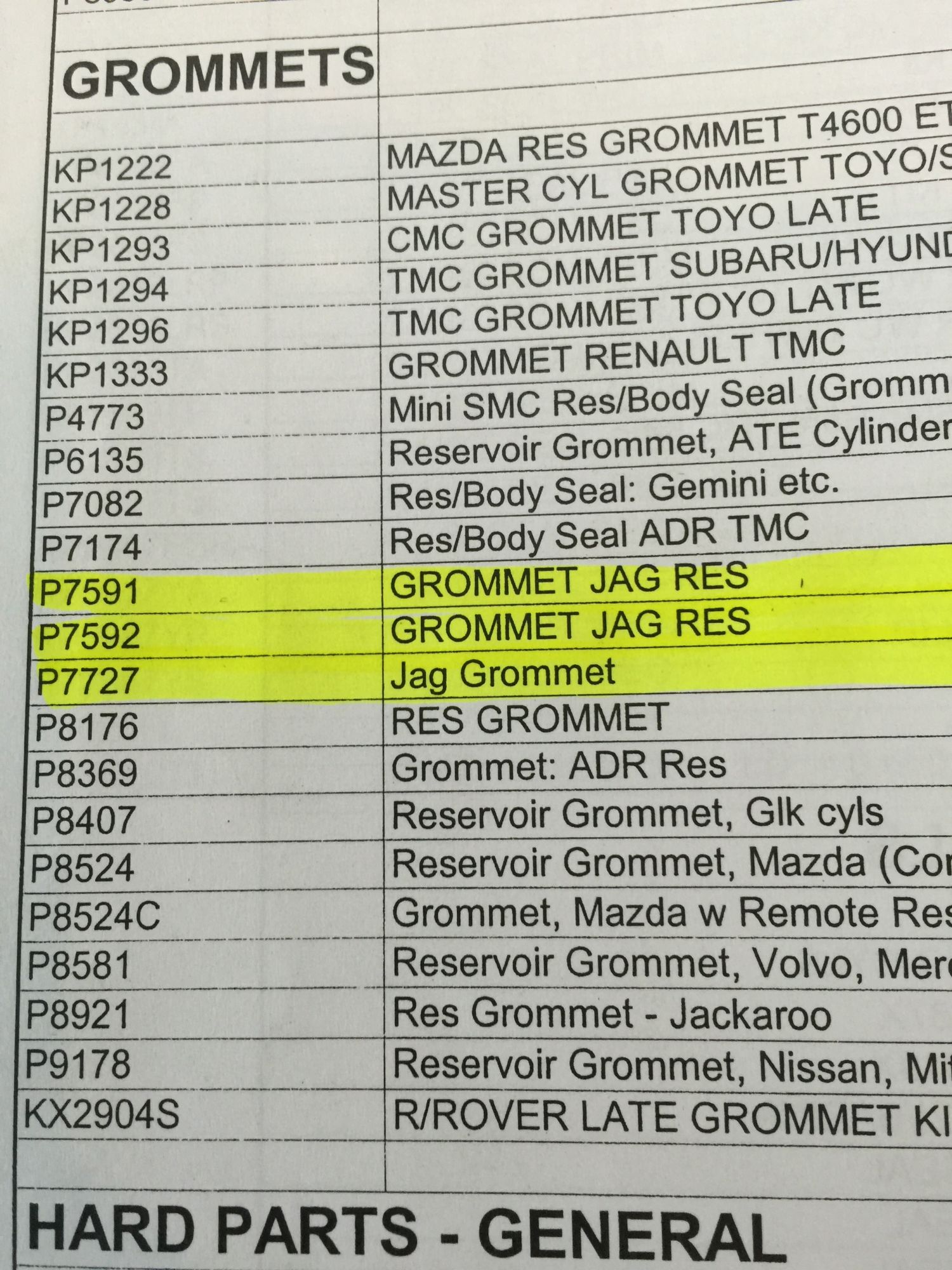

I used the S3 MC and it's top mounted reservoir for ease of buying future parts... I have never changed a Jaguar brake booster yet so I have no advice of what fits...
But, as the other post said, the MC and reservoir and the top cap will fit - mine hit the hood brace barely and I cut off a small piece with my Dremel. If it hits the hood, it will tilt the top mounted reservoir and leak brake fluid all over the fenderwell...been there done that!!!
BUT, unless the MC with the reservoir says it comes with the needed seal between the two parts - you will have to order a Repair Kit for a MC to get the two needed rubber seals.. Jag never sold them separately so the the suppliers do the same stupid thing.
Using a S3 MC you will have to get an adapter or reflare one line to match the metric fitting on the MC.... I did one car one way and the other by cutting off and obtaining a new flare fitting and doing the proper type flare.. either way works. You can barely see the silver adapter just to the left and right of the hood brace.. that is where I adapted the metric lines from a S3 from the junk yard.
