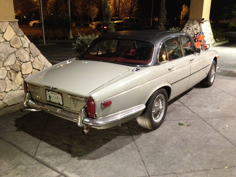

Well, I purchased my first Jaguar two days ago, and Im in the process of fully sorting it out, and getting it home. My wife and I have a bad habit of buying old cars on the other side of the country and driving them home, and perhaps this thread can document that. If it should be somewhere else, let me know, but I figured the Series XJ folks would be the most interested.
We took the Victoria Clipper ferry up to Victoria, BC to purchase the car, and drove it home that night. Here it is in the MV Coho ferry from Victoria, BC to Port Angeles, WA:
I still haven't made my mind up if the Dayton wire wheels will stay, or if I am going to put the original steelies back on. I'm leaning towards the steelies, but they Daytons sure are nice and smooth!
The car has obviously been well cared-for, but it needs some minor TLC to sort out various small things. To begin, I had to sort out why the headlights were not working. Same for the dash lights. The fuel selector switch is only half-there, and the system has been hard-wired to run off the RH side only. Lots of cleaning switches, dielectric grease, and the like. I think I have a list a mile long of minor things that need doing. Got the Map Light working, though:

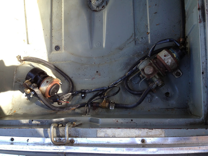

Default Third leg of the journey - Albany, OR to Petaluma, CA
Thank you for the kind words! The car is in good shape, and has indeed been well cared for.
All of the big stuff (body, driveline, etc) seems to be in good order, but I found a lot of the little things wanting:
  1. Headlights inoperative (loose +12V wire, now fixed.)
  2. Sidelights unpredictable (petrified dielectric grease in the switch, now fixed.)
  3. Fuel system hard-wired to RH tank and pump (I just sorted this out in the hotel parking lot this evening: half the switch was missing! Now I need to verify that the LH tank isn't full of garbage before using it...).
  4. Map light inoperative (bad bulb, now fixed.)
  5. Driver's Door switch inoperative (Interior lights don't come on with door open).
  6. Heated rear window switch not receiving power (Just noticed this evening)
  7. LH panel light for central gauges intermittent (Now fixed. Brass brush and bending contacts on the bulb resolved this one).
  8. Burned ground trace on the central gauge cluster (I did this myself, don't ask. Fixed it this morning.)
  9. The white switched circuit (the one that comes on with the key in the middle position) has been disconnected from the fuse panel and replaced with a wire run directly to the battery. It looks like that was likely done at the same time an old analog cell phone was installed? I plan to remedy this, as the turn signals, blower fans, and various other bits all work even with the key off.
  10. Heater fan only worked in Low setting (Cleaned switch. Now working).
  11. Windshield washer pump inoperative (I'll have to order one up).
  12. Dash lights inoperative (Wires disconnected from switch, now fixed.).
  13. Bad ground on LH outer headlight (Temporarily fixed with jumper wire).
  14. LH Inner headlight inoperative (banging on it resolved that one!).
  15. RH Inner headlight inoperative (Ground wire disconnected. Now fixed.).
  16. Turn signal switch is floppy, but generally works, even flash-to-pass.
  17. No vacuum line to distributor for vac advance (where does it connect?).
  18. Needs a battery tie-down installed (I think most of the pieces are in the trunk).
  19. Radio not fully functional (currently only working on the RR channel, and intermittently at that). The radio in there right now is a mid-'80s Radio-Shack special. I'd like to source a period correct deck to replace it. What would the factory original radio be?
  20. I have a "Cold" control knob (is this for A/C?), but after taking apart the console, it seems that it is just a dummy control that is not hooked up to anything.

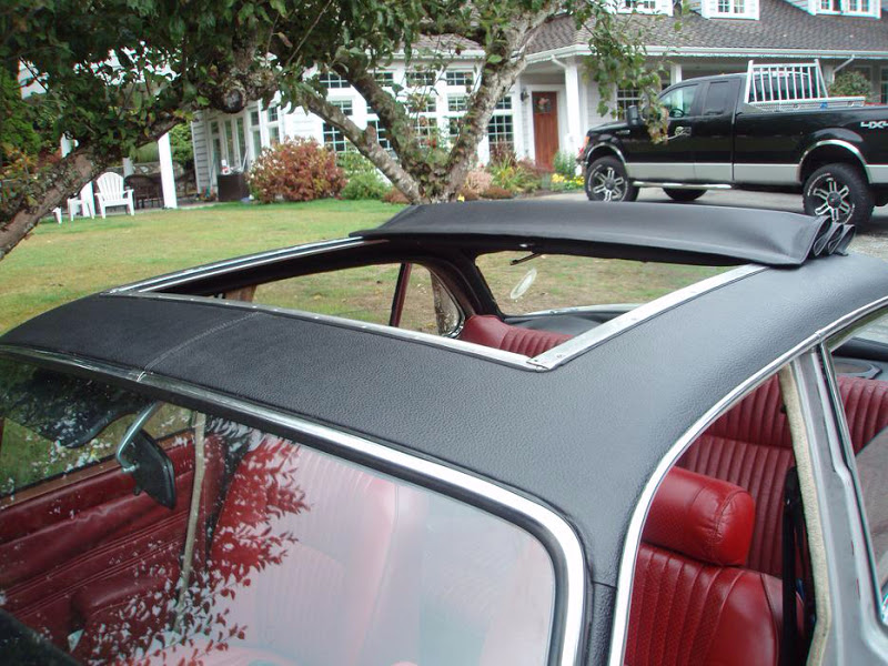

  21. Latch on the sunroof is loose. Hopefully it can be tightened back down.
  22. Vacuum switch on air intake disconnected (opens the flap to draw air from the exhaust manifold)
  23. Oil leak near filler. Could be valve cover or perhaps something else?
  24. The back of the gauge glass needs a good cleaning.
  25. The clock does not work.
  26. The speedometer reads about 25% too high (likely the angle drive).
  27. The radiator hoses could use a renewal.
  28. The kickdown mechanism for the transmission is inoperative. How does this normally work?
  29. A trillion other little things like that.
Also, what is the white item on the left here, and what should be connected to the bottom outlet (note the piece of deteriorated hose still sitting in the bracket to the right)?:

Last night I was able to restore the proper function of the fuel selector switch, the blower motor switch, and the Interior lighting switch. The wiper switch is still iffy, but there are so many wires attached that I didn't dare touch it without a bit more time available to me.
Now that I had a functional fuel selector switch, I found the fuel pumps (one Ecco, one SU), verified that the LH tank wasn't full of sludge, and ran the car for a while on the LH tank. I'm still surprised by the sheer amount of fuel on board when both tanks are full!
I was able to confirm that the tax disc in my paperwork folder does, indeed, match the UK plates I found in the trunk! Pretty neat, and makes me wonder if the car was originally picked up by the first owner in the UK. The car was made in June, though. Would it have sat for over a month before being picked up?
Now I need to consolidate a few lists of parts and services needed, plus find a time to come back out and start part 2.
Tom

IIRC, the transmission is a Ford? model12/FMX with a vacuum controlled kickdown module on the rear. Diaphragm may be ruptured, vacuum line disconnected. They are adjustable via a little screw inside the vacuum tube.
Warm up flap in air cleaner is, I think AC delco.
Oil filler cap has a large rubber O ring.
Speedo reading high could mean trans or diff have been changed.
Wheels are personal taste, I would keep them, as they seem in character with the car.

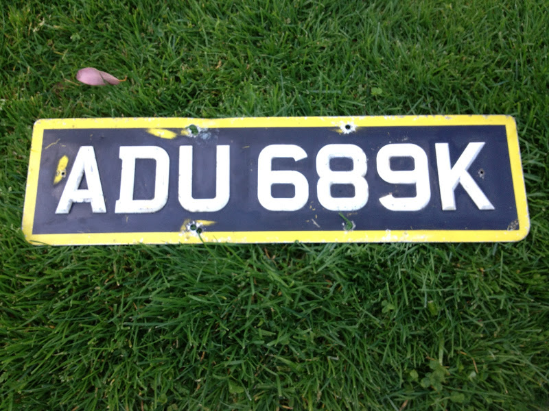

Originally Posted by trymes
....................... I was able to confirm that the tax disc in my paperwork folder does, indeed, match the UK plates I found in the trunk! Pretty neat, and makes me wonder if the car was originally picked up by the first owner in the UK. The car was made in June, though. Would it have sat for over a month before being picked up?
Tom,
You can tell a lot from a UK Tax Disc.
The UK Registration Number ADU 689K arrowed in orange indicates the car was registered in Coventry. Under the Vehicle Registration system in force at the time, Local Authorities each had a two-letter identifier. DU is the identifier for the city of Coventry. The final K is the Year identifier for 1971/72.
The number 1 arrowed in blue indicates it had one previous 'Registered Keeper'. UK vehicle registration documents always make clear the 'Keeper' is not necessarily the legal owner of the vehicle but is the person responsible for it. This previous keeper could have been the supplying dealer - a regular practice if it was being supplied in the UK to an overseas buyer.
The date 11 Aug 1971 arrowed in purple is the actual date the vehicle was taxed and COVENTRY in the date stamp shows it was taxed in Coventry.
The £ NIL circled in green shows the vehicle was exempt from Road Tax, now know as VED (Vehicle Excise Duty).
UK vehicle export regulations in 1971 allowed a vehicle to be registered with zero Road Tax payable and used on the road provided it was exported with twelve months. It was a regular thing for overseas owners to have a car ready for collection in the UK, drive it around here or on the Continent for a few weeks or months and then have it shipped home.

Graham: Thanks for the information on the tax disc. It's not conclusive, but perhaps the car was indeed made in June, sent out to have the Weathershields roof fitted, and then collected by the buyer in August. That or perhaps someone bought this disc and the plates at some point after-the-fact and just liked that they were the same place/time as when the car was made. Who knows?

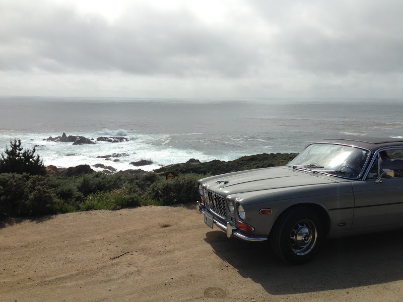

Well, we're back in the saddle again! I picked the car up on Friday and spent Two days straightening out small items and preparing for the next leg of the trip. Installing 7" headlights took the most effort and time, counter-intuitively. The headlamp trimpieces still don't fit properly, and I cannot figure out why...
I was also able to install the freshly rebuilt vacuum-advance distributor from my MGC, which made a big difference. If you haven't had your distributor rebuilt and recurved by Jeff at Advanced Distributors should really give him a call.
I also gave the carburetors a little balance, and found two missing screws on the temperature compensators, plus that the remaining two screws (one on each) were loose. I replaced a number of broken rivets in the sunroof, including a number in the latch mechanism that were causing lots of rattles. A new washer pump & reservoir, some adjustment of the accelerator calbe to restore the kickdown function, plus a small amount of time chasing vacuum leaks behind the dash, and we were ready to go.
Yesterday saw us leave the San Francisco area and head south to Big Sur, where we traveled south on Highway 1, surely one of the most amazing routes in the country. We got a late start and pulled up somewhat early, stopping in Cambria, near the Hearst Castle. The car performed very well, other than an annoying rattle that crept into the sunroof about 15 minutes prior to the end of the day.
