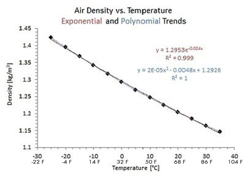

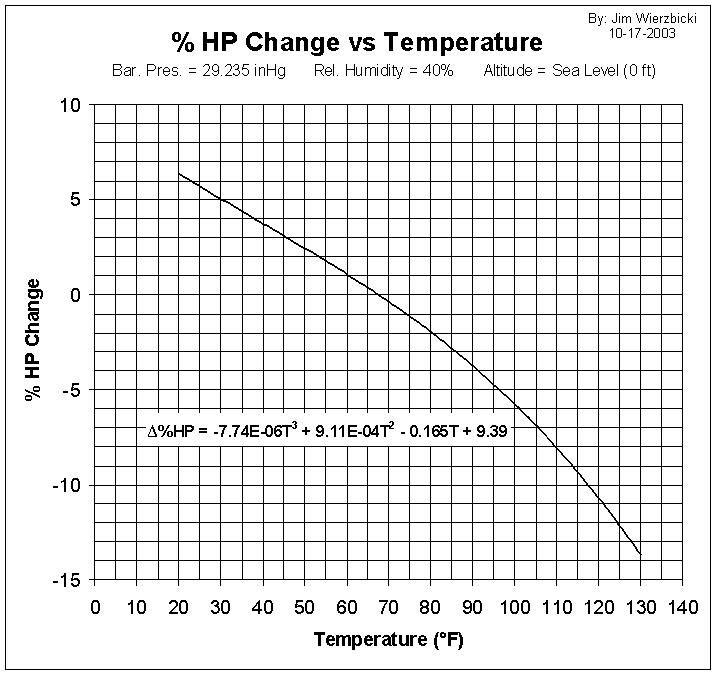

Remember, it takes an 11*F drop in intake temp to realize a 1% gain in power. Most drivers don't notice a 5% change in power.
That figure seems off a bit. More fodder for discussion...
HP-vs-Temp --http://www.easyperformance.com/support/technology-papers/cai-system-design-consideration-primer
air_density_vs_temperature
