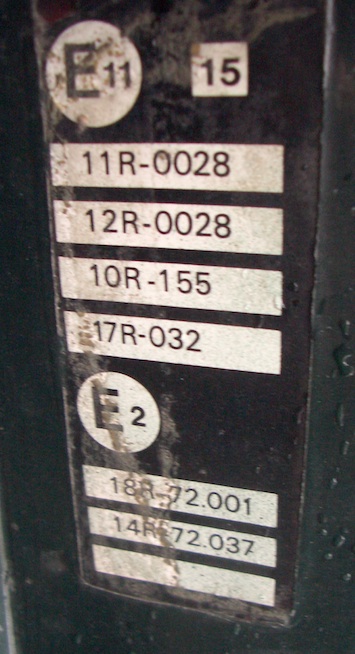

Hello Catpeople,
My cat is resprayed by a previous owner...the decal with all codes(colour, interior trim, check codes etc.) behind the drivers door at the A pillar is no further readable...nice white from the thinner.....
Where to buy a reproduction decal with all codes ?

This is a "modern" european decal with the check codes and the E-classification codes
a bit old fashioned in black/silver exist for the "older" XJ -Series 1 and 2 with
paint codes, trim code, VIN, shorthand symbol code for specification, classification of engine, etc.....

Unless there is enforced regulation that such labels be kept intact and fully legible I can't imagine much consumer demand for them....and therfore little chance of finding a vendor who offers them.
I suspect you'll have to find a graphics company who will make one up for you.....for a price.
