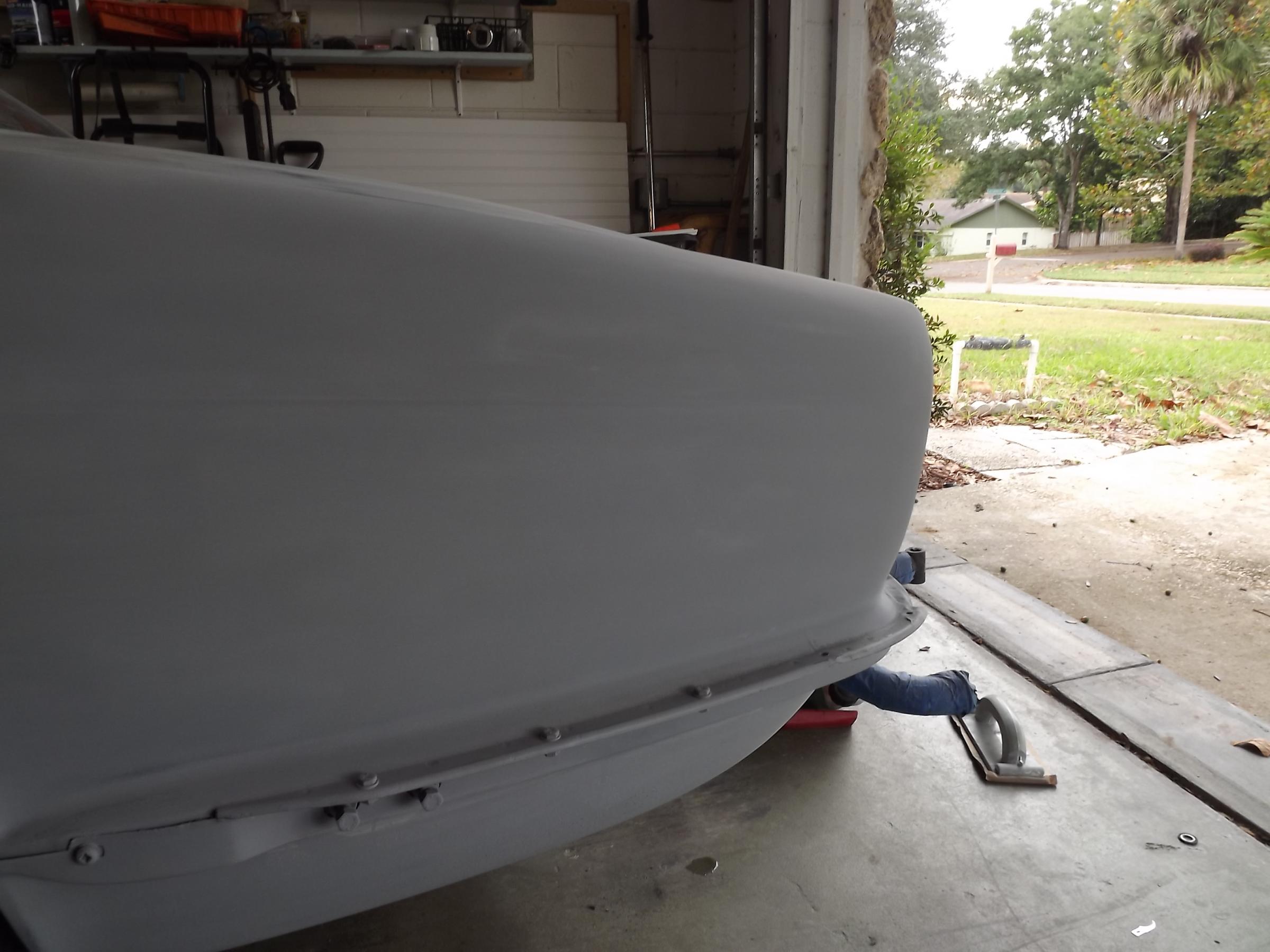

i dont weld anymore, my eyes cant do it! but i soooo wanted to delete teh side markers, so i figured before she gets trailered off to paint i would give it a go and if i screw it up paint shop would just fix it!
i ground back side of holes to bare metal and epoxied a metal plate on back side I then took small hammer and a piece of wood and made area a wee bit con-caved so i could build up filler!
its all fiberglass now, no reg bondo! build it up in about 6 layers! then flatted it back then primed, then sanded then spot puttied then sanded, then primed, then sanded! took about 2 hours on each hole! but i love the finished look! will be even better once shes back in her lovely green dress!!

That's a good approach if you're not an experienced welder but welding is the only way to properly do this.
The inexperienced will over heat that area. Since there is a body line right there it will warp and distort badly. Ask me how I know.
You could simplify the procedure and just glass the back. Glassing a 6 inch patch on the back side and body filling the front would suffice for a while.
Any non welded repair will eventually ring and crack because of the different expansion rates of the sub-straits.
