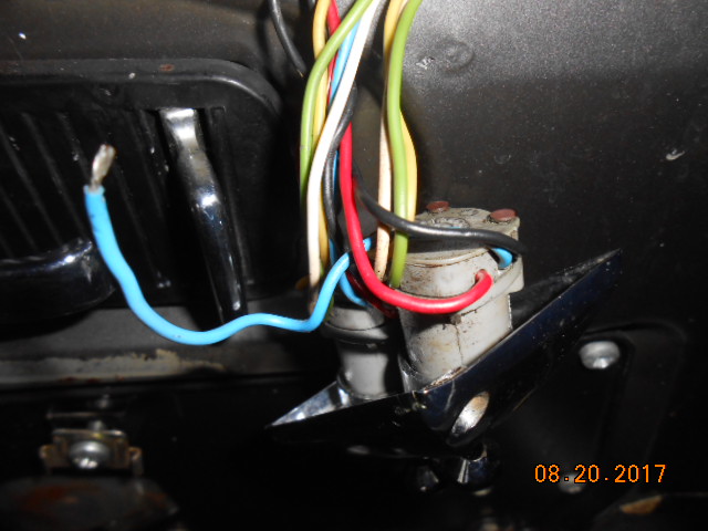

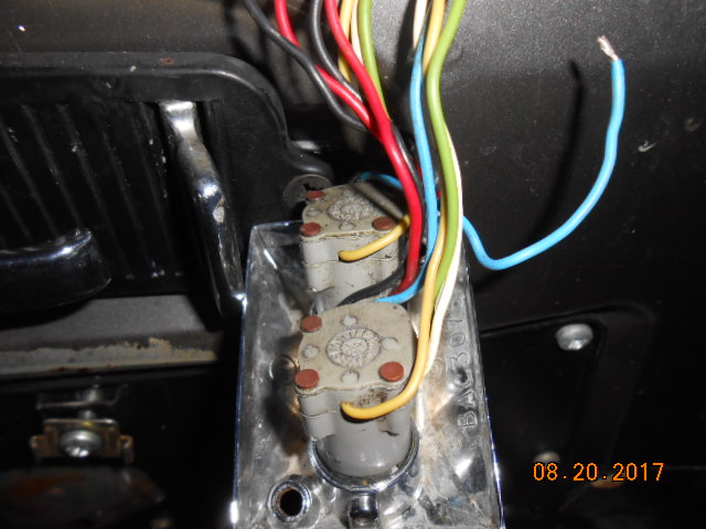

Hello all,
My passenger side door mirror stopped working today. I have the door upholstery off the car and left the mirror joysticks hanging. It was working when I reinstalled them yesterday.
On examination, I noticed a blue wire disconnected from the switch. The blue wire is still connected to the passenger mirror joystick, but no signs of where it came out from or goes. Can anyone help with a picture of their mirror switch wires? Thanks in advance for any help or solutions
Attached are 2 pics showing the disconnected wire.

Tease a bit more wiring out of the door until the multi-pin connector is exposed. I'm betting you'll find an empty slot in the connector and that'll be the answer to your question.

I finally found the S57 wiring guide and even though I haven't looked at the car yet, It looks as if Doug is correct. Based on the schematics, the disconnected blue wire goes to connector CP7 which is located in the driver side door and connected through the connector to a Purple/Blue/Slate wire which then goes through another connector to the passenger side door.
Thank you Doug for your quick response.
