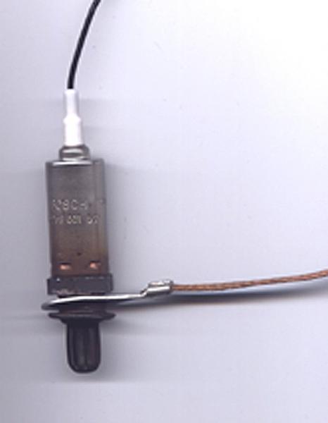

is your Oxygen Sensor the one wire only type? if yes, take a thick copper wire, wrap it around the O2 sensor metal body with one side of the wire, (with a cold engine of course, the O2 sensor gets extremely hot), and attach the other side to a good clean chassis bolt, to see if idling or anything else changes. It is an old tip from the early 1990's when I bought my XJ-6, that adding a ground strap to the 1-wire O2 sensors improved idling stability and overall computer response because as these cars age, the exhaust manifold-to-engine-block Ground is reduced by grease and carbon, so adding a ground strap to the O2 sensor itself improves overall system response.
I manufactured a ground strap for mine and it caused the idling to become more stable, even improving starting to the point where my car starts from a single turn of the ignition switch. Please note I really do not care to argue the point one way or another because for some this is "snake oil", (they've never done it to their cars either but they inmediately conclude in the negative); I still remember this tip that was used back in 1990 when I bought my XJ. Here's pictures of the ground strap I manufactured for the O2 sensor, The ring connector is placed between the sensor's body and its crush washer, similar to a spark plug's crush washer, so the ring connector flattens neatly when you tighten the sensor to the exhaust manifold, no leaks.
Attached Thumbnails Engine cutting when in gear &lt; 1500 RPM-xj-02-sensor-ground-strap-1.jpg   Engine cutting when in gear &lt; 1500 RPM-xj-02-sensor-ground-strap-2.jpg

Okay- when the car is back from the body guy, I'll check the ground.

And, speaking as an EE -- your ground strip makes sense to me if corrosion is an issue (though I suppose 'breaking the sensor loose and re-seating it after a good clean' should also work -- the strap would provide an additional grounding source and perhaps make this maintenance less required).
exactly, if you look at 1986 O2 sensors, they started to include an additional wire, a ground wire!! curious, ehh? in my car, adding the ground strap did the job, and it has been there for around 15 years now.

As to the O2 sensors, I suspect the exhaust system is not a good ground, therefore the strap made by Jose would insure a good ground if sttached to a well grounded location. The chassis ground and/or the engine block would do just fine. The exhause has a donut or olive and is hung in fiber or rubberm leaving only rusty bolts as a ground path!!

I connected the opposite end of the ground strap to one of the lower bolts at the Cruise control bracket, out of the way to avoid any tangling or accident.
