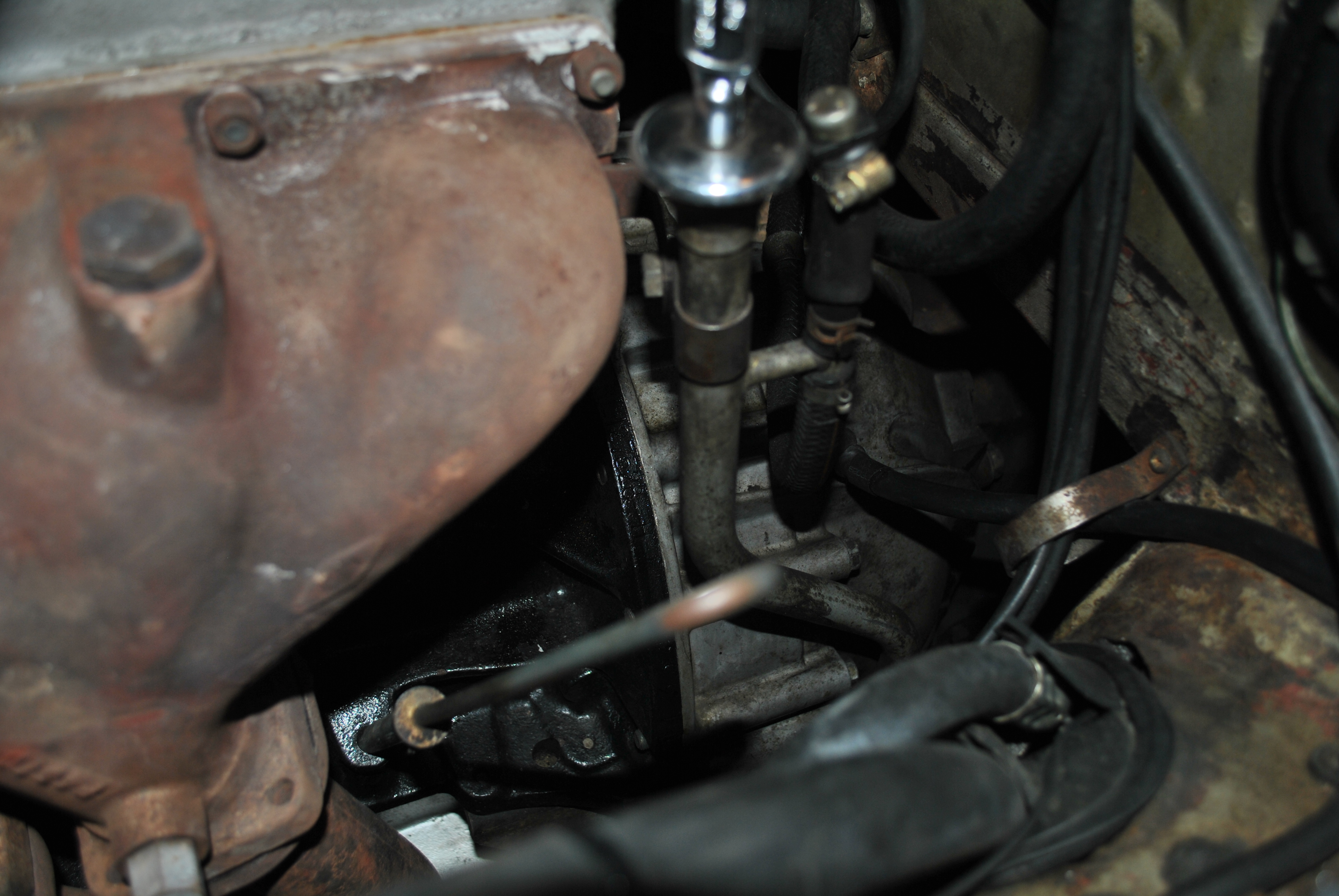

Where do I find the engine serial number??

The engine number is on the left side of the engine where the bell housing bolts on, if you look down past the transmission dipstick you will see it. In the 4th photo where my extendable magnet is pointing.

That's what I thought. There seems to be two numbers there though

The 8L number is the engine number
