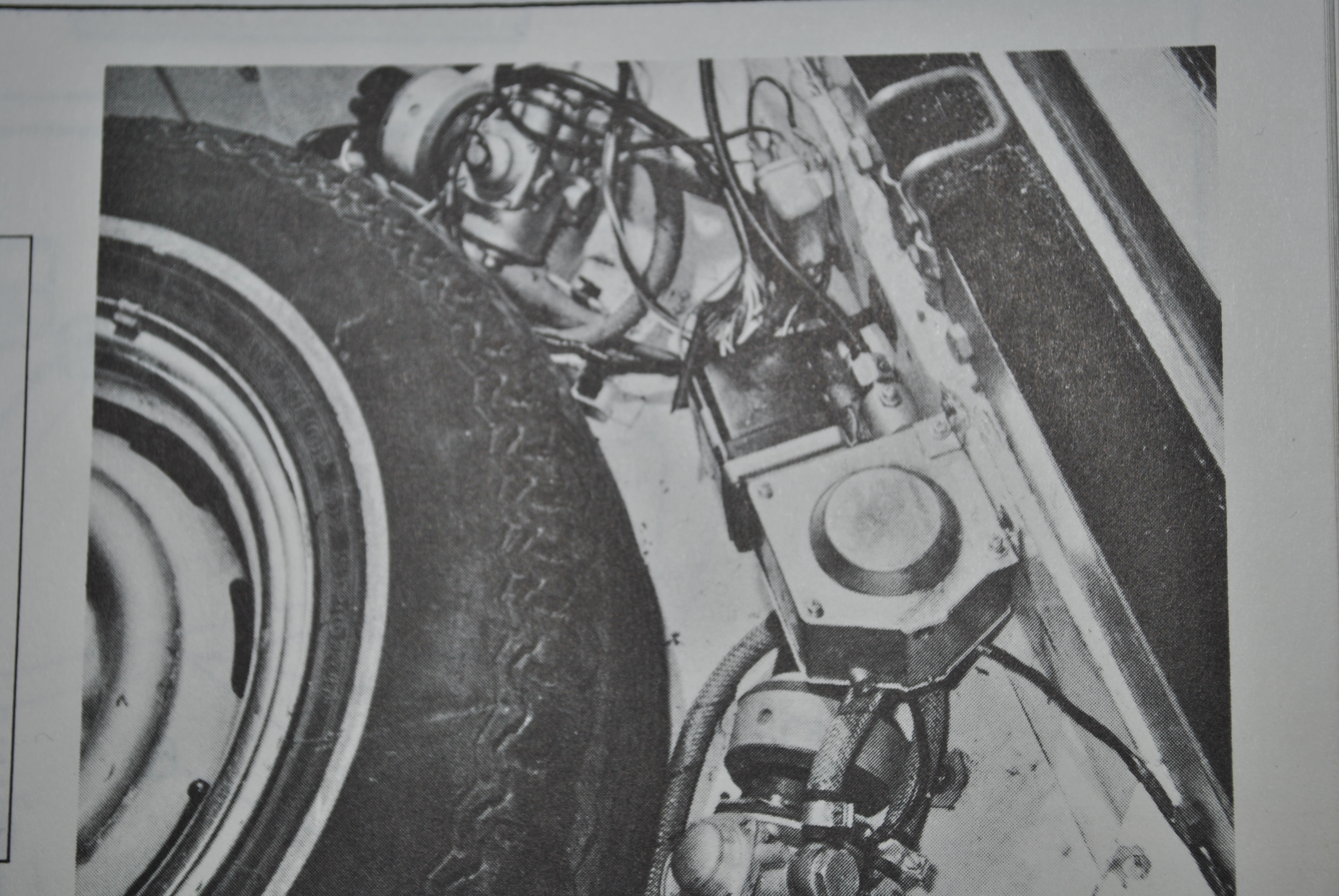

Does anyone know if the Series 1 has a fuel pump relay? None of Series 1 manuals mention one or show it in wiring diagrams. Series 2 diagrams for fuel injected models show one.
I found this pic showing one in the boot with the pumps, but I assume it's a series 2 since there isn't one in my boot.

Posts: 26,779
Likes: 10,318
Clarke, my car (series 2) has pumps in the tanks.
Not used of course, as the 350 has its own fuel pump, but the wiring and plumbing give them away.

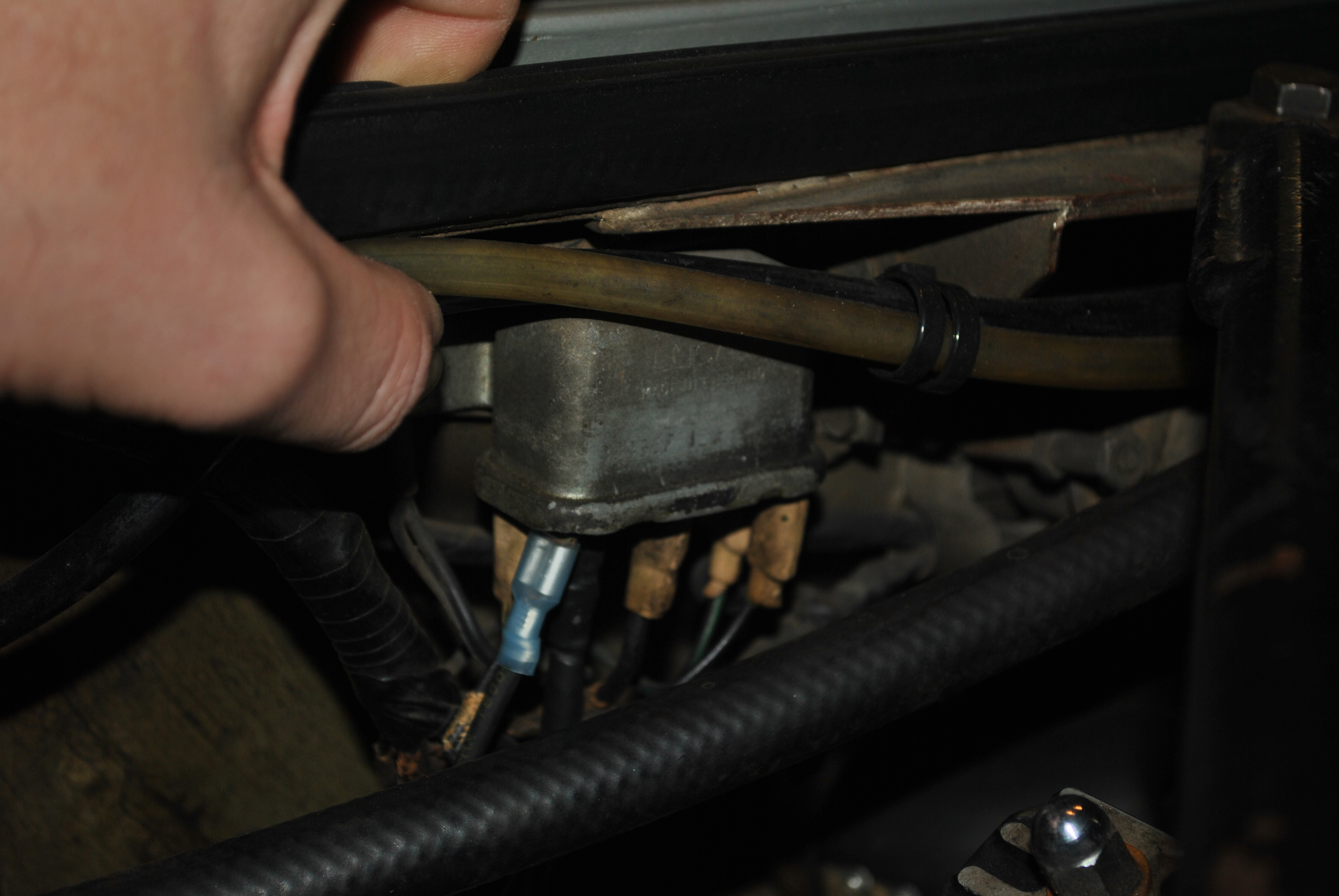

Clarke,
The S2 6 cylinder carby cars had the fuel pump relay on the firewall top lip panel just to the right of the centre bolt for the cross braces.
Maybe the S1 is like the MK10 and the older S 3.4, no relay, just power direct from the ignition via the tank change over switch.

Grant, the wiring diagram shows a direct feed from the change over switch.
Jim, thanks for the pic. The only relay I have on the firewall is the starter relay.
Well that pretty much rules out an obvious fuelling issue, both pumps are pumping about the same amount of fuel into a jar. I have used the car a few times since and all good.
I will just have to wait and see if it happens again.
