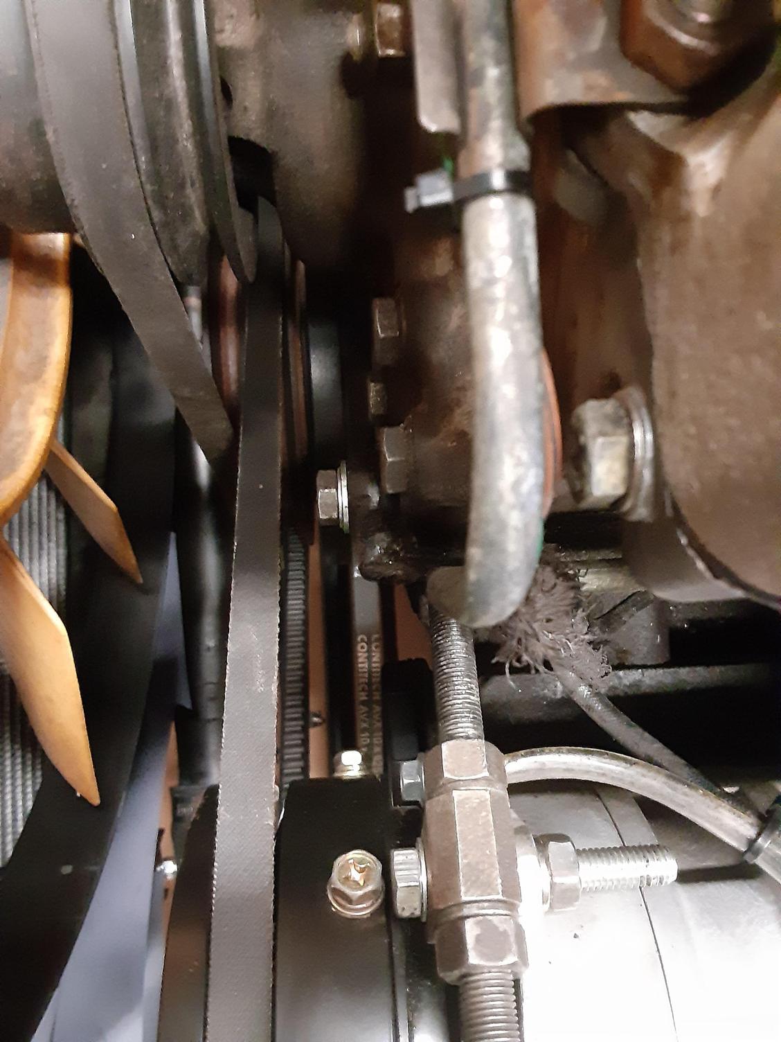

So Retroren, This is my setup. My model has no bracket like yours. My adjusting rod bolts directly to the block. If you look closely, you will see the "Jog" where it bolts to the block. Ian

Ian, thanks for the photos and explanation. Very clever and straightforward solution for avoiding the studded compressor clutch. Your method keeps the geometry correct whereas mine works but the pulley alignment is not spot on like yours. Well at least we have given fellow members a couple of options. Thenks, ren

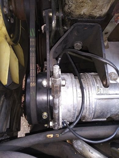

Came up with a similar solution to Ian's and don't have any alignment issues.
Initial set up. I later removed the u-shaped part of the bracket as it was unnecessary.
The jury is still out as to whether the Al A6 compressor is really any better than the original cast iron units.
