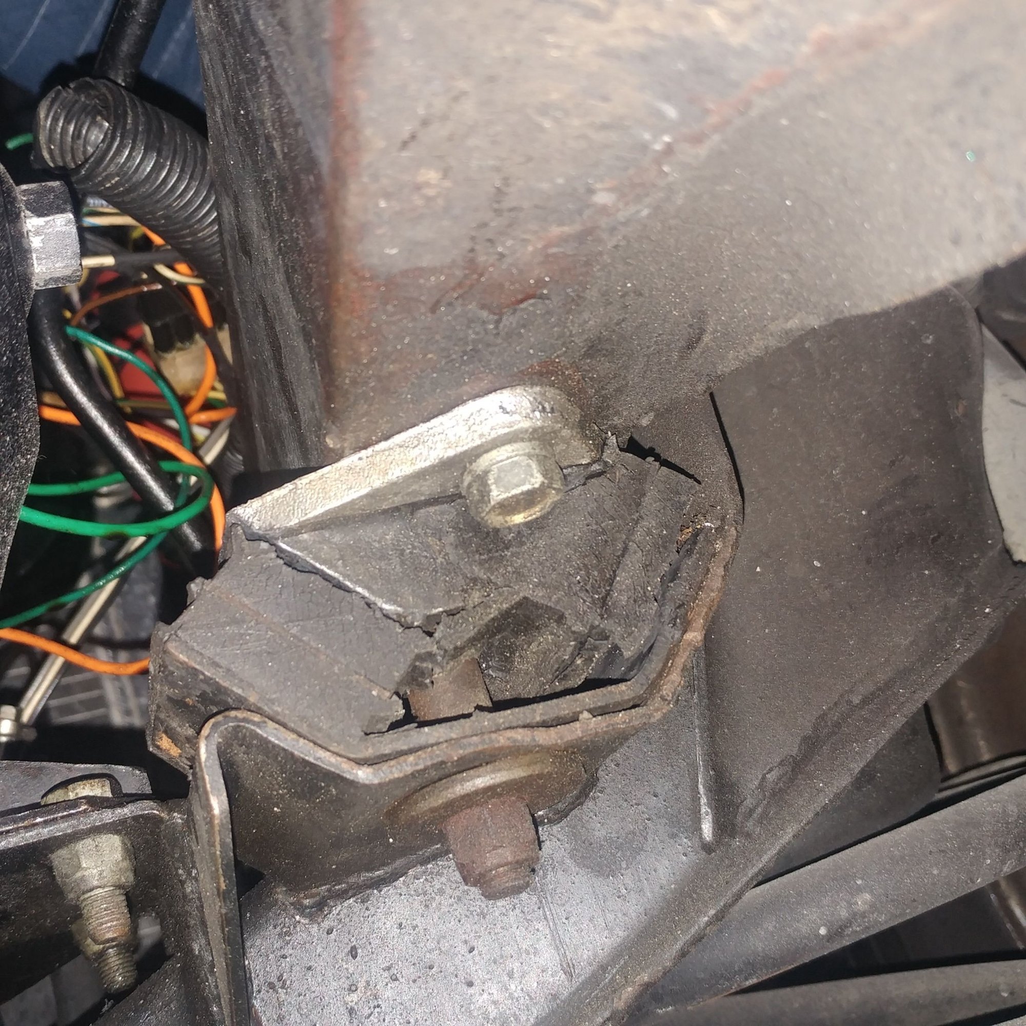

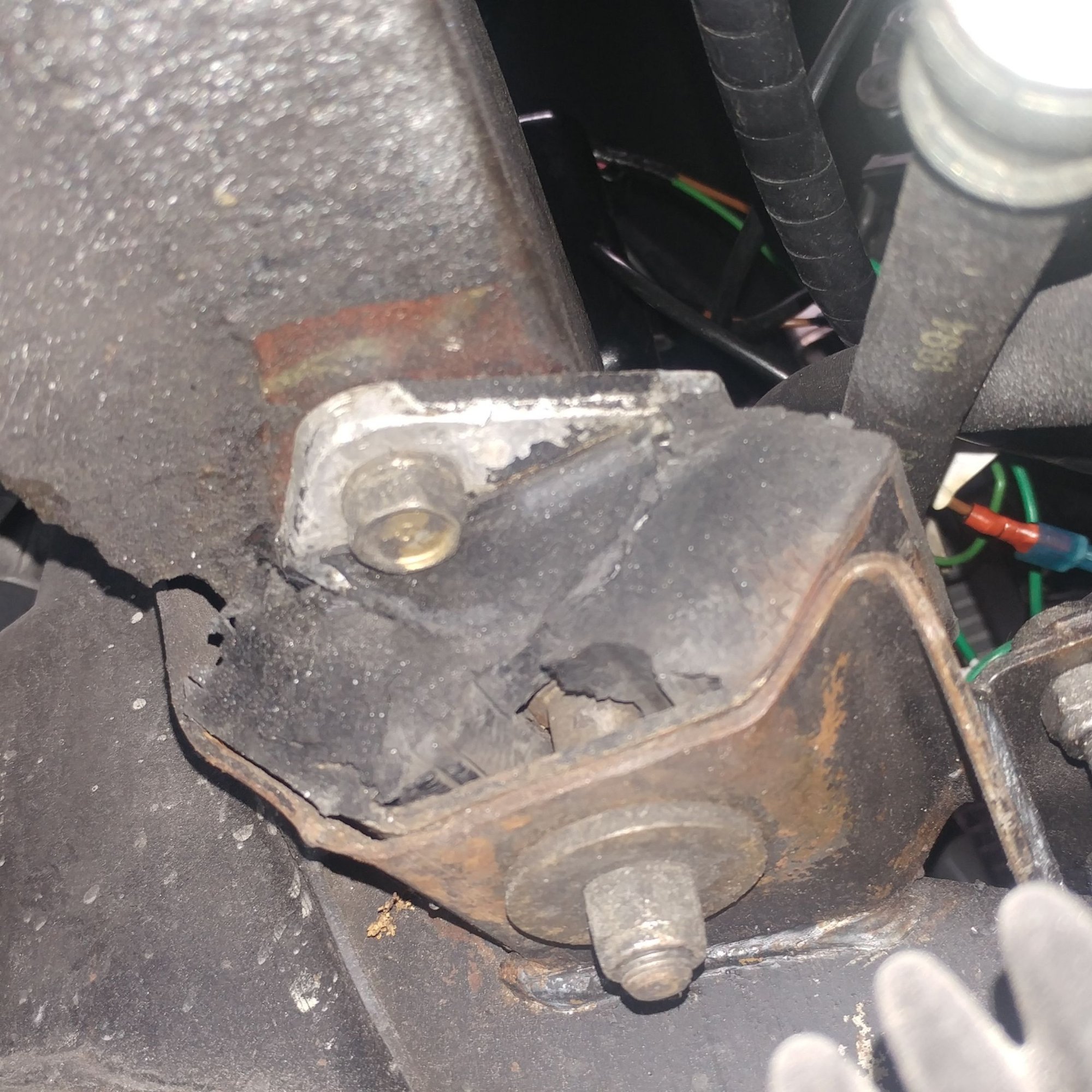

Not sure I'm calling them correctly (front suspension mounts). But here are a couple of pics of mine. These pics were taken while car was on jackstands. They are obviously well deteriorated. I have a spare pair of new ones. How easy are they to change? What do I risk not changing them right away? What symptoms might they be creating?

OOPS.
Front cradle V Mounts.
VERY common, Mongrel job if a V12, not so bad with 1/2 an engine.
GENUINE Metalstik ONLY here. All the aftermarket have failed withing weeks. I get from SNG in the UK, Simon is the man.
C45666 which is now MNC2360AA

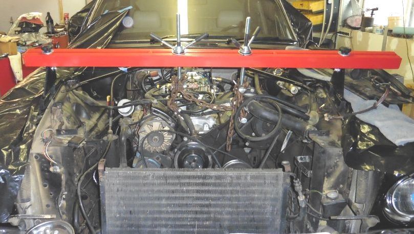

As you have to suspend the engine off the cross member to do this, I Highly recommend a Harbor Fright engine support bar:
This Marvelous invention mounts on the hood rails, is almost Infinitely adjustable, has a capacity of around 1000 pounds. Here it is supporting the entire engine while the front suspension was over on the bench getting refurbished and the rest of the car is up on jack stands.
It may not be on the display floor at your local HF store, I had to specifically ask for one which they dragged out of the back somewhere. But then, our local stores are a bit limited in showroom space.
Mine was $75-80. YMMV

What kinds of problems is this creating?

You already have the problem now you need to fix it.
You Must get the weight of the car off the cross member. That means you need to jack up the car as you have done,
support the engine with the support bar (almost a clone of the one illustrated in the Blue Book; ROM),
put a trolley jack under the cross member to support it so you can loosen the bolts to those bushings,
lower the cross member slowly and gradually, just enough to remove and replace said bushings.
Then reverse this procedure for reassembly.
This will not take you a mere 15 minutes but there's nothing hard magical about it, only a bit of tedium.
If I've forgotten a step (been about 5 years since I did this) I'm sure someone will jump in to fill in the blanks.
I wish you success.
Old Aug 6, 2019 | 08:16 PM
Posts: 26,779
Likes: 10,318
Lack of front end stability at least.
IF these V-bushings don't have a through-bolt (like Chevy motor mounts of the same era), it's possible the whole cross member could part ways with the rest of the car under certain circumstances, such as lofting the car over a RR crossing or what we used to call a WHEE hill, and you could be left with Zero control as brake lines could be broken leaving you with NO stopping function and of course no steering.
Of course, this is Worst Case Scenario.

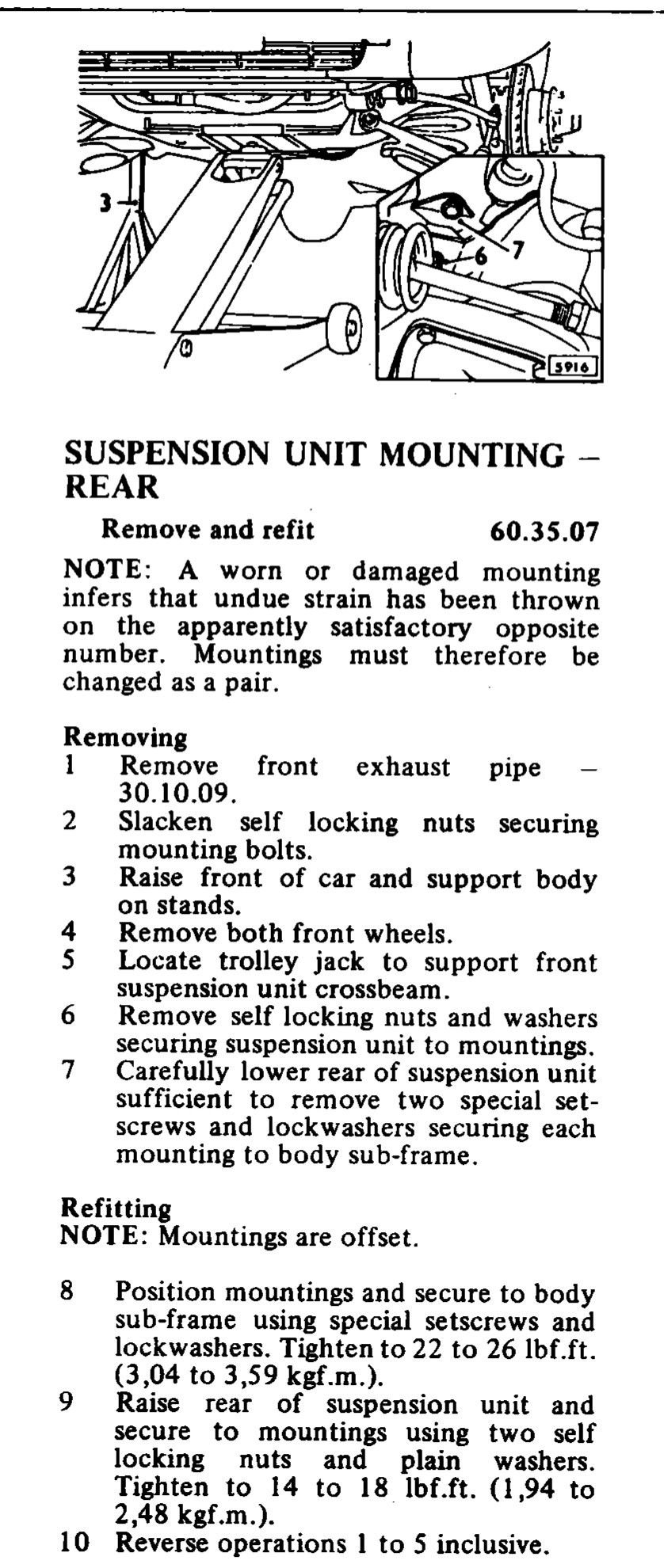

I just read the Service Manual under SUSPENSION UNIT MOUNTING - REAR 60.35.07 and it says nothing about having to support the engine in that writeup. So... people who have done that job before (replacing the two rear mounts), is it necessary for me to support engine. I'm smart enough to know the manual is not always correct. LnrB - did you support engine to do some other job at the same time?
Old Aug 7, 2019 | 09:29 AM
Posts: 26,779
Likes: 10,318
Yes, actually, the cross member was over on the bench getting a complete refurbishment, leaving nothing to support the engine.
For sure if you follow the directions you have here you will soon find out if I was wrong.
As I mentioned it's 5 years since I did this.
